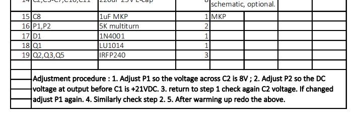

mid position is probably position inducing least thinking aboout
P2 maxed - least Aleph CCS modulation - acting more like pure CCS
P2 minimized, highest Aleph CCS modulation
you can do without distortion measurements , that involving precise counting of turns , listening and writing impressions ........ in incremental steps
btw. P2 is having nothing with DC settings - one end of it being AC coupled to rest of the world

Thanks ZM, all good info.
Yes, p2 is cap separated, no affect on dc. I had wrong instructions.
If you can affect the sound of an amp this much with just one trimmer/pot, it could be useful to have few settings marked, and instead of multiturn use normal pot, stick it on the front and allow the listener to select.
From dark and soft to bright and sparkly. And all in between.

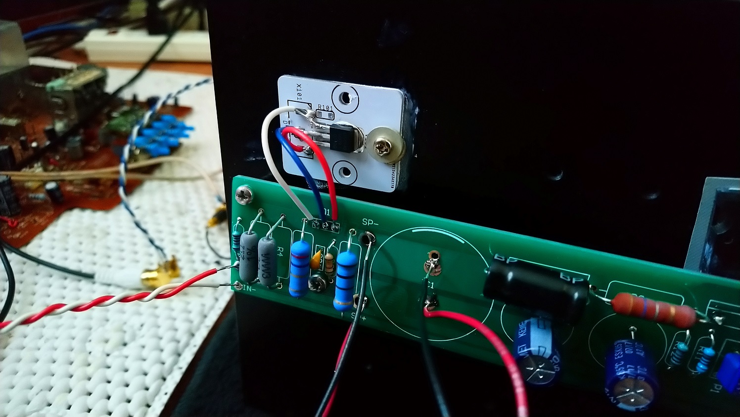

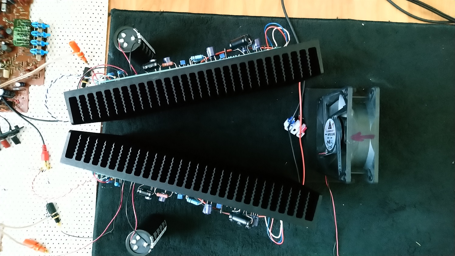

standard keratherm from diystore
torque unknown
I am considering changing just q2 for mica
aaah, I did not measure heatsink temp, but it was just warm to touch, not hot
other question, what do people prefer, monoblocks, or single chassis
I can make two separate power supplies, that way diode bridges do not get too hot
how about switching power supplies? anyone tried?
torque unknown
