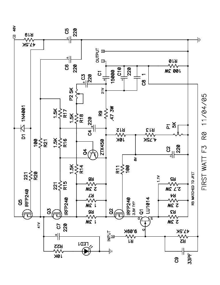

Hi Everyone,
I've returned to some projects that I never finished properly. This includes an F3, which I got working, but wanted to rebuild since the heatsinks were insufficient. (And because I ruined a Lovoltech fiddling with it.) I used Nelson's schematic (attached) without any changes, except the rail voltage is a little higher, at about 49-50V. (I haven't checked at full load since rebuilding). The PSU was discussed in an old thread here,
https://www.diyaudio.com/community/threads/clc-power-supply-for-f3-in-apple-computer-case.365009/
although that is probably not very relevant except for the higher output voltage. The Lovoltechs are matched and on xrk's adaptor boards (the jfets are from Nelson, through the related thread - Many thanks!) and I'm fiddling with the value of R5 and the setting of P1. I understand from this thread and others on the site that the 1.1V and 3.5V on the jfet are critical. (This makes sense to me, since you'd want the jfet to operate at the right bias point, as in the Zv9 article.) I also understand that the 21V on the +ve side of the output caps is important.
My question is why the particular value 21V? Is it because it's about half the 41V shown after the cap multiplier? If so, then with a slightly higher rail voltage I should probably be looking for something nearer 23V, right?
Thanks for any input!

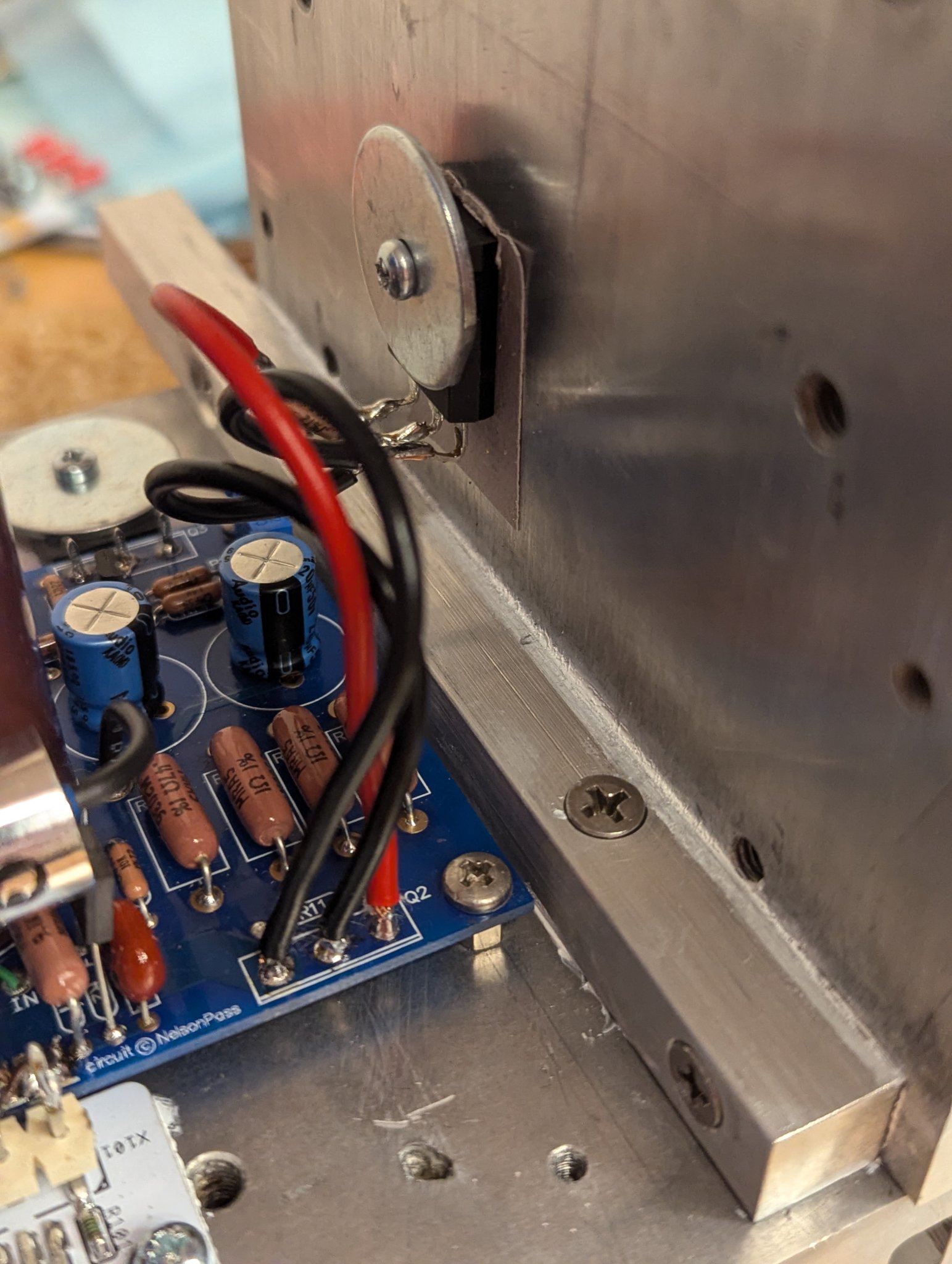

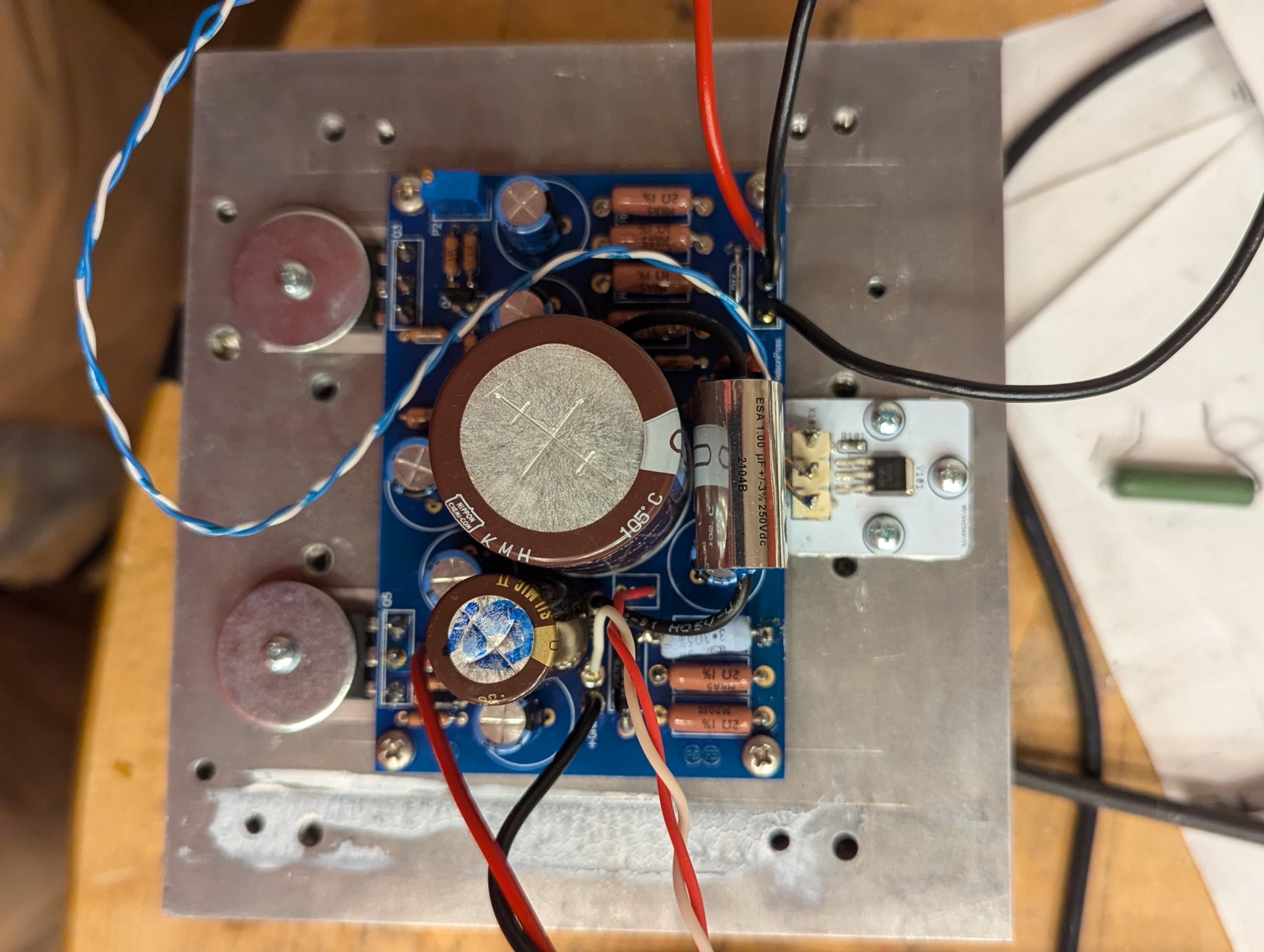

A few hours fiddling around and I'm pretty sure I can get the voltages where they should be, although I still need to finalize things.
However I've spotted a problem. The chassis I've bolted together should be plenty big enough to dissipate the heat, but I'm using boards from Peter Daniels that are a tight fit, and all the mosfets and the Lovoltech are very near either the top or the bottom. Not ideal, but it isn't a problem according to my hand and infrared thermometer, except for Q2, which is in an unfortunate position and is too hot for my comfort. (I haven't tried anything terribly accurate to measure temp.)
I can solve this (I think) by moving the mosfet off the board and using flying leads. These would be 2 to 3 inches long if I put Q2 where I have in mind. I imagine moving R11 (the gate stopper) is a good idea - I can just solder it directly to the mosfet leg. Are there any other issues I haven't thought of?

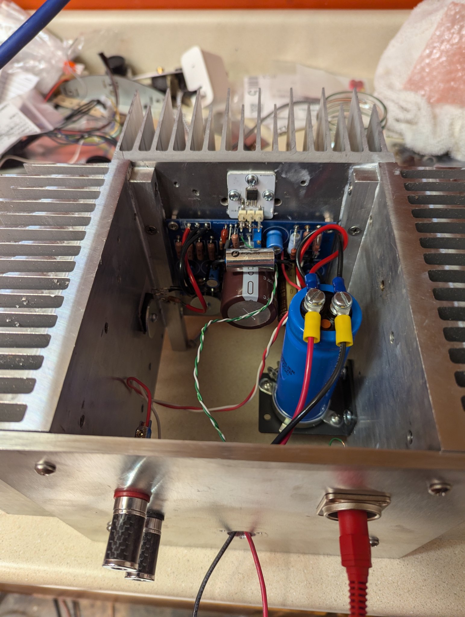

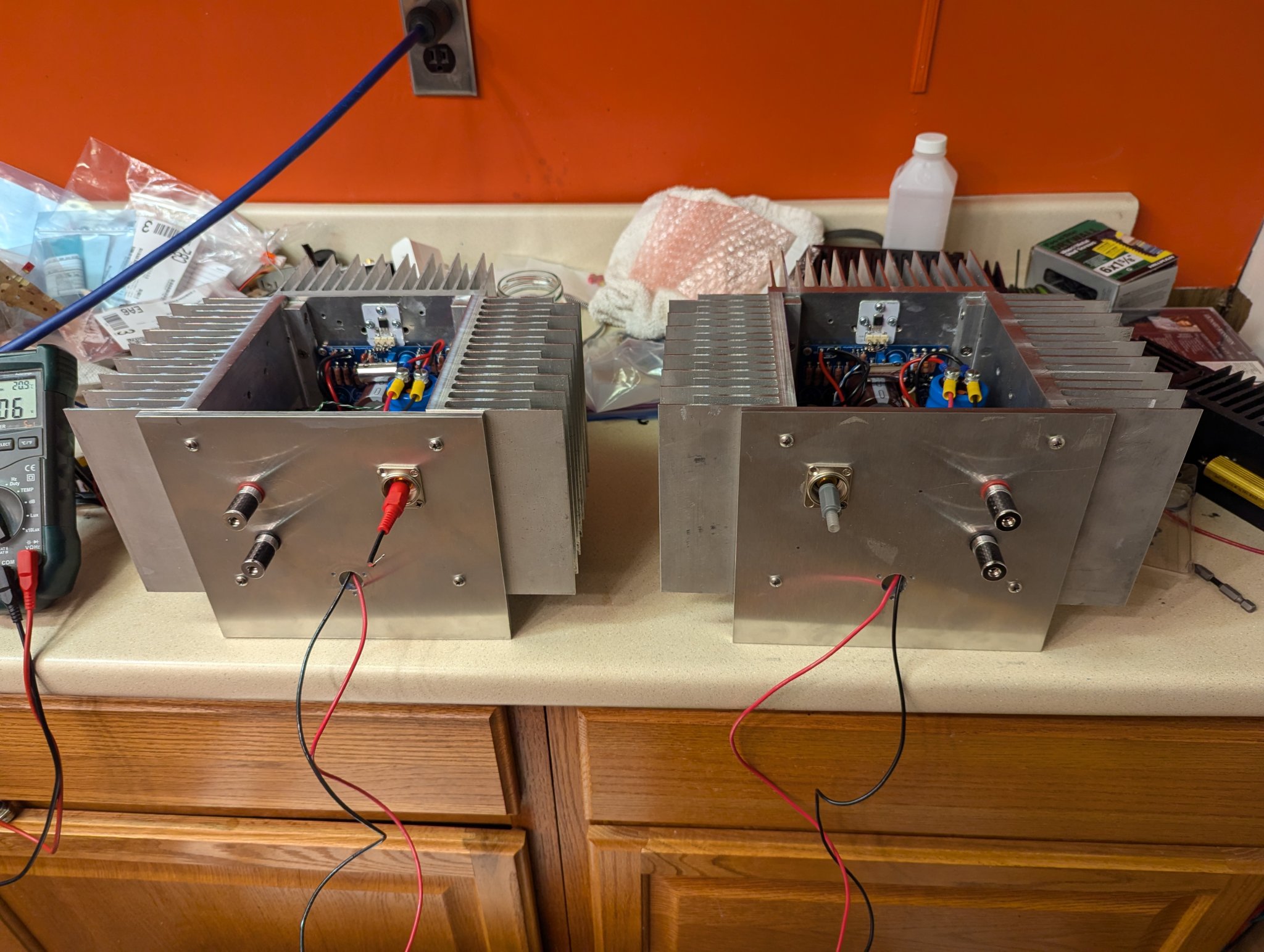

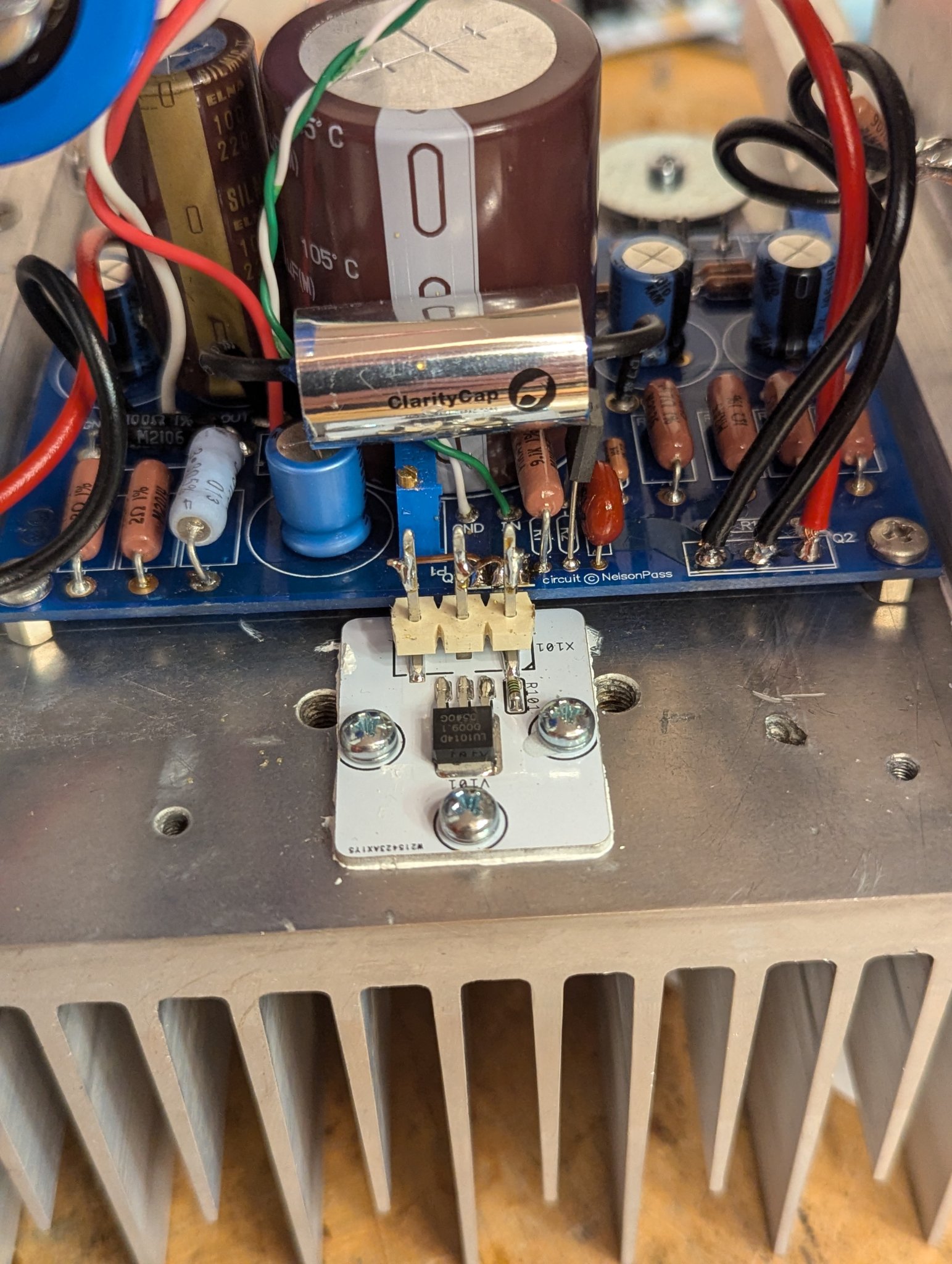

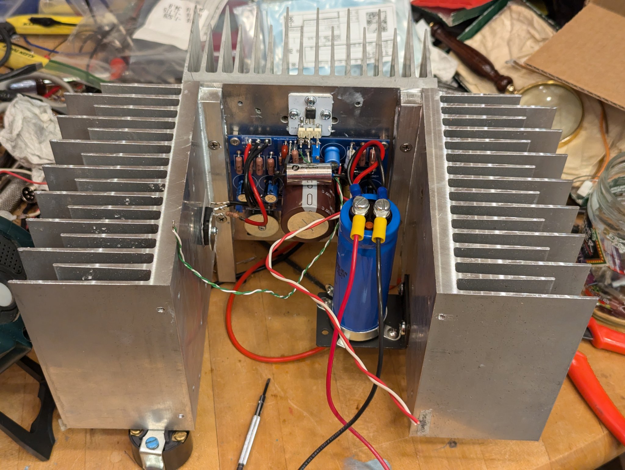

How about some pictures even though not done yet? Here's some pics of work in progress.
The amp has an external PSU, feeding separate L and R units. (I hesitate to call them monoblocks when the PSU is external. Seems wrong, somehow...) PSU is CLC, plenty of filtration, and has been discussed elsewhere. I had previously tried these boards with different heatsinks which turned out to be inadequate, hence the redesign. The heatsinks were cheap from ebay; three of them that turned out to have the fins running the "wrong way". (I didn't look carefully enough. Not the vendor's fault at all.) So I cut them in half and milled the ends to give me three shorter ones per channel. Hence the design.

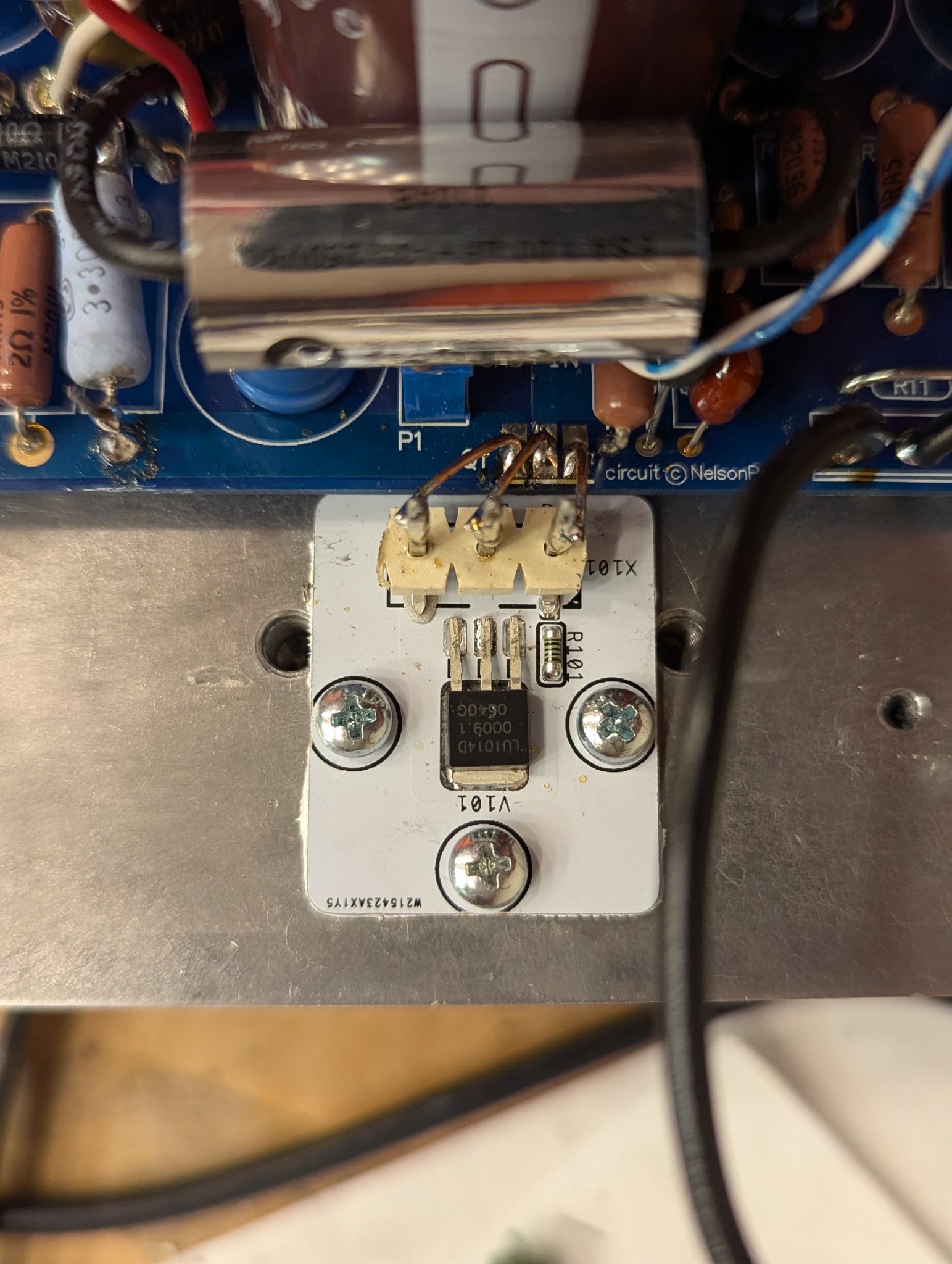

The little white board for the Lovoltech came from member xrk971 s group buy a while ago. Very nice. The boards were expecting the legs from the jfet with their normal spacing, though, so little wires were needed. If I hadn't already soldered the larger pins on the board I might have done things a little differently. There's a little gate stopper on the board.
The first and second pictures shows the rear of one channel, without back panel while I'm fiddling around. You can see Q2 has been moved from the top left of the board to the left "wall" as discussed above. It's really much, much happier there. So far temps seem to be very modest, to my relief.
I've most of the way to having the right voltages. I'll post again when there's something prettier to look at, or something goes wrong again...

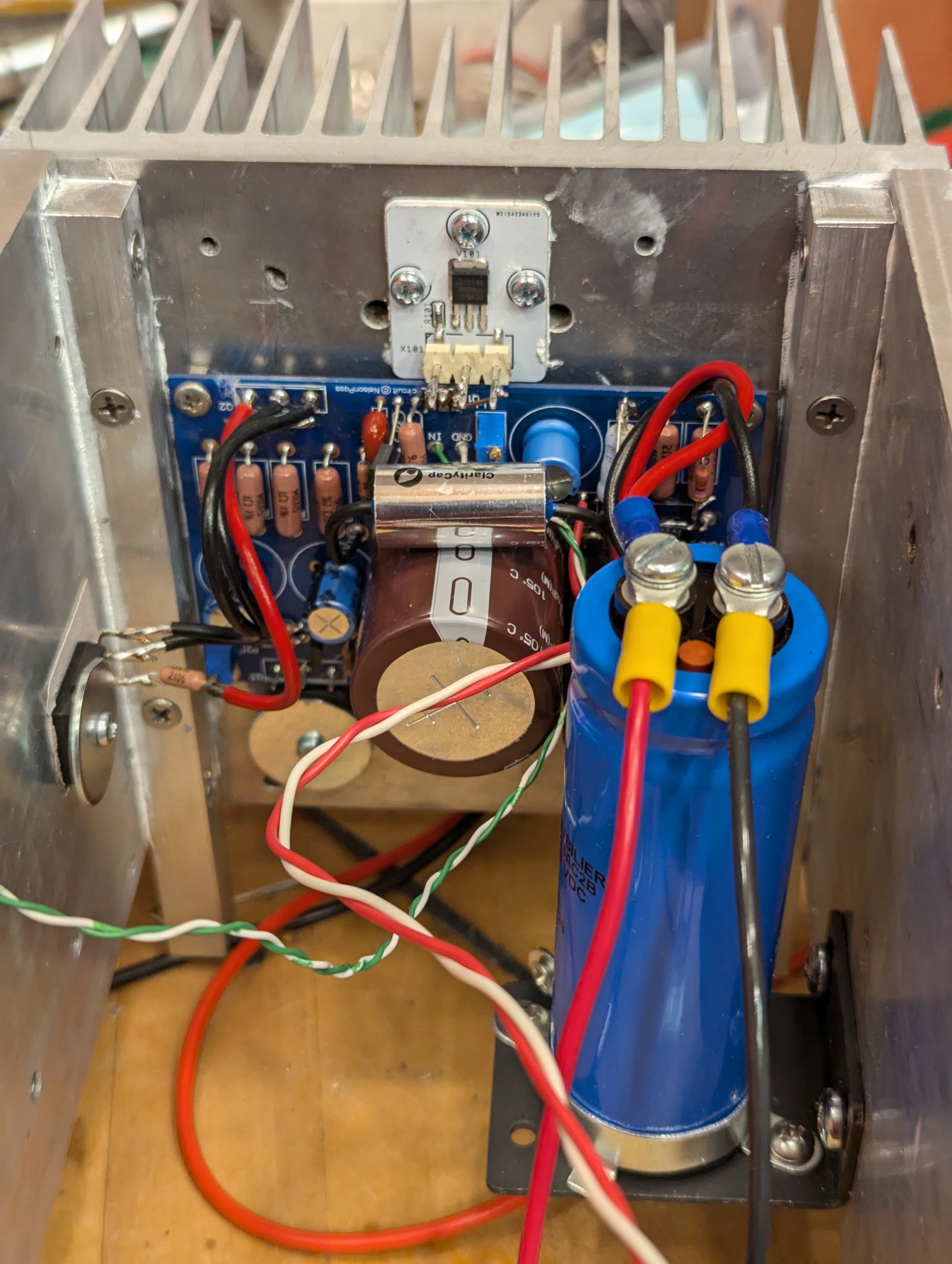

I think I'm done fiddling around with tweaks, at least for the present, . Rail voltage under full load is a little lower than I expected, but after the cap multiplier I have 43 - 43.5V on both channels. On one channel I measure 21.43V just before the output caps, 1.137 on the source of the jfet and 3.587 on the drain, giving Vds of 2.45V. On the other channel I measure 21.41 on the output caps, 1.129 on the source and 3.554 on the drain, so a Vds of 2.425V. I have little to no confidence in the third decimal place of these measurements, BTW; my DMM is pretty good, but I could really use a second one for a double check, and in any event the last digit bounces around a bit even while measuring.
I've also found that it takes a long time for these voltages to stabilise - around an hour to an hour and a half - has anyone else seen that? Is something, maybe the Lovoltech, sensitive to temp? (That's about how long it takes for the heatsinks to reach stable temperature. Which downstairs in my little basement workshop is perfectly OK. Hottest thing I can find is the screw and washer holding Q2, and I can easily keep my finger on that indefinitely. It may be warmer up in the real world - we'll see.
Unless anyone has a good reason to continue tweaking these voltages I'm going to see what it sounds like, and live with it a bit. I can always adjust R5 again if I think it needs it, and if it looks like a keeper I'll pretty up the chassis a bit. And put in the connector for the DC voltage, which the sharper-eyed among you may have noticed is missing...

Yes, agreed that 3rd digit is nonsense. I understand about temperature equilibrium being the point, too, but does 60-90 minutes sound like a reasonable amount of time for stability? I remember my F5 taking about that long for the DC offset on the output to stabilize, but in this case the voltages on the drains move over 1/2 a volt over 15 -20 minutes, from above 4V in both channels and take a long time to get to their stable values. Not really a problem, I guess, unless I'm not seeing something.
What do you think - do the voltages otherwise look close enough?
Listening to it now and so far it sounds good.
