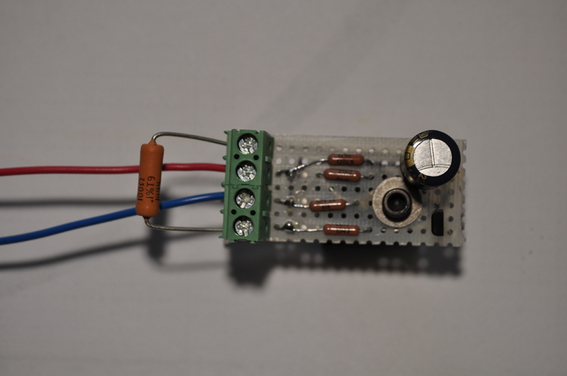

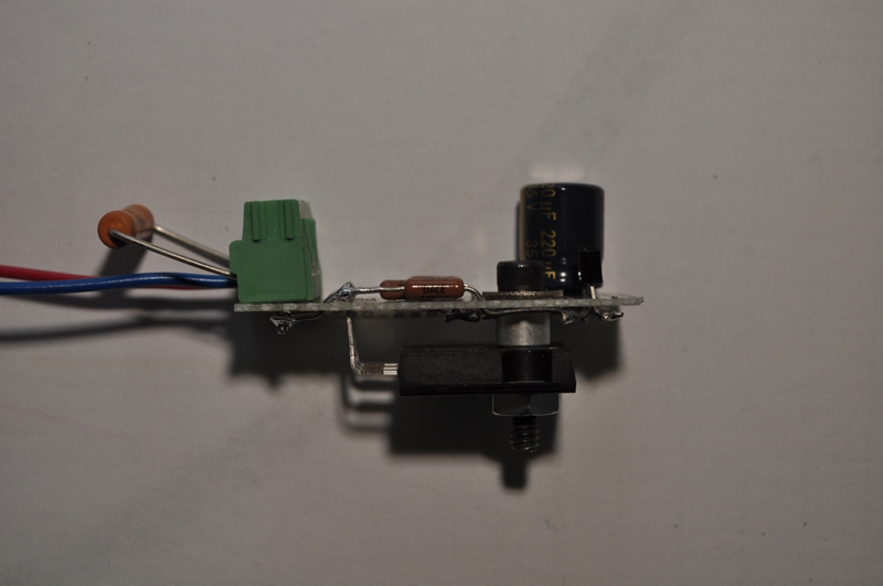

Here is a quick way to add a CCS without having to modify the PCB. Put the CCS components on a small piece of perfboard and mount with the same screw that attached the FET to the heatsink.
I won't be doing that on this design, later I will do it on a different design.

I meant on photo = what's missing .....
Ok.
