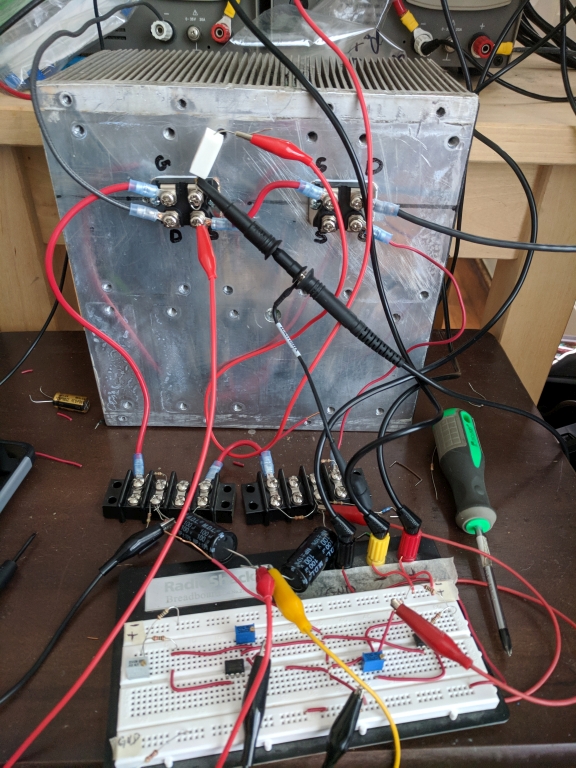

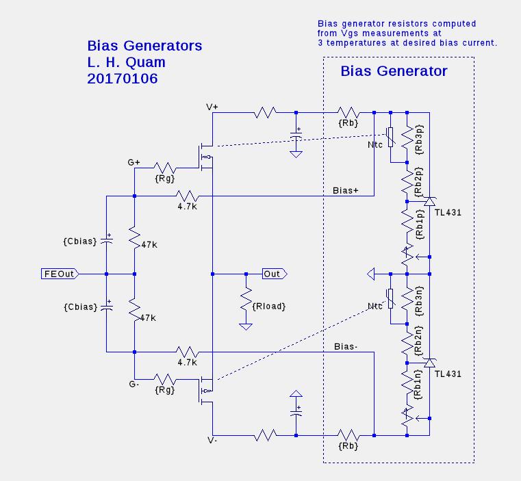

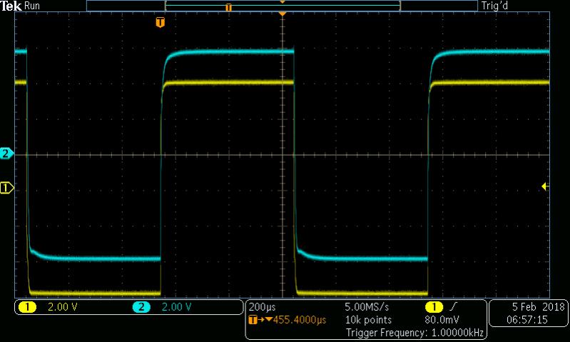

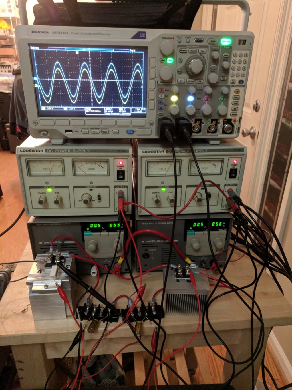

Here is the OPS wired up for business. Just resistors and two capacitors. The circuit is what L. H Quam posted except I did not use TL431 for this test.

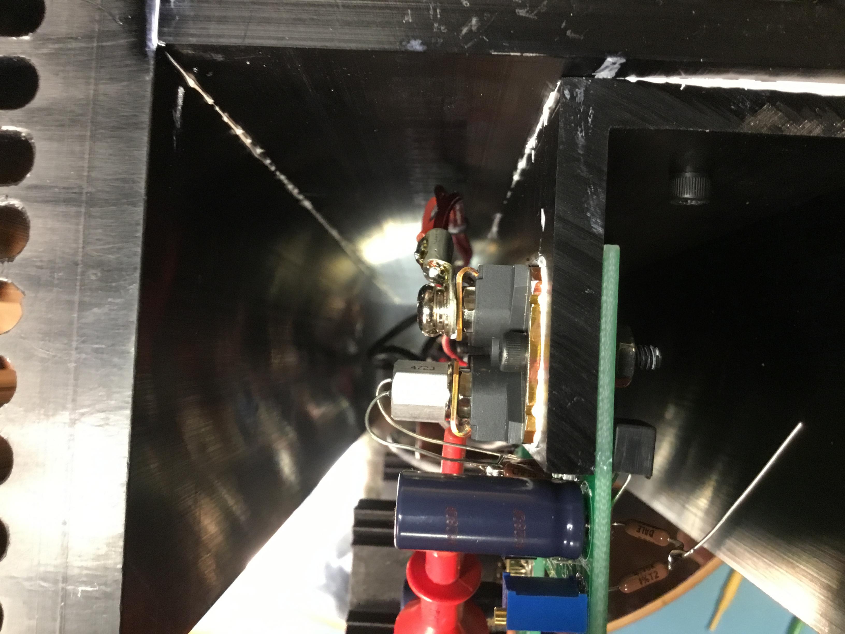

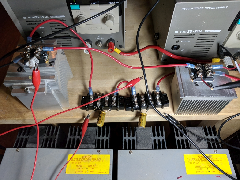

Since the hockey pucks use ring terminals, I pulled out some terminal blocks to allow wiring up the circuit quickly.
The capacitors are necessary. Without them, the 47k resistors kill the input signal.

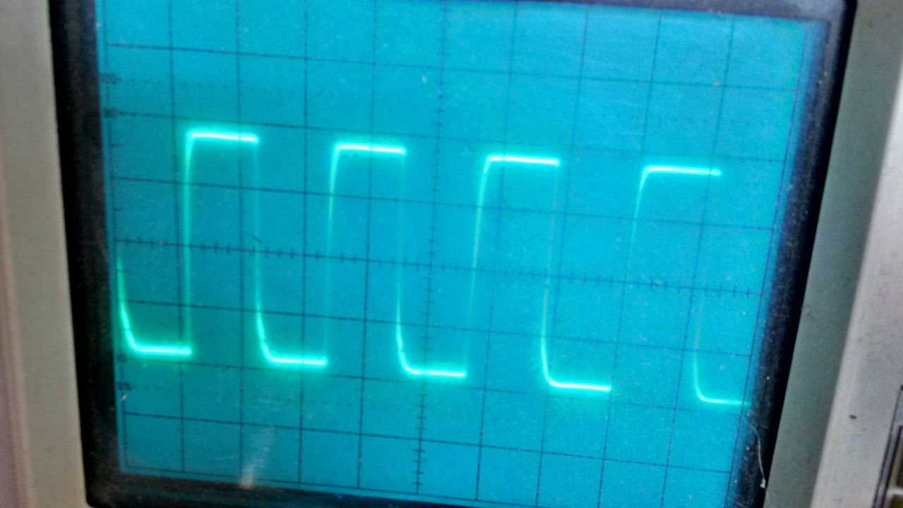

I too noticed an artifact on the bottom corner of the square wave this one done at about 200KHz bias around 2Amps (Wish I had better test equipment like yours!) View attachment 660713
What bias current are you using?
Keep up the good work!
Bias 600 mA to 2A. I adjust the bias up and down to see if there is any difference. Since the load is 47 ohms, I am not using very much of the 0A to 200A capability. When I have a large capacitor on the hockey pucks, I will do a one-cycle sine wave at 200A.
Yes so it makes mounting easier just apply goop and bolt down.![]()

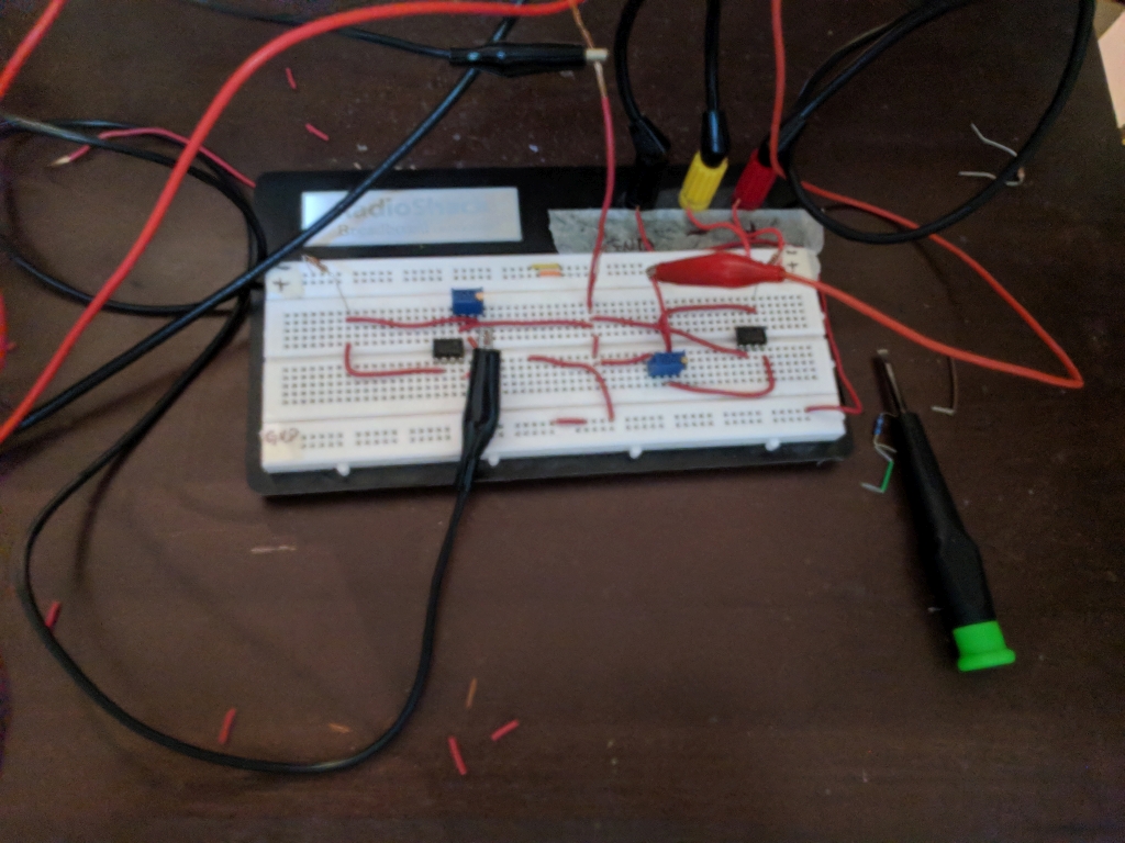

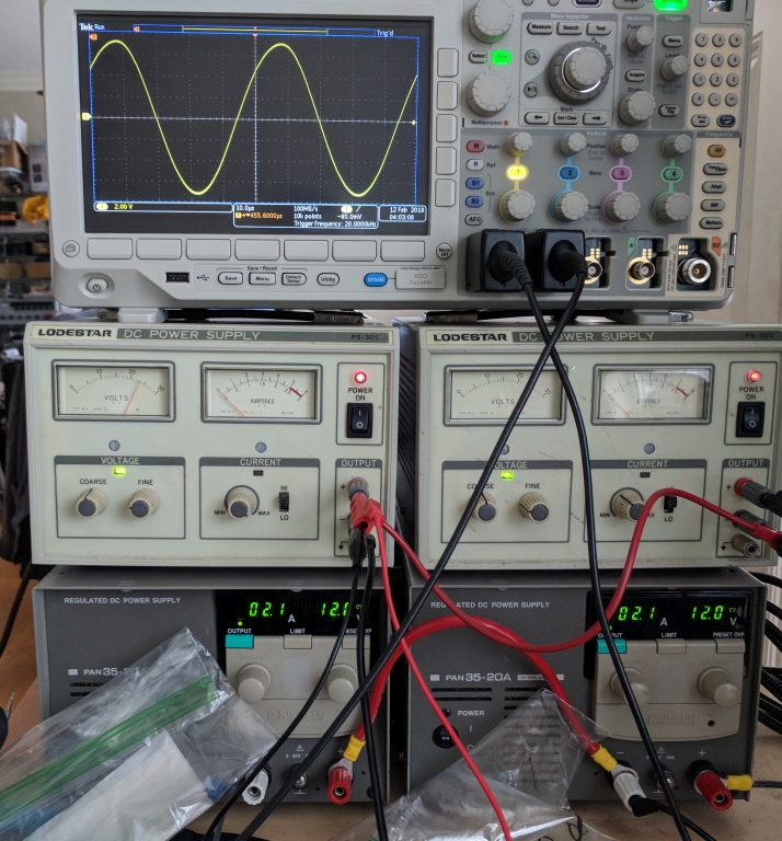

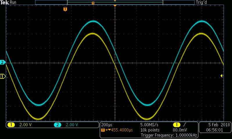

Here is the OPS running with the new bias circuit. Scope shot of 1kHz sine wave.
At 6V Vds, the N-channel FET is not happy. The top half of the sine wave is visibly pushed to the right. The cure was to increase the positive power supply to 12V. The negative supply was left at 6V to experiment. At 12V Vds for the N-channel FET, the sine wave is no longer pushed to the right.
This may be a visible manifestation of the device capacitance being voltage dependent.
The N FET appears to have lots more low voltage capacitance than the P FET.
Next I will measure Vgs at temperatures from cold to hot to select temp comp resistors.

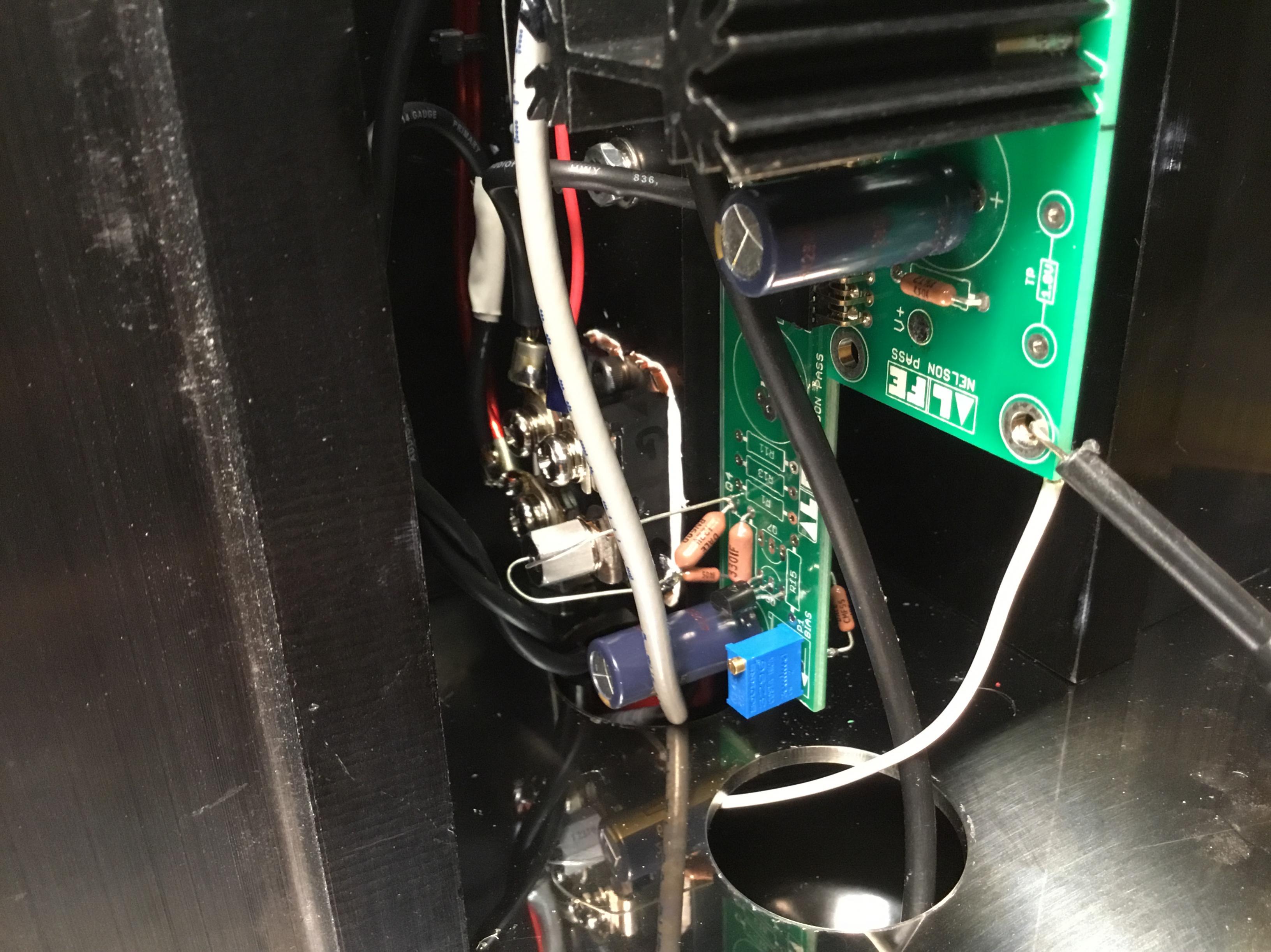

Modified the bias circuit to implement the offset correction resistors and pot that are in the F4. It works great. Here are the beastie MOSFETs on a equally beastie heatsink.
The bias is set for 1.1 amps. Output offset voltage is tweakable to below 1mV.
It is a beautiful and elegant bias circuit.
DIY Store F4 boards will be in-hand soon to commit this lashup to a more permanent arrangement.

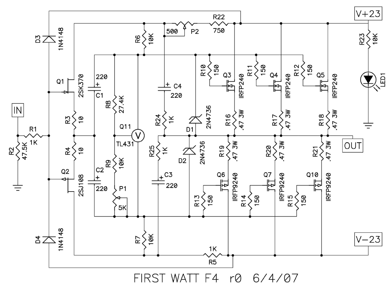

I just lifted the output bias string from the F4 r0 schematic. P1 sets the bias and P2 adjusts the output offset.
I used two of the TL431 but I will be dropping back to one TL431 when the F4 PCBs from the DIY Audio Store arrive.
The first time through adjusting the pots, I set the current for 1.1A cold. When warm, the bias was beyond 3A. While the heatsink was still hot, I adjusted for 1.1A. After the heatsink cooled off, the bias is 0.7A.
I bought some thermistor NTCs and will eventually add one to the TL431 circuit with associated resistors. I think adding the thermistor is advisable. If the heatsink gets hot enough, the bias current rises precipitously.

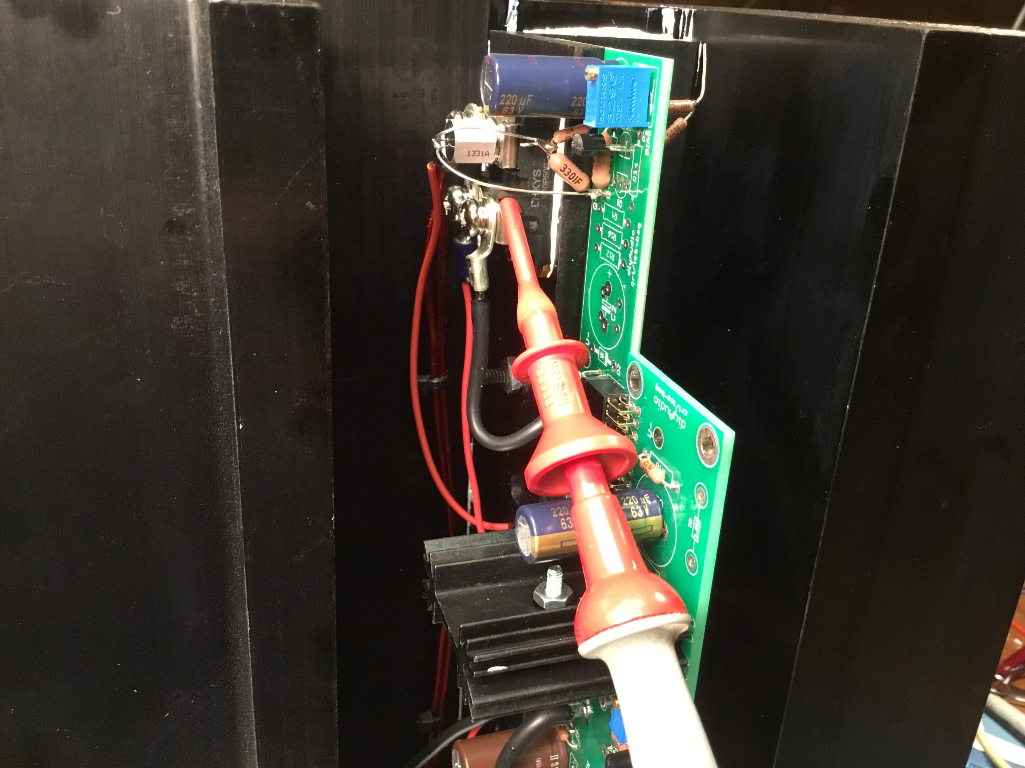

Here is the first channel on the bench. This build is based on teabags AL boards. Just a few tweaks and it is easily converted from VFETs to pucks.
And the porn for Zenmod...
Now I just need to build the second channel.
