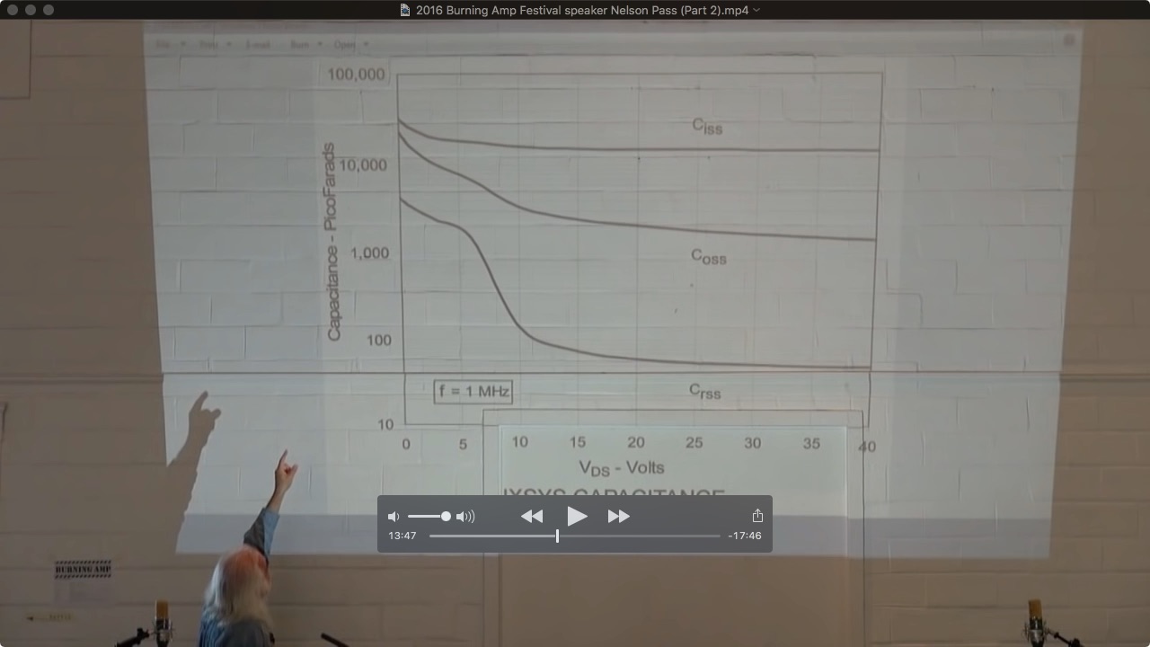

I was told that with source followers the Crss is the more important value to look at.
And this one declines with certain types at 25V considerably. Look at Pa´s Burning Amp speech 2016 and there was besides other this interesting picture....
So you must look for Ixys that go down in this way for Crss.
It is a pleasure to hear his explanations.
Wow! What a great resource. Thank you so much. I almost missed that your screenshot was at 13 min. I thought the discussion about capacitance was over at 4m into part two. This talk answers a bunch of questions for me. I usually do not study videos. I don't have the patience. I must rethink. Thank you for alerting me to this talk. I imagine that if I was going to play with "pucks" using a typical FW PS; this P channel having asymptotic capacitance changes at a low voltage would be a candidate if I could match it up with an N channel.
Nelson Pass's talk especially caught my attention when he stressed the value of saving voltage. Partly because the "pucks" would not enter into a range where the Crss was steep in the curve. It looks like Crss for most of the pucks starts to flatten at 15 V. Thus, it seems that a design may "save" 30V from the rails. A First Watt PS of +- 24V would need to limit the OS voltage to 48-30=18V AC to minimize distortion. 1.3A bias X 18V = 23W. Efficiency for Class A at 20% and, thus, .2X23=4.6W if using a puck with 2X24V rails limited to 18 V swing to stay out of Crss steep slope territory. It seems that the FW PS rail voltage (48 V potential) may be a bit low if 30V is "saved" from 48.
