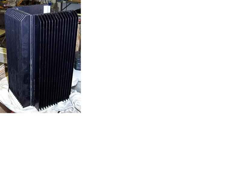

Who can resist building one? Not me
Nice big heatsinksNot close to done - my F4 chassis in the works.
Steen
