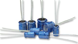

BTW, does anybody know that Panasonic released a new series "for Audio" available from Farnell?

Steenoe, as you're one of the few who already have built an F4, what do you thnk if I send you (for free, of course) 4 pcs new Pana "for Audio" 220uF/35V ?
Do you have time to try them and report us how they do sound?
They are quit small and I'm pretty sure they fit in any pcb.
If you accept, drop me a mail with you complete address.
I'm just curious about them and I don't any audio gear using EL caps as coupling caps where to test them by my own.

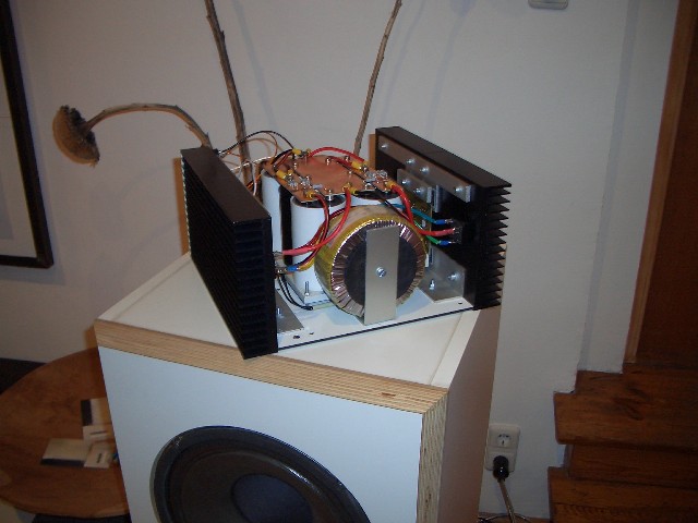

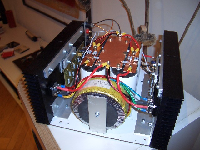

Next week I´m going to complete the cabinets (I hope, I do so - my Aleph P looks this way since half a year now). :ashamed:
I used Veteran´s pdf for the boards. The transformer is 330VA, caps are Evox-Rifa and Sikorel, 152.000uF/amp.
Heatsinks are 325mm x 160mm x 40mm and get quite warm now, but I think they don´t get too hot. I can still touch them for several seconds without getting blisters.
The enclosure will be made of 8mm aluminum, the front panel of 15 mm aluminum silver anodised.

Looks really good, nice and solid! I think you have enough capacitance in your psu.. :bigeyes:
Are your heatsinks made of two square pieces? If so, you'll get better performance from them by rotating them so cold air can be "sucked" in in the bottom an blown out in the top. Placed horizontally makes them less efficient because the hot air cannot easily escape the fins.
