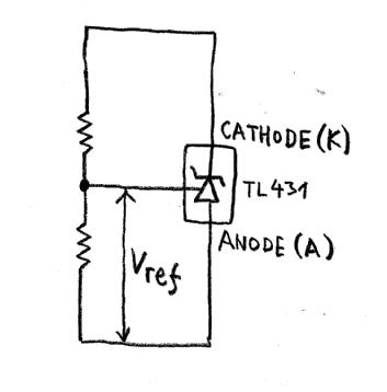

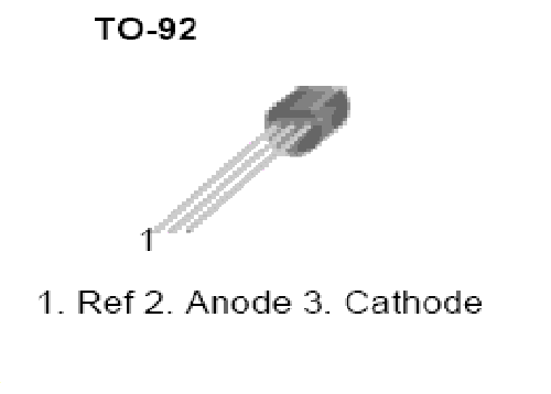

Now I will make an utter fool of myself (ahem, again). I have a question on this simple circuit that I should understand better, but don't:xeye:
- Regarding the TL431, what exactly is it doing, and which way does it go in? I assume that the reference connects left (in schem), the anode connects neg, and the cathode connects pos. Am I right? Do I win the dunce prize?:blush:
I think you are right about the pins of Ref, K and A.
The reference voltage between Ref-pin and A-pin is 2.5V
whatever resistor value (at proper current level) is between
those two nodes. Then, you pay a peanut for the calculation
of the voltage at K ^^.
:darkside:

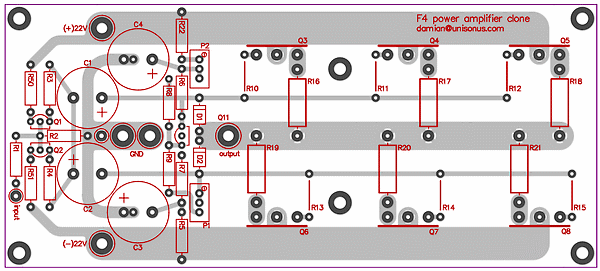

Mark,
you can see the orientation of the TL431 on the board layouts.

mpmarino said:
For some reason
For some reason i don't get why there's not a uniform lead pattern for these devices, not even for same brand components.
National also manufactures the oldy LM335Z, besides the LM431.
Precision temperature sensor, but the +,- and Adjust leads are switched.
The LM335Z is a valuable friend for Class-A/Pretty-Pass amps, btw.

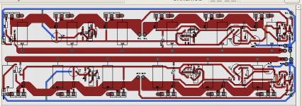

cviller - you are just as bad as Steenoe (building stuff so fast), but even worse - I just picked up 12"x12" copper clad board today to etch your babelfish layout and now you are teasing us with F4 layout ...
Of course, you will have to let us know how it sounds
Please let me know before you etch my fish... I have a few updates to for it.
Papa is the one teasing as all! I would love to see the aleph j too! :cheerful:
