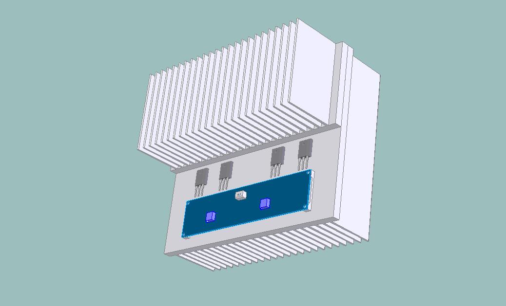

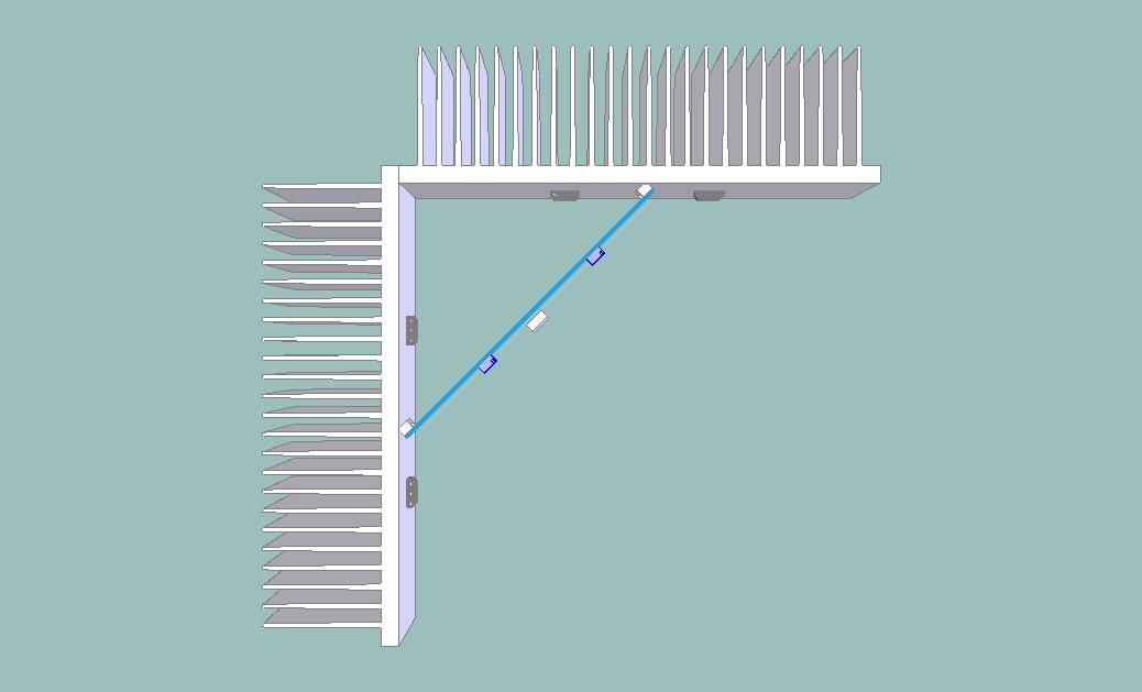

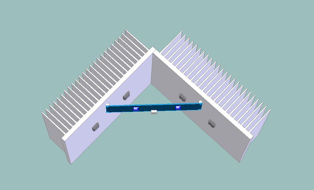

Maybe something like this (Aleph-style) for better distribution?
Andersonix, I appreciate your ideas, and help. I've decided to go with what I thought your first idea was. Rather than wack up an 8X10 like the major design depecticted, I should just add a 4" section like your first pic suggests. Also, rather than do-it-myself, I went ahead and ordered a 4" peice to mount like your first pic. Thanks for the idea, but, I need a few days for UPS to deleiver before I have any measureable results... In the mean time, How should I fix the backside piece to the frontside piece? I think maybe 5 bolts front to back (1 in the middle) and some A.S.5?

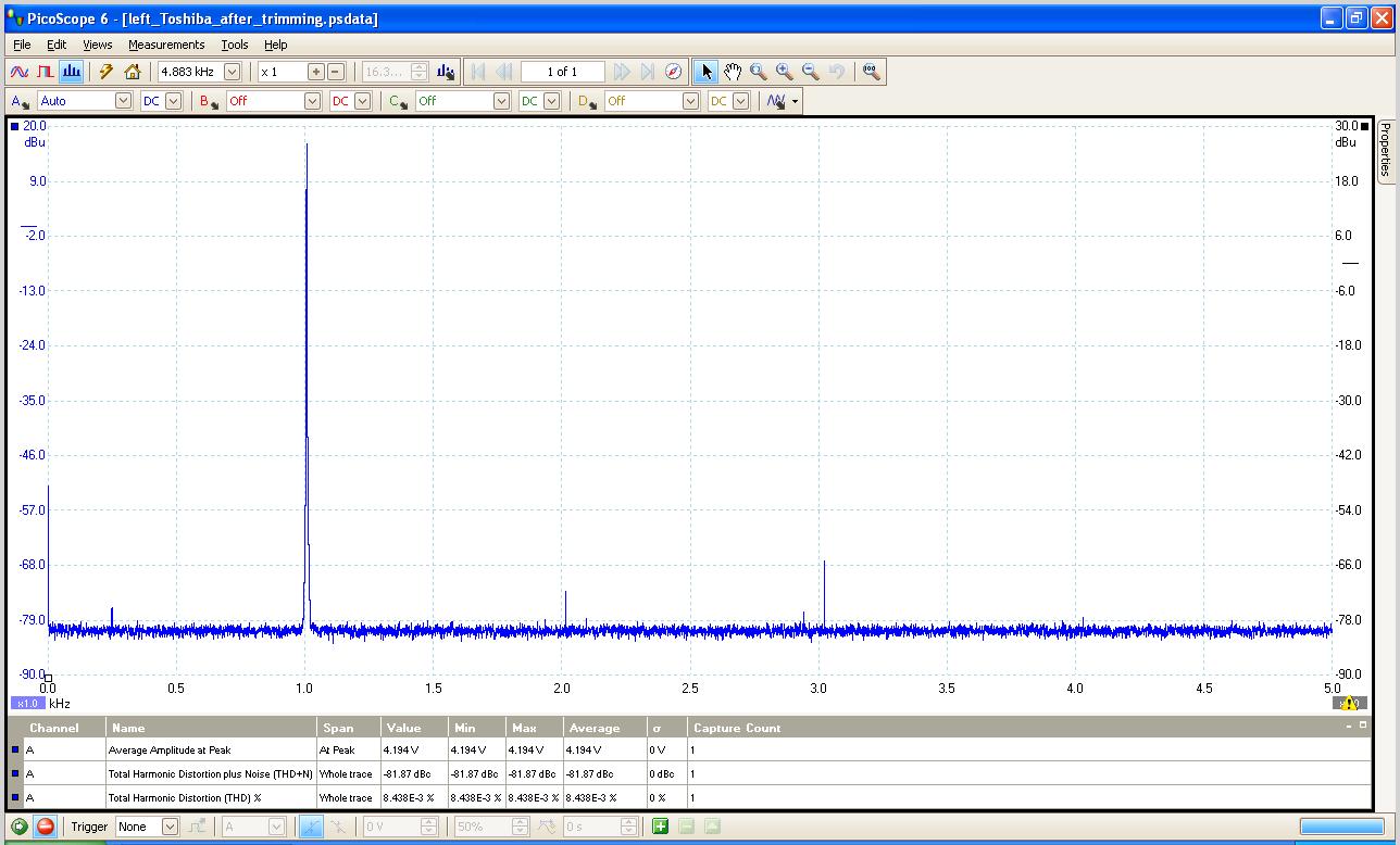

So, I am running with the variac, and brought the voltage arounf 17.5 V. The maximum I can go with this variac.
I kept 2.7 A in the mosfet. Well...impressive. I also did a bit of tuning with the spectrum analyzer. The goal was to have a distortion spectrum similar to the one reported in the F5 article. I have to say that Toshiba mosfet go down in distortion of an order of magnitude.
I am really thinking of backfitting a pair of Toshiba in the reference amp.
Maybe sometime Partick (EUVL) is a bit grumpy, but he knows what he is doing. His note on the complementarity of the mosfet were very useful.
