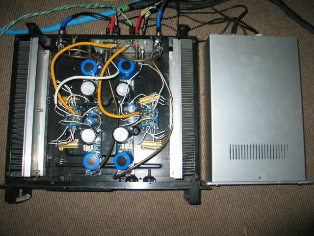

My Mosfets keep shorting and overheating and I am not sure as to the reason why. They are insulated from the cooling plate but the holding screw is not isolated any further. However the screw passes through the hole in the IRFP with no visible metal so I presume further insulation is not necessary there. The current limiter was not added to the circuit and grounding is as per your diagram. I use no load when testing the amplifier and only via a variac. I have burnt out about 6 mosfets so far. Any other ideas?? Perhaps the JFETS should be replaced at the same time as well??

You don't need to isolate screws. Did you use thermal paste, was heatsink surface properly smoothed out? Where the mosfets placed in proper places; one link to BOM had an error:

HI Peter ok tonight i got the first board going it was an insulation problem just the tiniest of nicks on the edge where the insulator pad had not fully covered. Repositioned the pad and first channel now works fine.Thank goodness for that I was getting quite frustrated. Still the victory is equally emotionally stimulating as the frustrations were.This is my second ever attempt at an amplifier build after the gainclone which i did manage to get right the very first time to my surprise and is still running without a single hiccup!!!

here is a shot of my set up using an old yamaha p series power amp chassis with heat sinks already built in. Four toroidal transformers sit in the case adjacent externally. As you might be able to make out one of the mosfets has been removed due to burn out I did not use paste!!! Worked for about an hour before burning out.
