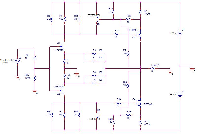

Sorry guys i am trying to simulate the circuit with PSpice but probing the current on the input jfets it says 10mA are flowing instead of the supposed 6mA.
Here is the schematic i am using (i also tried to use the 2sj74 and 2sk170 but i get the same results)
Do you see any mistake?
Could it be some error on the models? (in case may somebody post the spice model for the parts used?)
thanks a lot.
thanks a lot.
I think your assumed values for P1, P2 , R15,R16 are in error. All four are variable in an effort to maintain the 4+ volts across the 2.2k R3/R4.
Maybe I misunderstand here, but from what I understand from the article, you don't adjust P1=P2, but rather you adjust them independently to get minimal dc offset as well as maintaining 0.59 volts across R11 and R12
Quote from the article:
For each channel you will be adjusting P1 and P2 alternately in order to achieve 0 volts DC at the output and .59 volts across R11 and R12. Each time you adjust P1 you will probably have to go back and adjust P2 again, and so I recommend adjusting the pots in half-measures, alternately setting the pots half-way to their voltage goals and measuring the DC values.
Unless there is something very wrong, when the output is at 0 V DC, the values across R11 and R12 will be equal.

Stefanoo said:
what do you mean?
Your JFETs have an apparent resistance, if you put a source resistor behind it you can vary the current flowing into the drain.
But the actual current is determined by the Idss value of the device at hand.
Whether you play The-Sims or Curl-Ball with real devices, Idss is your input, different input is different output.
(NP suggested 8mA-Idss parts several pages back, which leaves over 6mA with the source resistor value in the schematic.)
