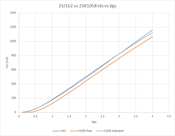

Here are the Toshibas -- adjusted for the slight difference in Vgs(t) with Vds of 20V
Here are the fairchild devices. the slopes differ by ~6% -- I regressed the data starting with 100mA
Here are the Renesas devices -- well known that yfs is lower, and thermal behavior opposite the vertical mosfets. to more accurately carry out this analysis you need a pulsed test fixture. The slopes are within 4%

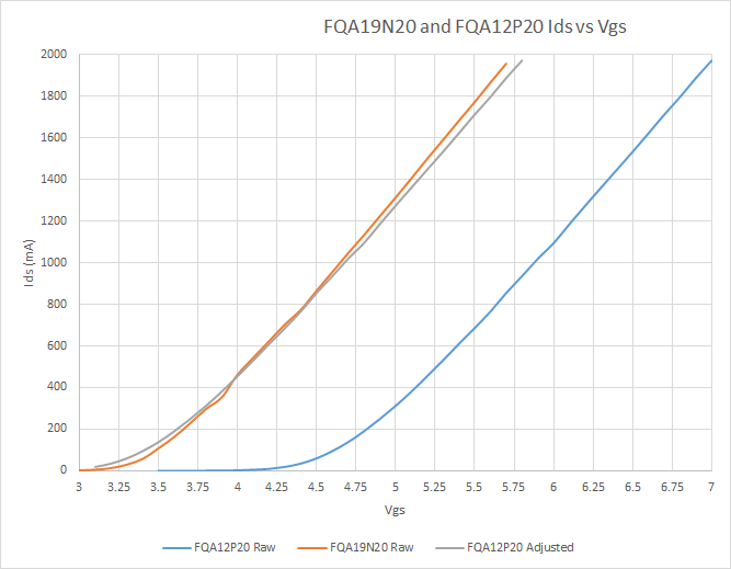

> the Fairchilds gm matched up better
If you were referring to the original FQA19N20C / FQA12P20 then I cannot disagree more.
How do the measurements of the FQAs by EUVL and jackinnj reconcile?

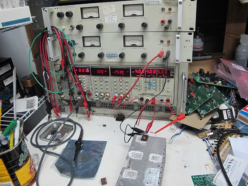

Could be that Patrick mounted his devices on a different type of heat sink. Best observation would be with the heatsinks at the same temperature and with a pulsed test fixture. I can do this with my FG5010 and wait until the heat sink temperature has reached stasis.
I don't know whether a 1R or 047R resistor was used in Patrick's example.
Note that the Fairchild curves pull away from each other in both cases.
The Toshibas seem to match up best.

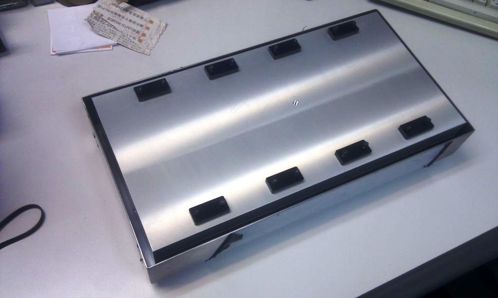

We use a computer controlled aluminium heater block weighing some 5kg, with extra thermal insulation on all outer surfaces.
It has a thermal time constant of multiple hours, and takes 6 hours to heat up before any measurements.
The current sensing resistor has a tempco of < 30ppm, sitting on a separate heatink at room temperature.
The data acquisition ADC's have an accuracy of <0.2% and are additionally calibrated against a HP multimeter.
We don't use pulse mode.
We run the FET continuously until the computer registers a repeatability of 0.5% over the complete range.
2000 data points are taken and then fitted with a 6th order polynomial to remove noise.
The curves we showed are pure Id vs. Vgs and do not include any source resistor.
Patrick

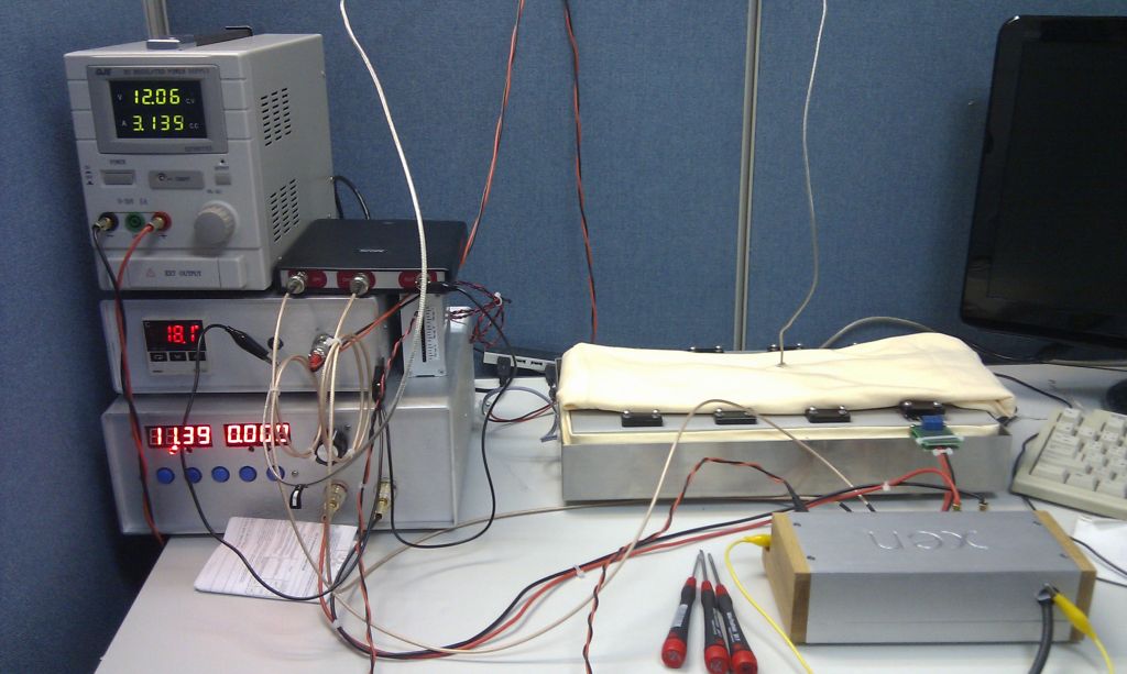

Pictures of our matching setup, MOSFET heater block (insulation removed), and a special heater block for TO92 JFETs.

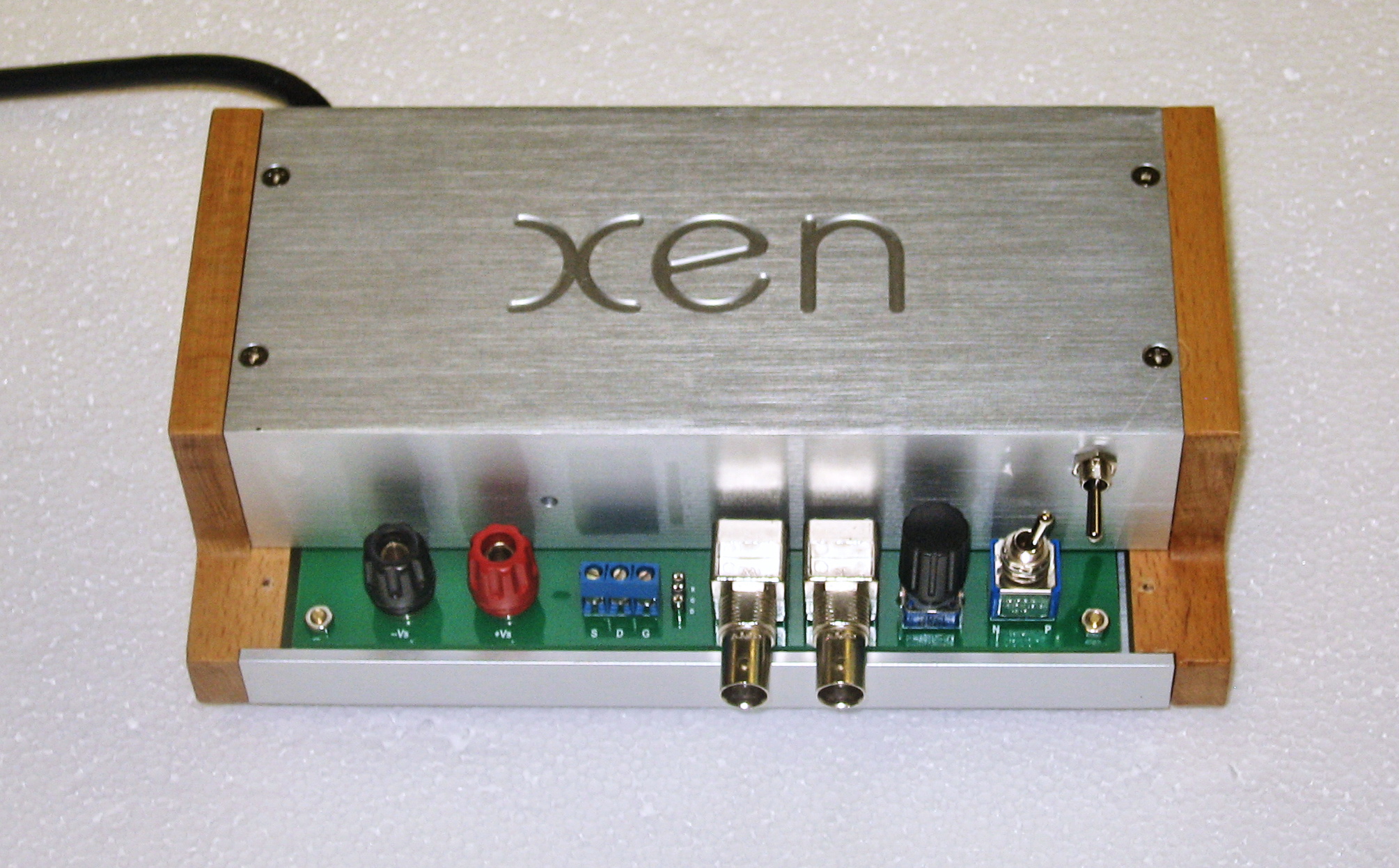

And the FET tester of our own design.
Patrick
Patrick
