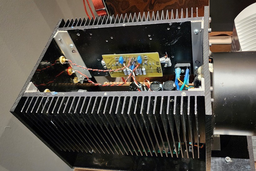

16 years later ... it doesn't get as much play time as it used to but it's still part of the lineup. The heatsinks are on the small size but I found that even at 1.0A bias, the harmonic profile of the F5 doesn't change (ratio of H2/H3 ...), it probably just doesn't stay in class A as long but at least it's avoided being retired.
I rebuilt it a few years ago into this case and updated the PSU but bumped it down to 1.0A to keep the heat under control.

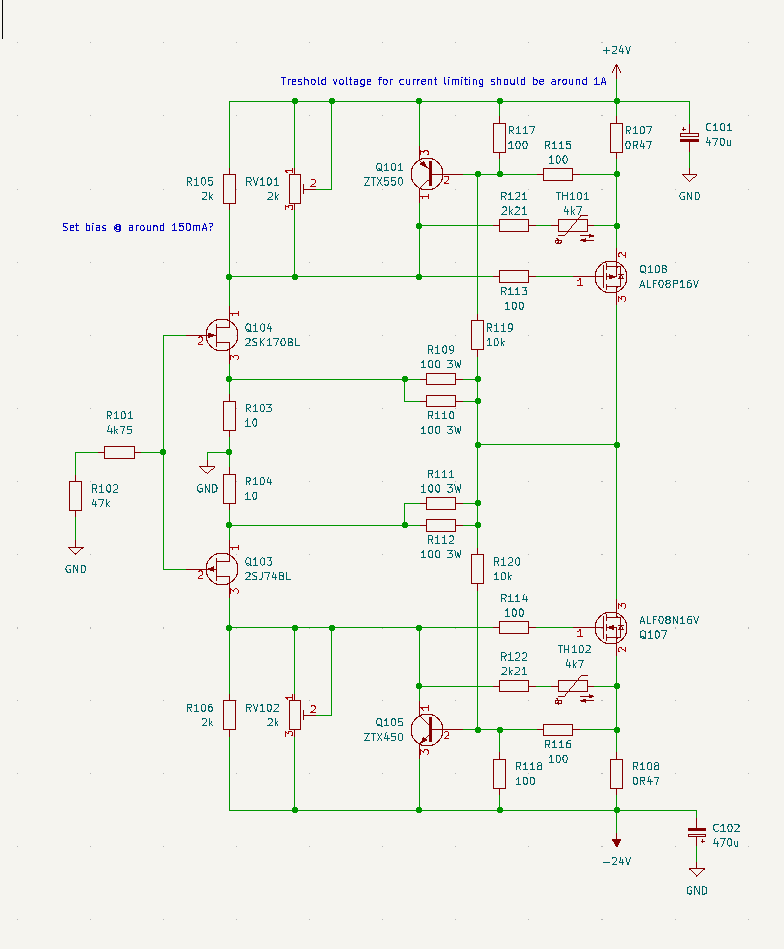

Hi guys!
I hope you can give me a sanity check
It's an F5, for headphones (planars like Susvara, so gain is pretty much the same) with ALFET lateral MOSFETs from the givaway.
I adjusted some things:
1. Lowered bias resistors R105/106 and trimmers to 1k to be more in the range of ALFETs cutoff voltage. They start between 0,5V - 1,5V I gave some headroom, this should give me a nice play around 2,5V
2. Lowered the current protection to trigger around 2,6A. Still way too much, might go even further by lowering the R115/116 to 1Ohm to be around 1,3A. Still kinda much though.
3. I want bias around 150mA giving me a clean 1W @ 64Ohms with a huge margin. And MOSFETs like to be run hot.
My questions are as follows:
1. Is this a right direction?
2. Did I forgot about something and it will blow up in my face?
3. How to handle gain switch? Relay connecting additional resistance across R109/110/111/112, thus lowering the gain?
Thanks!

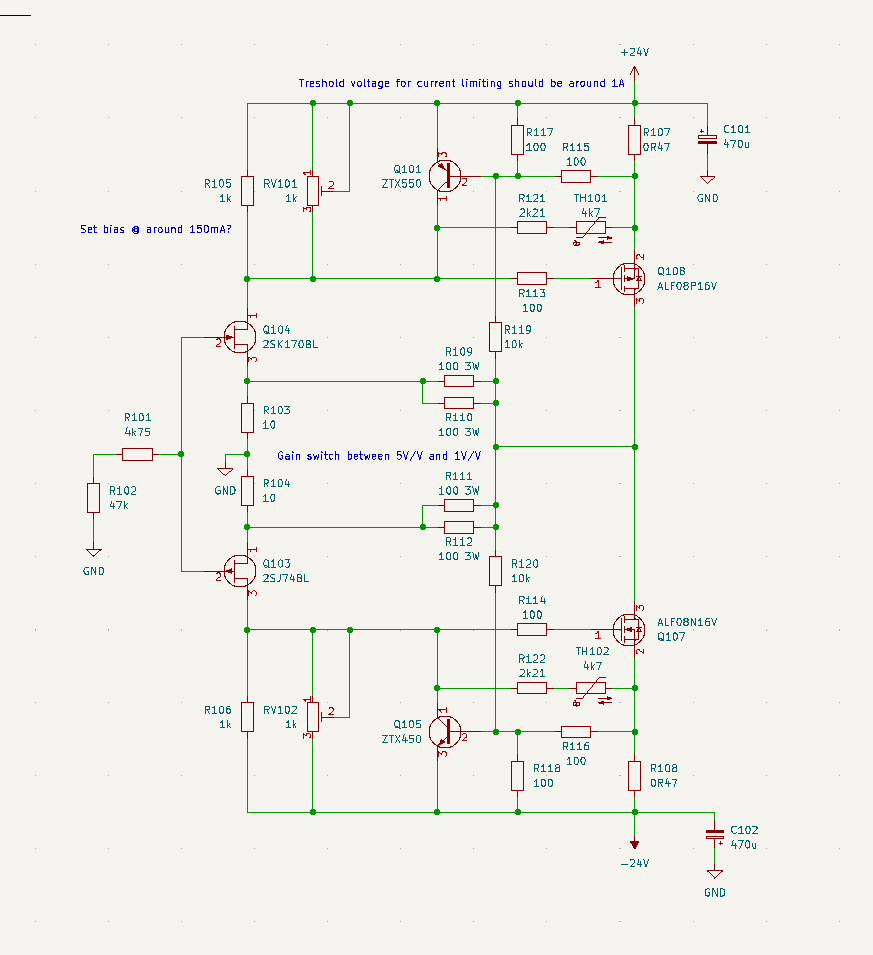

Thanks!
Short edit: to get 150mA of bias I would need around 0,7V of Vgs, so I guess we can make the resistances even lower.

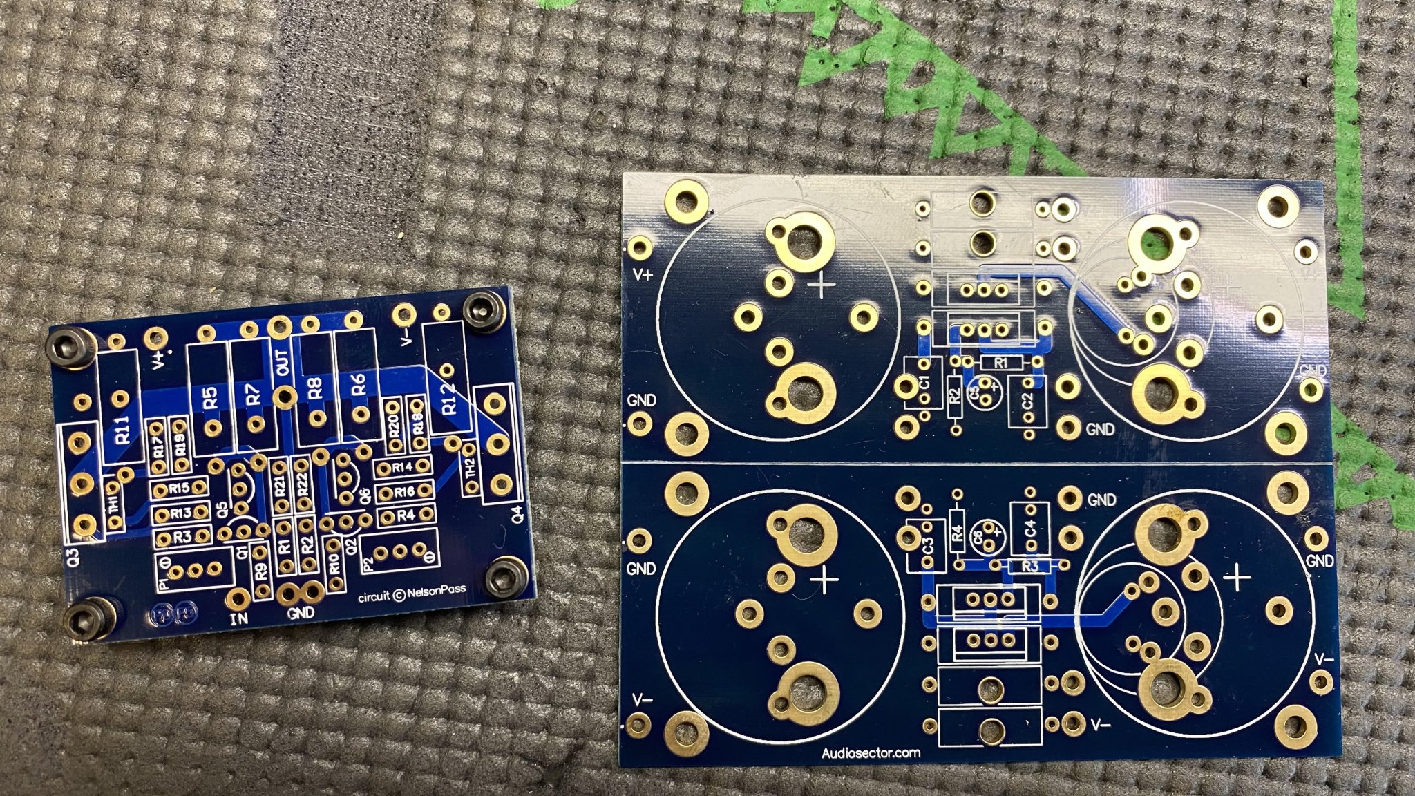

So a buddy of mine had this F5 kit from apparently a long time ago, I think it's a V2, but does anyone recognize this board set? I'm going to try to assemble it using the V2 schema. Anyone have knowledge of this version of board / kit?
I think that’s an @Peter Daniel board. It says audio sector on the power supply board.
I’m assuming you have another channel.
I do, yes, actually I have 3 more amp boards and another power supply board. I'm gonna try to put together a shopping list tomorrow and try to build these. I did check that website, but it doesn't seem like it's a product they offer anymore. The friend that left them with me also sent an e-mail to someone that he got them from.I’m assuming you have another channel.
I'm glad someone recognized them, though. Makes me feel better about building it, lol

Thank you sir! This looks like the one!
You mean like perhaps the first build guide I did…?
https://www.diyaudio.com/community/threads/an-illustrated-guide-to-building-an-f5.188691/
