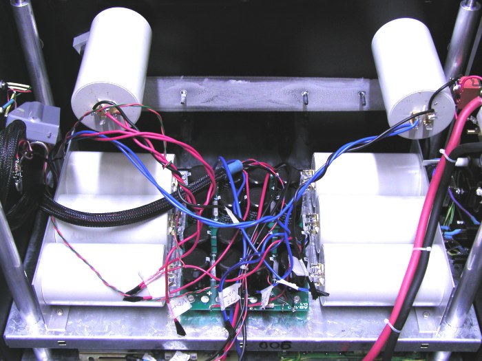

in any case - it's hard to beat ( without resorting to some active solution , of which cap multi is almost best possible ) brute force approach - hefty C bank , without any resistive or inductive series element , along with rectifiers and xformer(s) capable to feed that C bank ....... and last , but not least - hefty bypassing that C bank with solid caps ; motor run ones , in range of 50-70uF , are my fave .
strictly speaking of A class amp as load/governor of TES delivery to your precious speaker :clown:
you've confused me, I always thought crc or clc is better than ccc?
and last , but not least - hefty bypassing that C bank with solid caps ; motor run ones , in range of 50-70uF , are my fave.

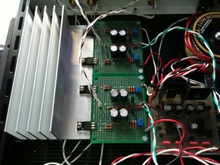

F5 with K2013/J313 as Line/Headphone Amp
Finally, I finished this version of amp as describe in post #42 last weekend. I am listening to it as an lineamp for a few days now.
Beside the thermistors that I chose not to use, everything else are as in the diagram in post#42. The sink is big enough for more current but I can only bias it up to 120mA and the regulator's pass trans become quite hot.
I can easily hear big improvement over the original version. Both hi and lo seem more extended. It sounds more opened. I am very very happy with it. Thank you very much, Juma. :worship:
I found the jfets are run at about 8mA. I measure about 2V at the source of the jFets. Is this an optimum point?
I'm glad you like this preamp :up: :cheers:
About that voltage - measured directly at the JFETs Source there should be about 100mV (relative to GND).
Those 2V you measured is probably on the other end of R4 or R5 (further from JFETs Source).
😱 You're right. The 2V is on the far ends of R4/R5 from the jFets' source.
It seems to me the jfets are ran at the point near their Idss. Would it be better if we select jFets with higher Idss, say 10 mA, for this circuit?
:cheers:
The most linear region for these JFETs is near the Idss. I usually use them at 70-90% of Idss. That should not worry you - if you are afraid that your JFETs dissipate too much power, you can easily decrease the power supply voltage to +/-15V.
Using higher Idss JFETs won't bring improvement in this case.

Looks nice and neat, cheap (a lot of small ones are cheaper than one big one ....and a more flexible layout possibilities! ), FC ( i might be wrong but those look like panasonic FCs ) don't come in BIG packages.....😀 would be my reasoning.
