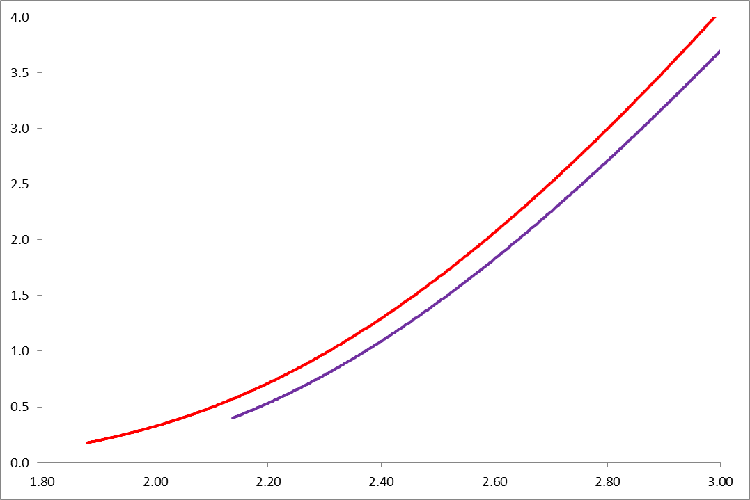

And if you are thinking of using 2SK2013 in parallel to replace 2SK1530, I personally would use at least 6x to replace one (for thermal reasons).
And then you'll see there is next to no difference in a number of key parameters any more.
After all, they all come from Toshiba's MOSFET processes at around the same time.

That may be right, but the 1000+ 2013/313 I have traced are still much more linear and complementary than the 1000+ 1530/201 I have looked at. Most of 2013/313 I have were actually fabricated in 2011, so a bit more recent than the 1530/201.

How did you calculate the 9xK2013 curve?
