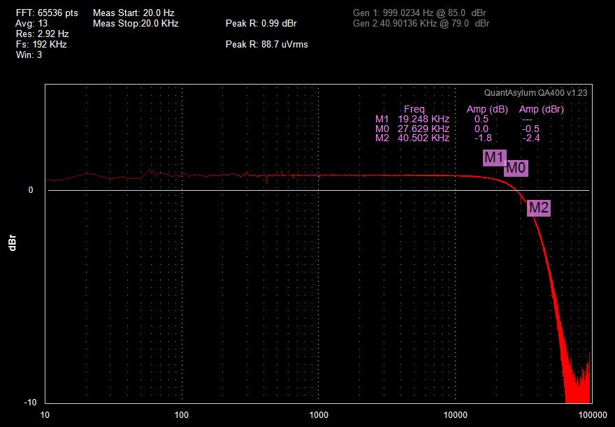

I built this amp about a year ago, and have been really enjoying it. See post here:
http://www.diyaudio.com/forums/pass-labs/168040-f5-2sk2013-2sj313-73.html#post5169846

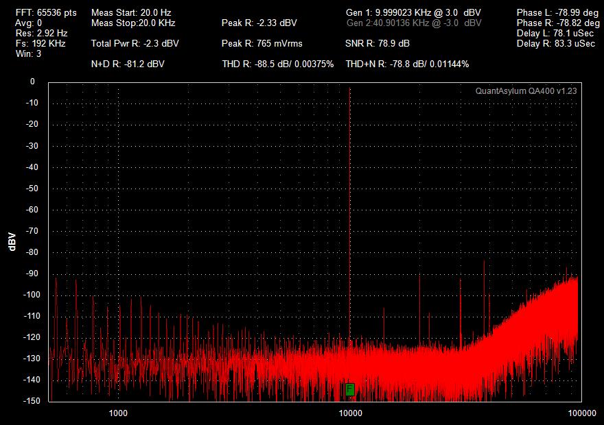

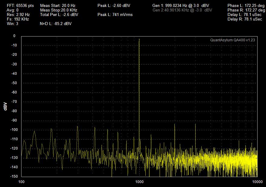

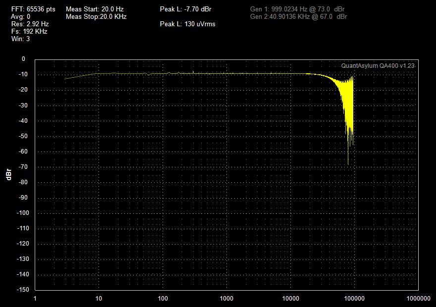

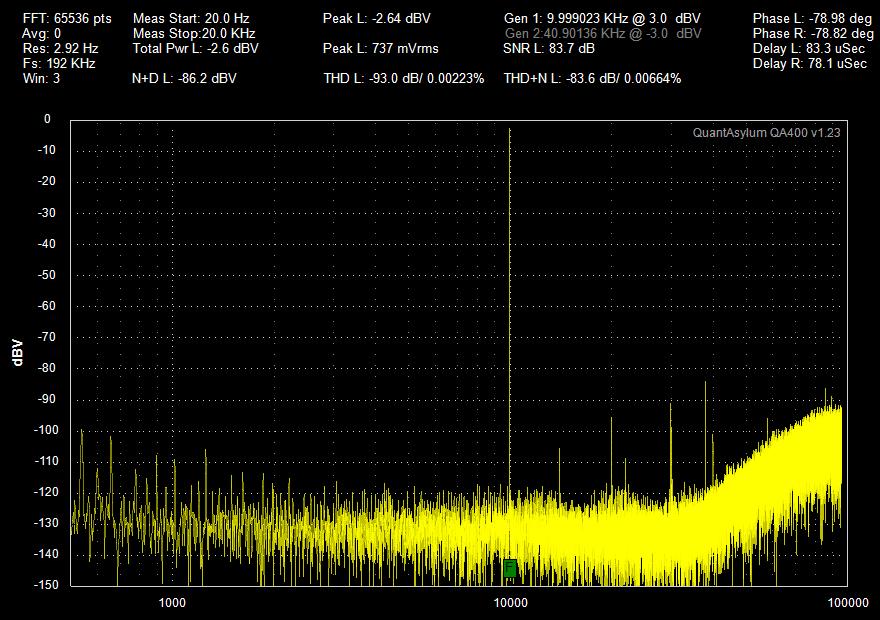

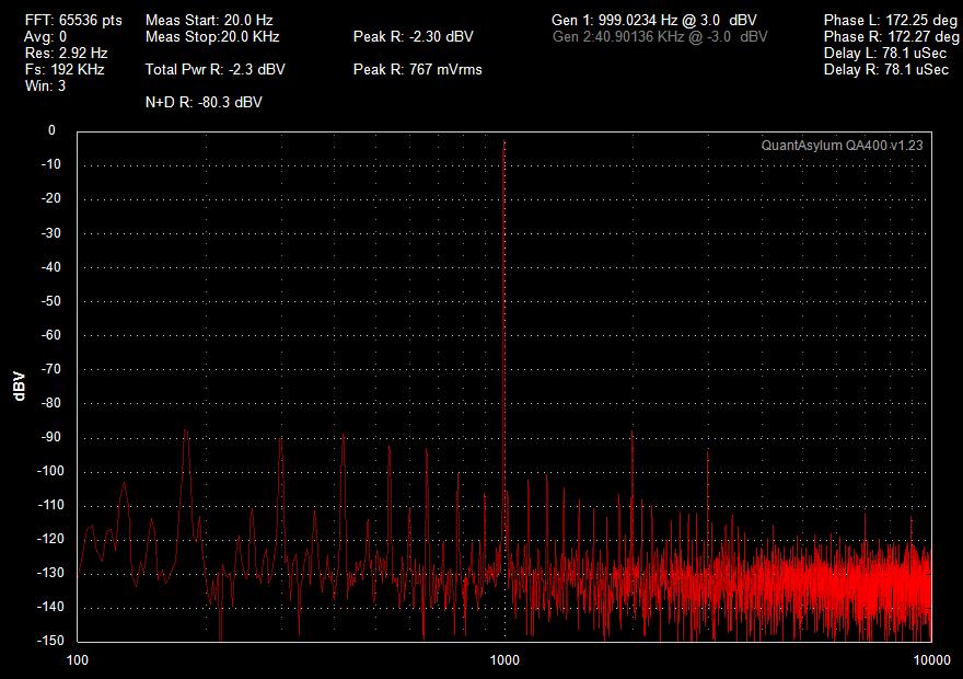

I just picked up a QuantAsylum QA400 from another member, so this is the first time I've ever done measurements. The input of this device only allows a 2Vrms input, and I didn't have any voltage divider resistors on hand, so all measurements were done at low level, very carefully, with a 7.5R 5W resistor.
So, these are all around 1/2W - 1W output. I'll get some resistors and measure again at higher wattages.
I took a frequency response, as well as a 1 kHz and 10 kHz measurements.
Some notes:
Let me know if it looks like I did this correctly. If I did, I'm pretty impressed! All harmonics are down at -90 or -100dB, I think not bad!
Thoughts?
Some notes:
- On the left channel, I did a better job matching the FETs. The right channel has one slight outlier. I suppose this is this reason for the slightly better measurements of the left channel?
- Frequency response looks pretty good! I put some capacitors across the feedback resistors as NP had suggested. Maybe this accounts for the declining response above 30kHz? Not that it matters- but I believe the F5 is flat out to 500kHz otherwise.
Thoughts?
![F5_FreqResp.jpg F5_FreqResp.jpg](https://www.diyaudio.com/community/data/attachments/627/627256-6343174405e3409cd86c9eec72499bca.jpg)

Looks OK - it's only that noise is more prominent, but that's your SMPS, I suppose...I built this amp about a year ago...
Let me know if it looks like I did this correctly. ...
Thoughts?
Is that graph "inconsistency" visible above 40-50kHz, the result of audio analyser quantization noise?
