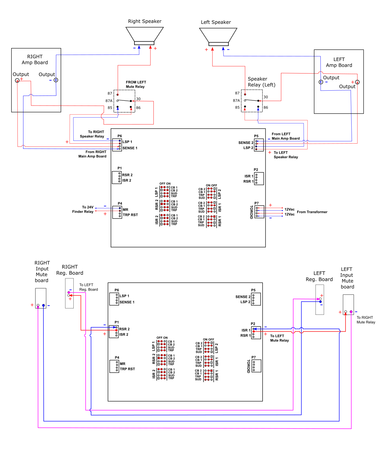

Not sure why the Loudspeaker relays are on in standby mode. The regulator relays should be the ones powered.
Yeah. I am not too sure either. Just not sure which to check first.

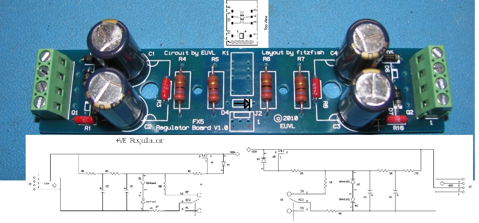

I remember that I had problems in soldering. That's why after this experience I decided to buy a microscope. One thing that I remember that I failed to properly isolate one of the regulators: results, the board was working properly, until I connected another component. As soon as I was connecting something else, the output voltage protection was kicking in.

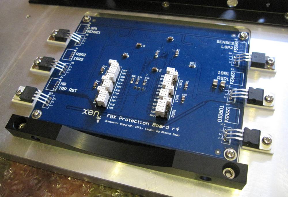

Out of the 25 first batch subscribers, how many have done up their complete working amp (includes the all working protection board)? Maybe you can help write up a build guide.
also It Is Interesting to know version of protection board used
building guide does not cover protection set up - but how can be started F5X then
Is there anyone to offer alternative to that not user friendly protection board

I now can switch on the amp but with no standby mode. The speaker senses are workin fine. With 3.5vdc it shut off the amp completely.
1) turn on back panel switch....few seconds later the MR led turn on
2) pressed front button.....nothing happen.
3) pressed another time....Blue Led turn on and so does the rest of the LEDs.

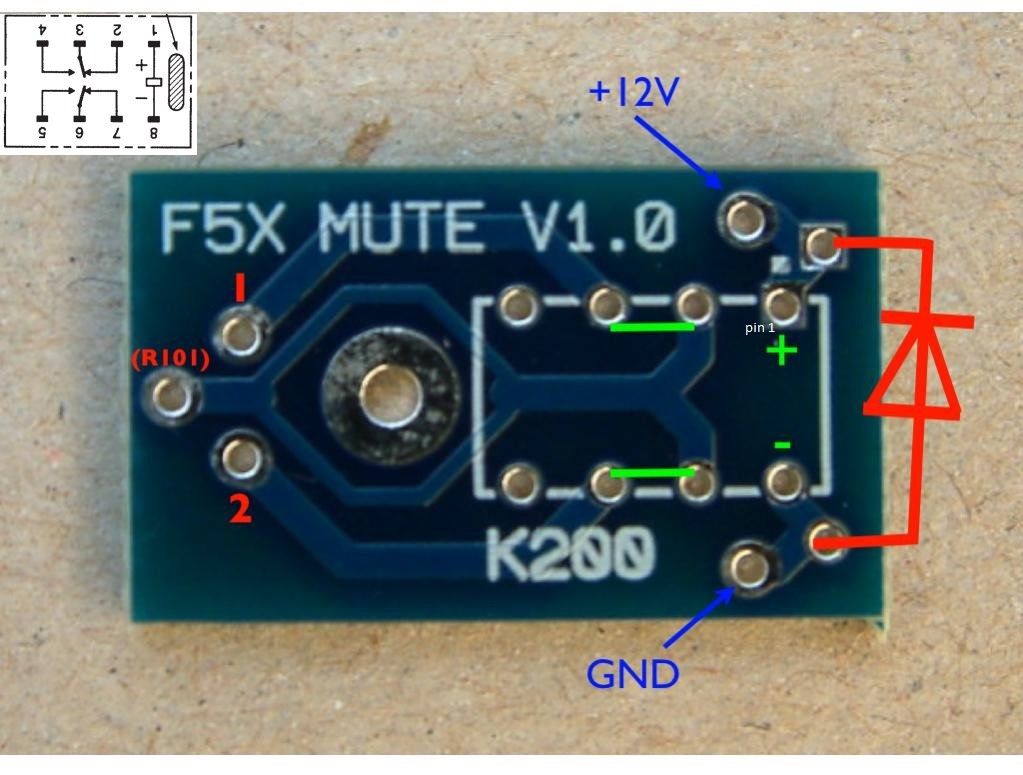

Alazira, this is the first time I hear of a diode for the speaker relay.
You can see the mute and regulator relays (D4) using protective diodes. Some automotive relays have built in diodes. If they don't, you should add one somewhere.
