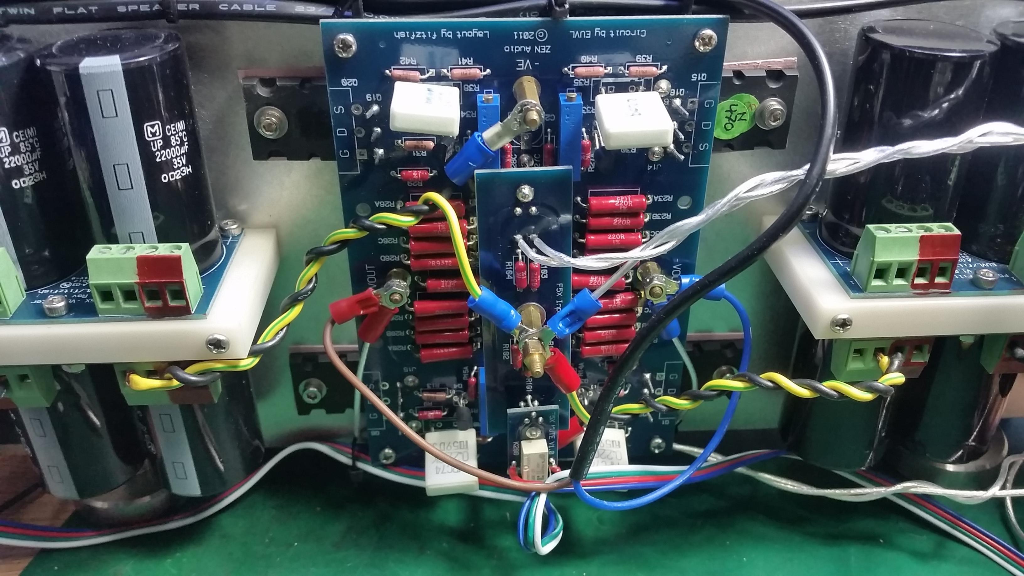

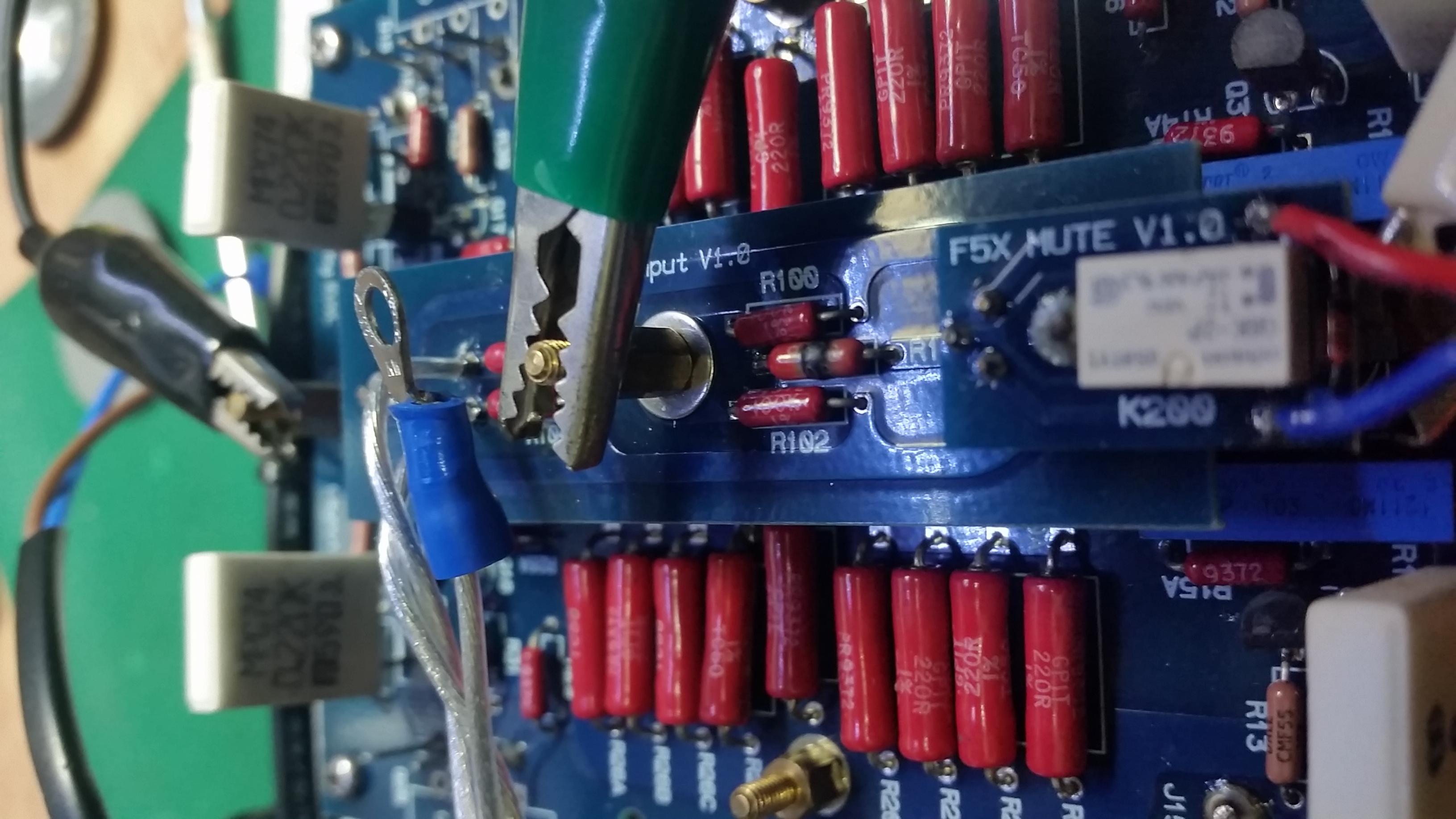

The R101 is burned. In my haste to get the amp up and running, I've connected the v (-) filter board wrongly. The rest seems okay. I've test the board with lab supply and it still work. Will this affect the biasing?

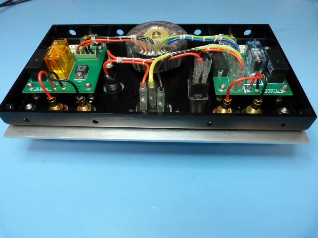

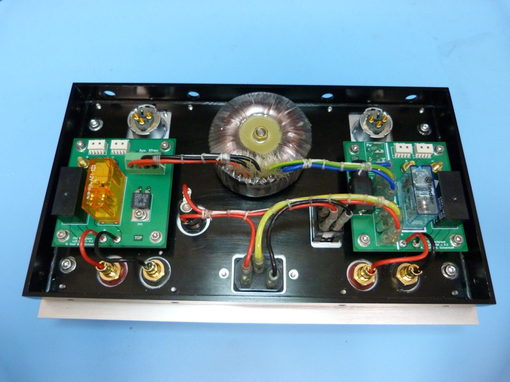

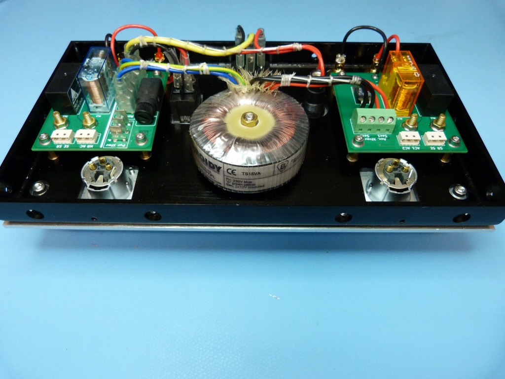

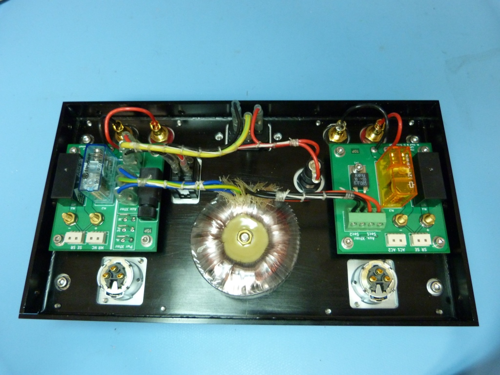

Backplane connectivity
Since we were under the impression that the rather wild wire routing and loosely mounted components at the backside of our first amp would not be an adequate permanent solution we designed two backplane boards ...
Markus & Ulrich
