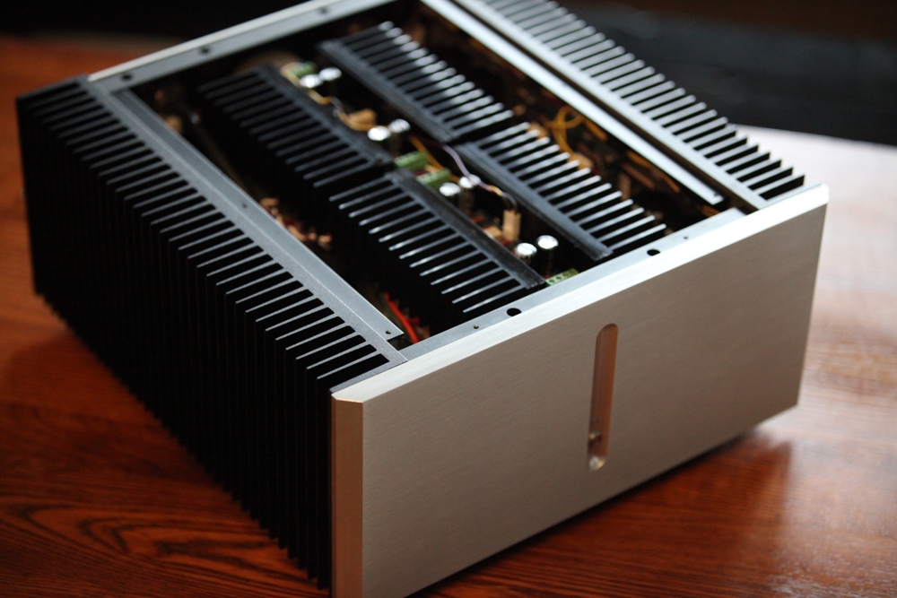

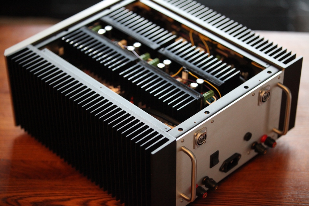

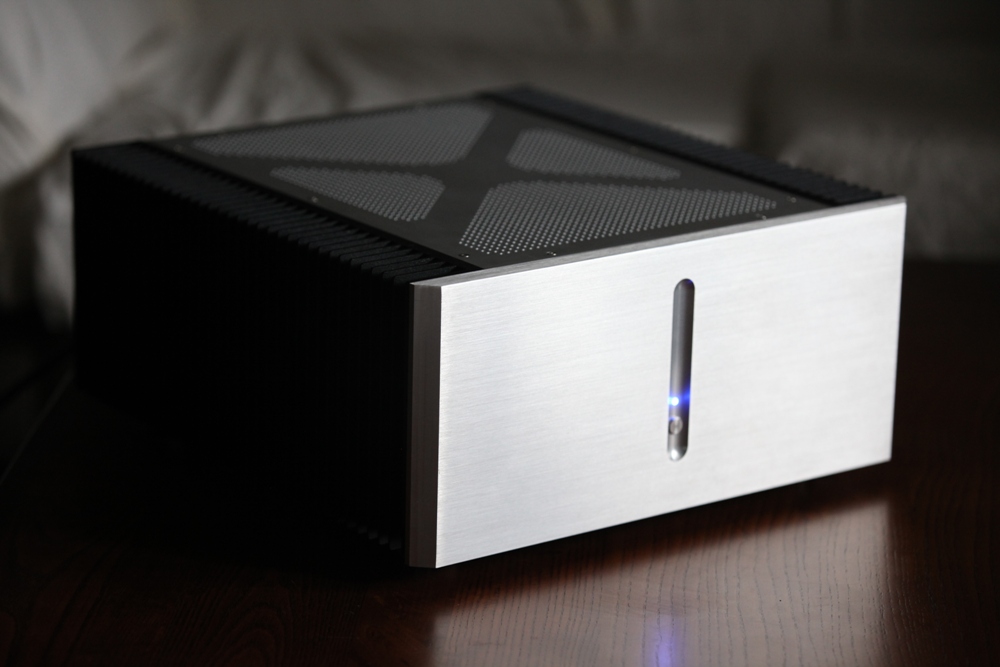

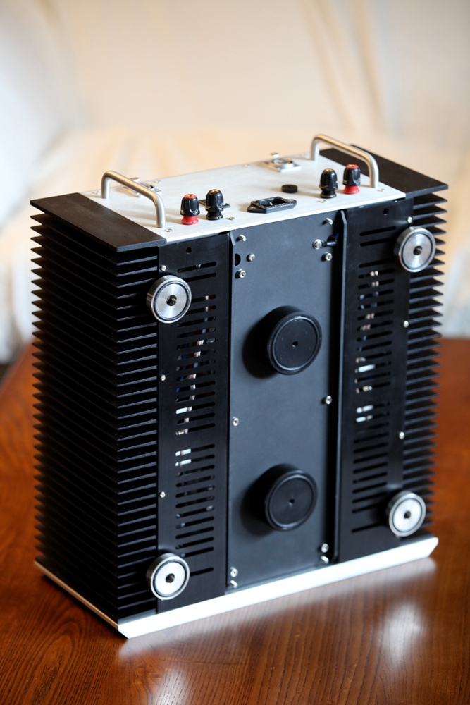

Found these photos from a batch one builder today.
Too nice not to show them.
Patrick
Gorgeous! I was referred to you/these pictures because I'm planning an F5Tv2+cascodes in dual mono. I'd also like to use a soft start board, so my build is getting super-cramped. It looks like you're pretty close to a configuration I'm considering, which is to use the risers sold in the store here to make a tunnel down the center of my 5U chassis for two AN-6224 transformers to live inside, with two full sets of PSUv3 boards mounted on top. The tunnel would be 180mm wide and 300mm long. I could probably use standoffs to put a 1cm gap between the two sections for wiring if needed. I think I could get away with either 90mm or 120mm height. I should have 5-6cm total vertical clearance either way, but I'm not sure if I should give the lion's share to the transformers or the PSU boards. I'm hoping since you're doing something so similar here for the F5X that you could help me plan my F5T and weigh in on the viability of my tunnel. What do you think? Thanks either way!!
