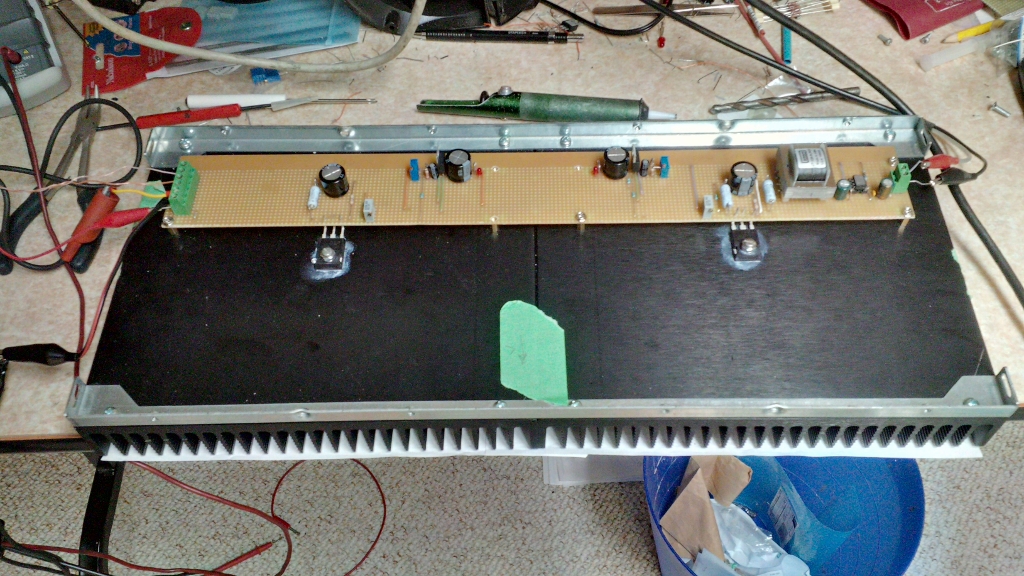

Just ordered all the bits For F6 AND for the PS from Mouser ... Using the BOMs.
Small issue
I don't have a DIY audio PCB (yess forgot to order it along with the F6 'kit')
So... Not overly keen on the 20$ Postage.. for a PCB.
Any obvious problems using the Schematic on a Perf board and wires?
Only a Transformer and a pair of Heatsinks to go.
Small issue
