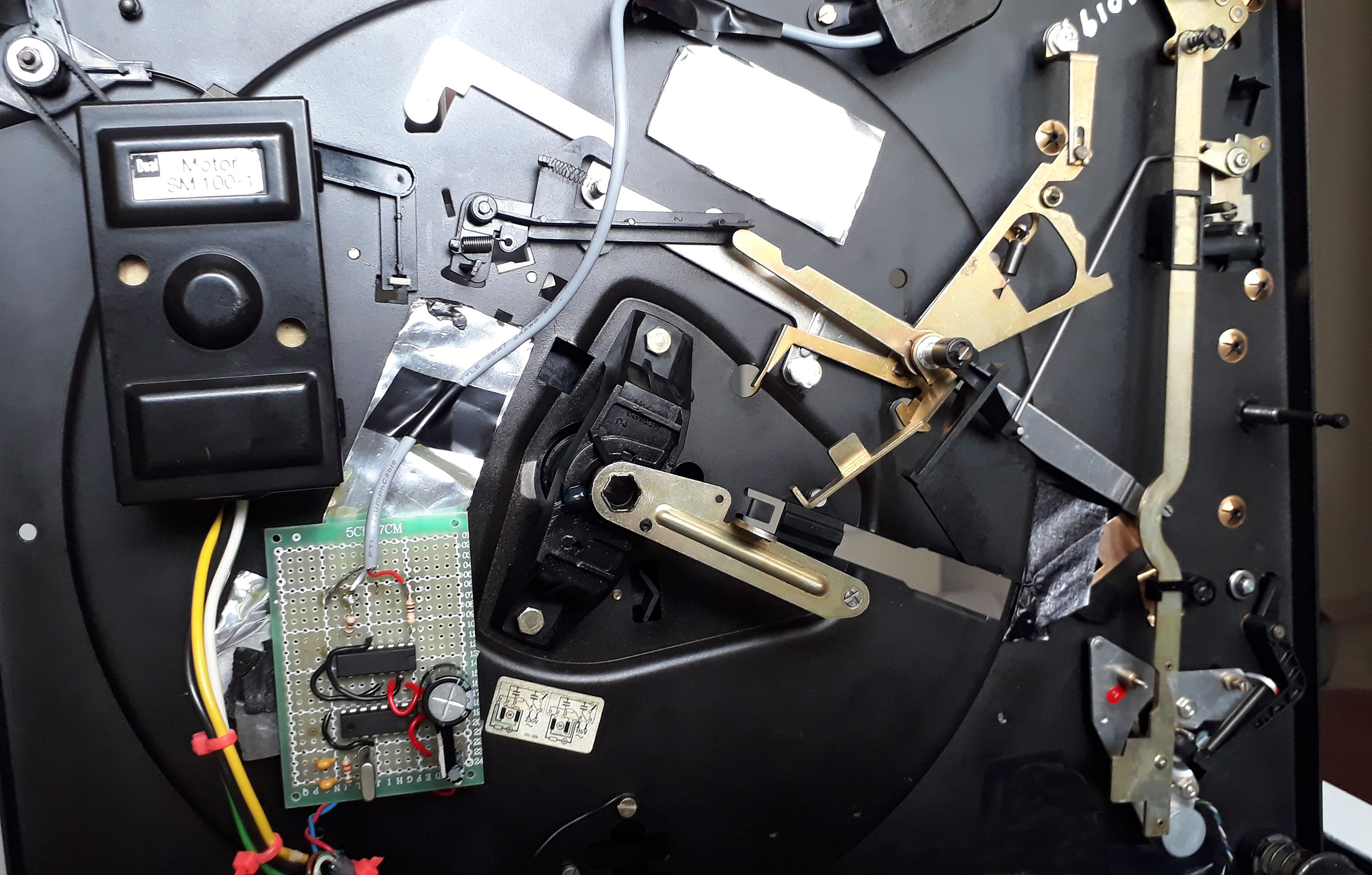

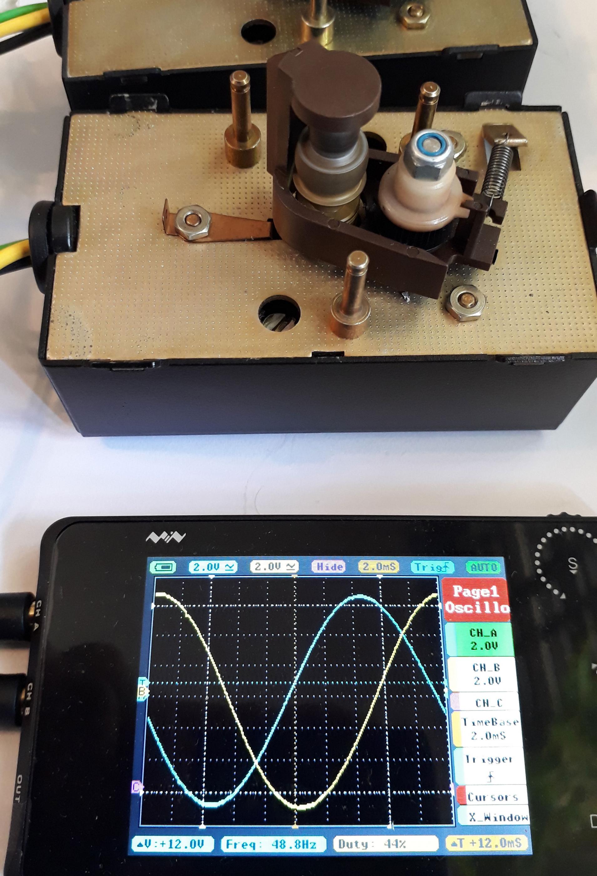

I am not at all pleased with the amount of vibration it exhibits now, despite all the adjustments and lubrication done... 🙁 Many TT using AC motors has this defekt , so to speak.
I am trying out a Nidec PMDC using a more stable PWM. I am still investigating the settings. The PMDC has much less vibration, but makes a lot of whining audible noise 🙁.
I have completed the upgrade.
Here is the thread on 'Mango' a Lingo clone of pure sine wave power supply.
The optimal delay was not 90 degrees, but 120 degrees for Dual Synchronous motor. Motor has virtually no noise or vibration:
Synchronous Motor Driver for Dual CS522 or CS505 using SM100-1 motor

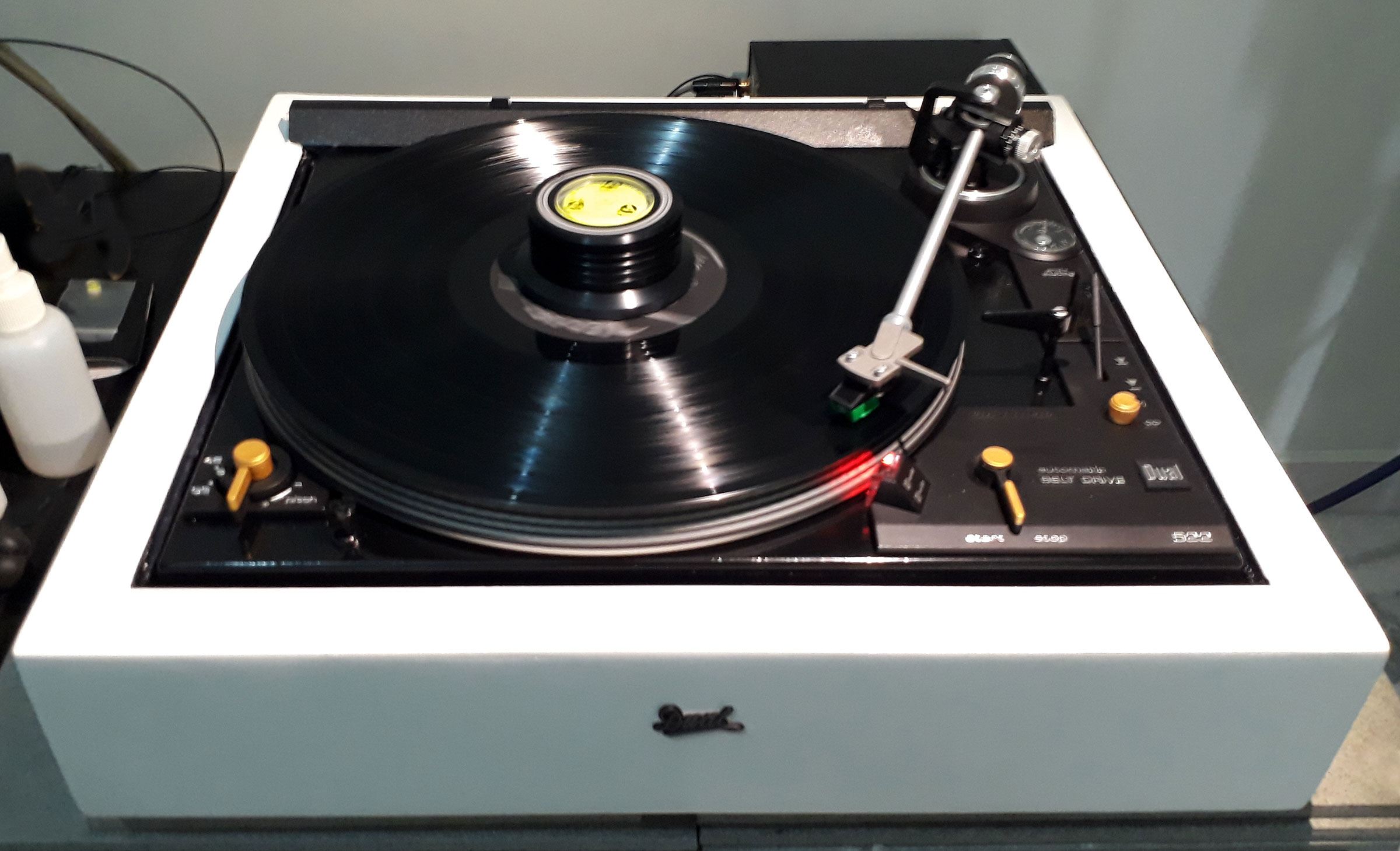

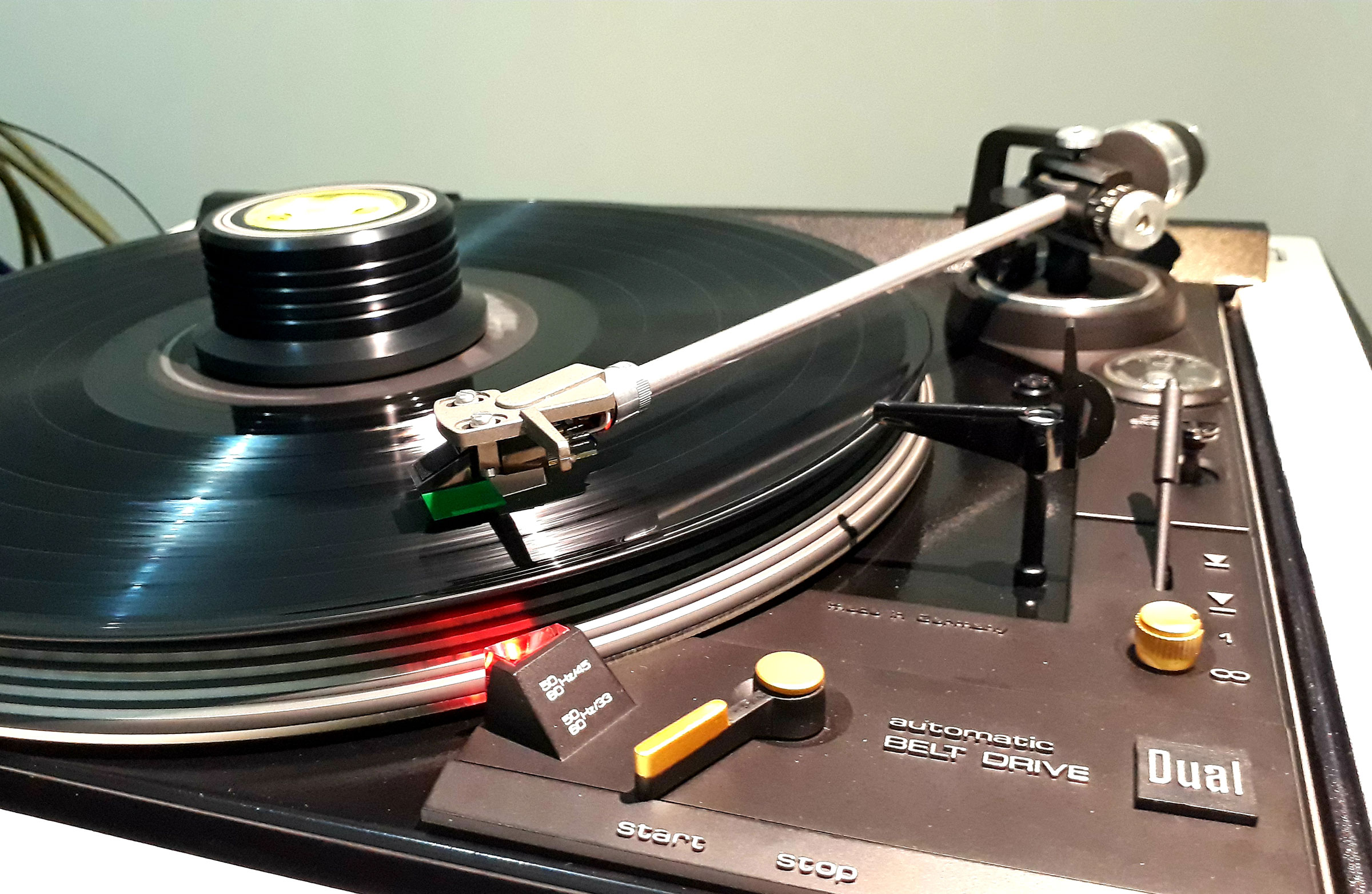

This is the completed CS522 aka using CS505-4 tonearm
Despite the lightweight tonearm prefers a high compliance cart like Ortofon OM10 or OM20, in actual listening, it works extremely well with a AT95E during setup and trial.
I will be putting in a AT95EX needle on the cart.
Simplified the mechanism of the CS522. I could have it as a semi auto start.
The Stop function is not desirable because the long alu arm is interfering with the tonearm segment free movement.
The 5 X 1.3mm ball bearings have been upgraded by 5 X high precision ceramic balls.
Together with the high viscosity adhesive oil from Japan (chain saw), the platter rotates very well indeed.
