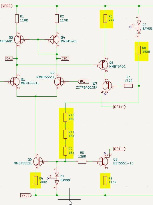

R9 and R18 have to double in value to keep dissipation down.
I would expect all the emitter resistor to scale up a little, maybe x1.5 or the transistors will cook

I would adjust all the highlighted resistors for higher supply voltages. The chain of three would have to be much higher values, the others a little higher to avoid frying the transistors
