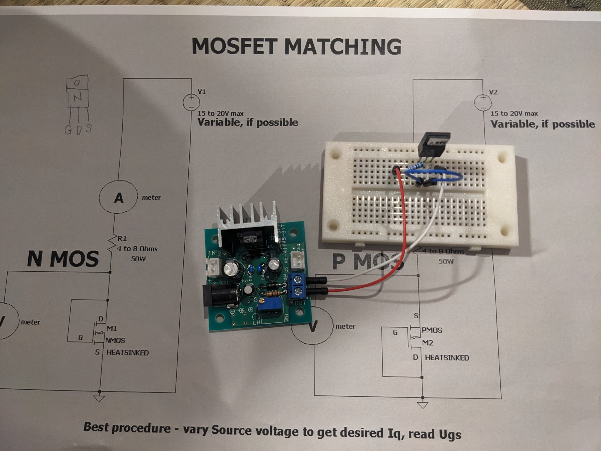

I saw seller's fet analysis but 2sk2013's Vgs-id looks weird.
2SK2013:Vgs = 1.782~1.970V Id = 5.00~5.05mA
2SJ313: Vgs = 4.029~4.256V Id = 4.95~4.98mA
From datasheet,2sk2013's VHS must be around 2.5v.

I have measured a lot of these FETs. For Id=40mA, most of K2013's Vgs will be around 2.1V-2.2V and J313's Vgs will be around -2.0 to-2.1V.

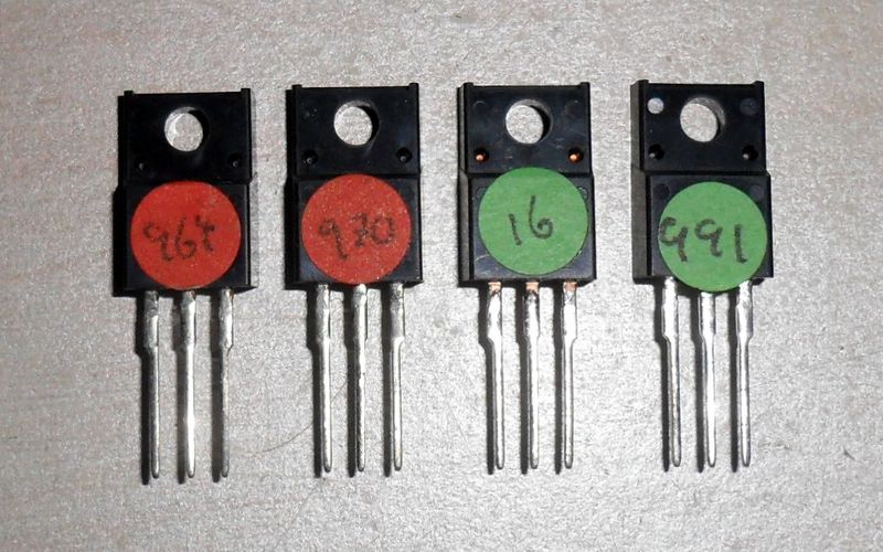

The pictures in the auction are too blurry to tell if they are fake or genuine. I have seen a lot of fake devices on Yahoo’s auction, sadly. Attached photo shows the genuine K2013/J313.
Hope this helps.
