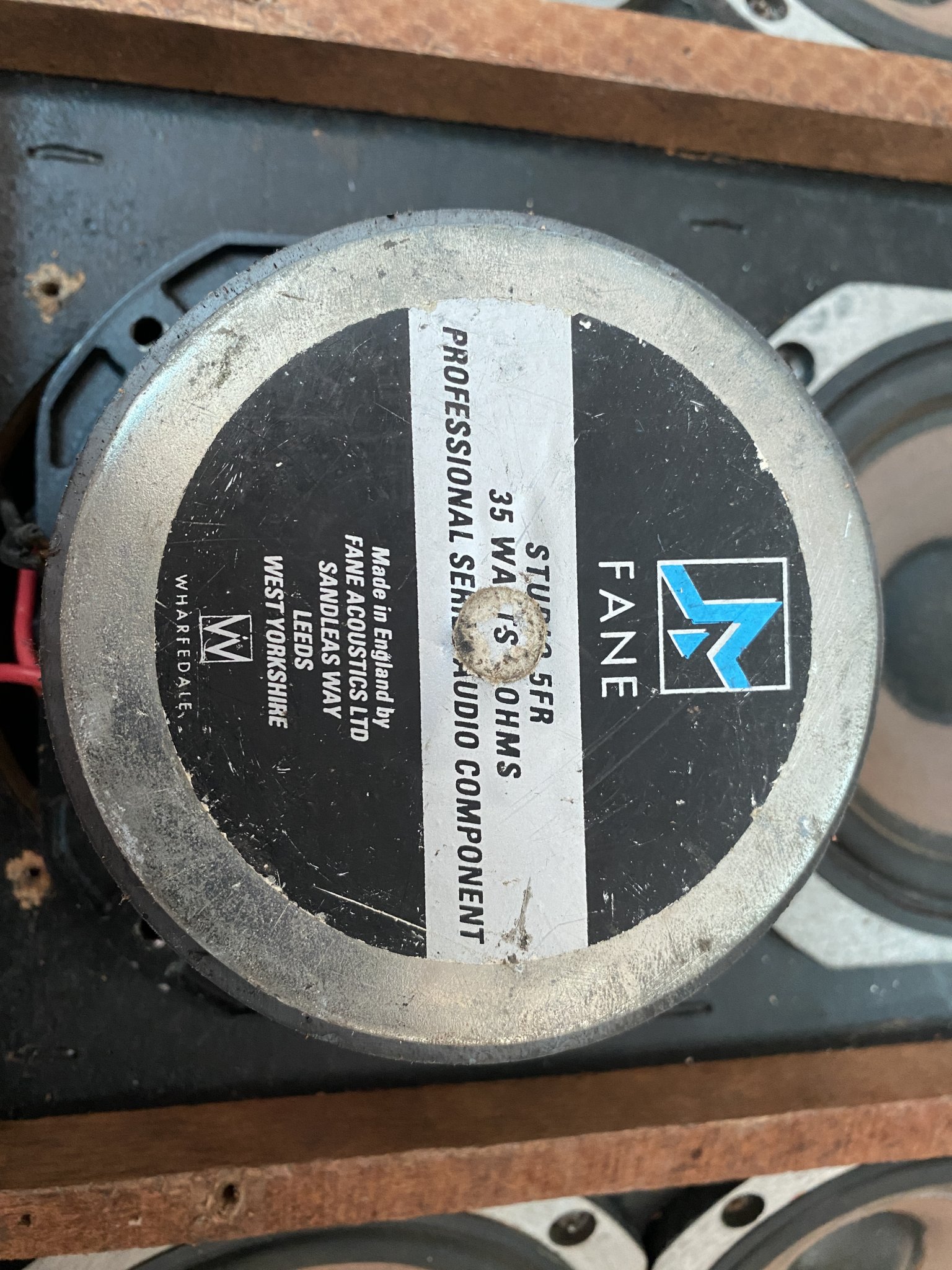

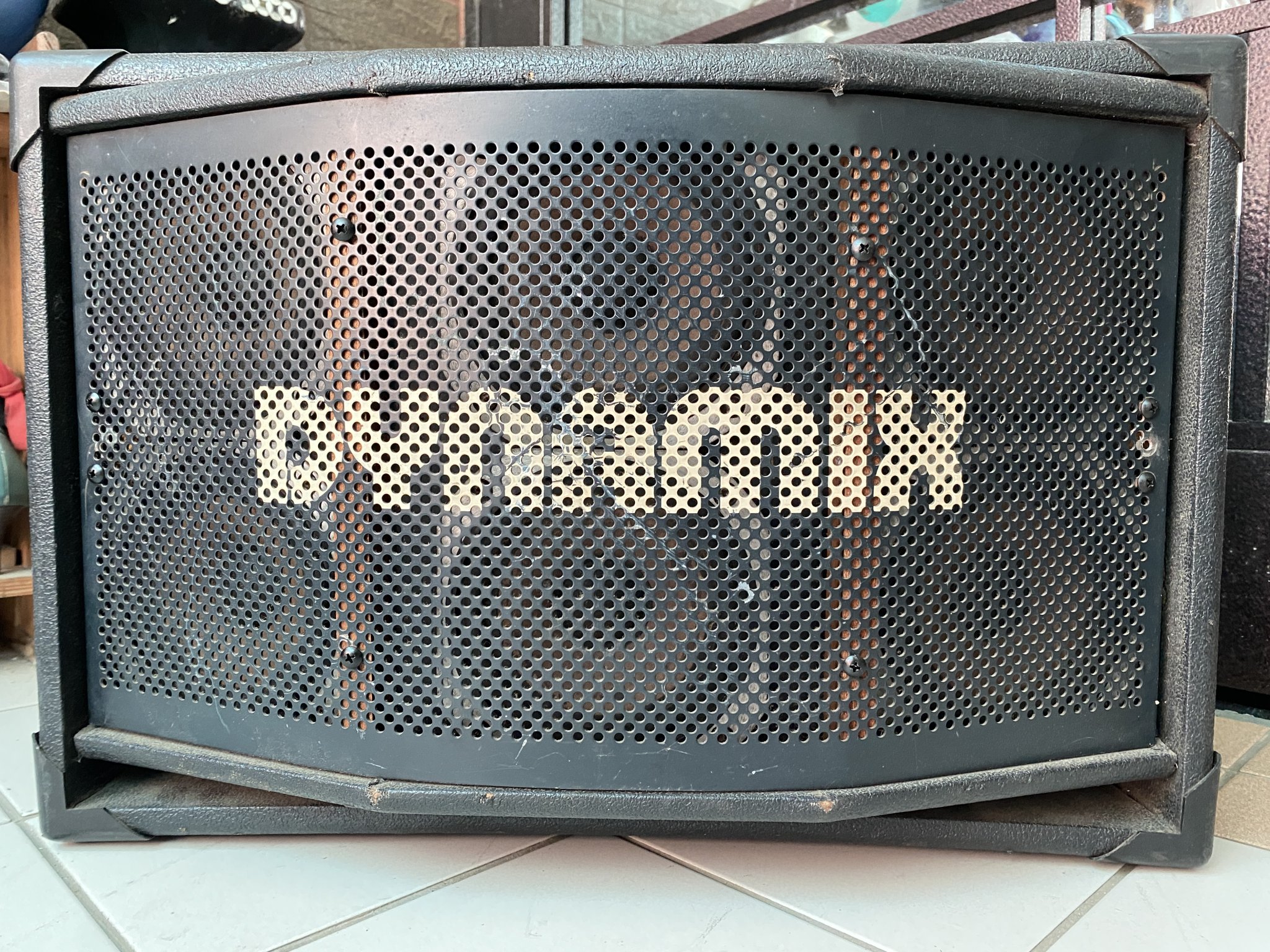

Yes, sadly this unit was discontinued an age ago and it specs/ TS parameters are not to be found online. However, it was used as a direct replacement for the Fane which had a more expensive die-cast frame. Dynamix probably had the Celestions , with a lower cost pressed steel chassis, made for them as a direct replacement for the Fane and the spec's are therefore assumed to be more or less the same. Same cone, same surround, dust-cap and magnet size. The pressed chassis is quite adequate.
I have examples of both and they do sound much the same in the same enclosures.
Why not simply buy a pair and experiment. They are good and not easy to find now.

For FANE's Studio "5M" there are a lot of suppliers for foam surrounds - e. g. this one:
https://www.repairyourspeakers.com/...am-surround-for-speaker-repair/a-393-20000073
But I am looking for a rubber surround suited for FANE's Studio "5FR".
Where are this suppliers ?
From a member I have heard, that the
https://www.diyaudio.com/community/...d-fountek-neocd1-0-impedance-matching.307241/
https://www.madisoundspeakerstore.com/approx-5-woofers/silver-flute-w14rc25-04-ohm-5-1/2-wool-cone/
Silver Flute W14RC25-08
should be a very good (nearly perfect) replacement for FANE's Studio 5FR - go tohttps://www.diyaudio.com/community/...d-fountek-neocd1-0-impedance-matching.307241/
