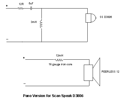

I found this from post #115
12 MH on woofer (iron core type)
12R series on Tweeter
2.7 - 4.0 MH Tweet shunt
5 to 6 MFD Tweet cap (Flavor to suit taste).

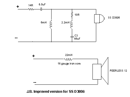

The Manzanita SS D3806 solution
As many know this basic design has been around a while now... the original built on a whim of sorts to validate an idea I had about a viable stand mounted OB with a baffle size roughly equivalent to the larger Monkey Coffin designs of the 60's & 70's (large stand mounted 2 and 3 ways)... think AR3, Large Advent, Yamaha 1000 and JBL L-100. My goal was a simple system in terms of wood work, size, two way layout if possible, low cross over part count.... usable bass into the 30's, easy to drive, a reasonable efficiency (for a small OB), able to play at mid 90's db levels with 6 db reserve using off the shelf components. And of coarse keeping the raw materials price reasonable at less than $150 per system... plus some sweat equity.
The original design was a two way based around the venerable Scan Speak D3806. On the low end the new at the time Peerless 830669 looked to be perfect. But at that time the D3806 shot up from a wholesale value of $56 each to over $100 in the span of a few months and stock was limited. There were rumors that the purchase of Scan Speak by Tymphany could result in the 3806 being discontinued. So I switch to the also "venerable" Seas 27TDFC. It was lower in cost and with the correct crossover tricks could play safely down to about 1,300 Hz. I could make that work... but the D3806 could go down to about 850 Hz. Some crossover and performance changes and compromises were made to create the original, field-able Manzanita using the TDFC.
I have since move up to the D3806 and now that it is available again... Tymphany DID discontinue the D3806 but now that Scan Speak now owns Scan Speak again.... a crossover suitable for the D3806 is now of use. Keep in mind the D3806 is VERY expensive.... like a couple of hundred EACH by the time you get them home.
There is no one ideal solution... variables like the size of room, back wall distance, available power... near field vs. distant field listening distance preferences and so forth need to be considered in the final crossover configuration. Pretty common stuff. To my ears... the best over all utility set up... assuming a 48" distance from the rear wall and at least the same from any side wall(s)... with the speaker on a 24" pedestal.... I use the following crossover.
Woofer.... 16 Ga.. iron core inductor.... 20-22 MH in series.
D3608 Tweeter.....
Series Resonance trap across the tweeter terminals.... assuming a resonance of 370 Hz. which is typical: 60 to 70 mfd + 2.25 MH + 10 ohm.
Tweeter series padding resistor of 14 ohms ..... and series cap of 6.5 MFD and a shunt inductor of 8 MH to complete the 2nd order electrical... which with the tweeter's natural roll off becomes 3rd order Acoustic. You can vary the shunt inductor from 3 MH to 10 Mh to get the sound balance that is right for you. Keep in mind... the larger the room and farther from the wall the more balanced the sound and the deeper the bass. Like most OB's ... the Manzanita likes to breath.
As best I can measure you end up around 82 DB/watt... give or take.... and the system will need 100 clean watts per channel to come alive.... 200 is better. A lot of power to be sure... but with power you get some amazing dynamics ... bass dynamics for a small OB design. Some will like a hotter high end ... so the pad resistor can be lowered down to about 10 ohms. As you go down in pad you will need some downward adjustment for the series cap. Suspect many systems will end up at about 12 ohms.
That's it for now.... hope this answers most questions.
