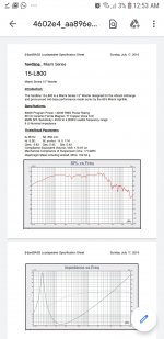

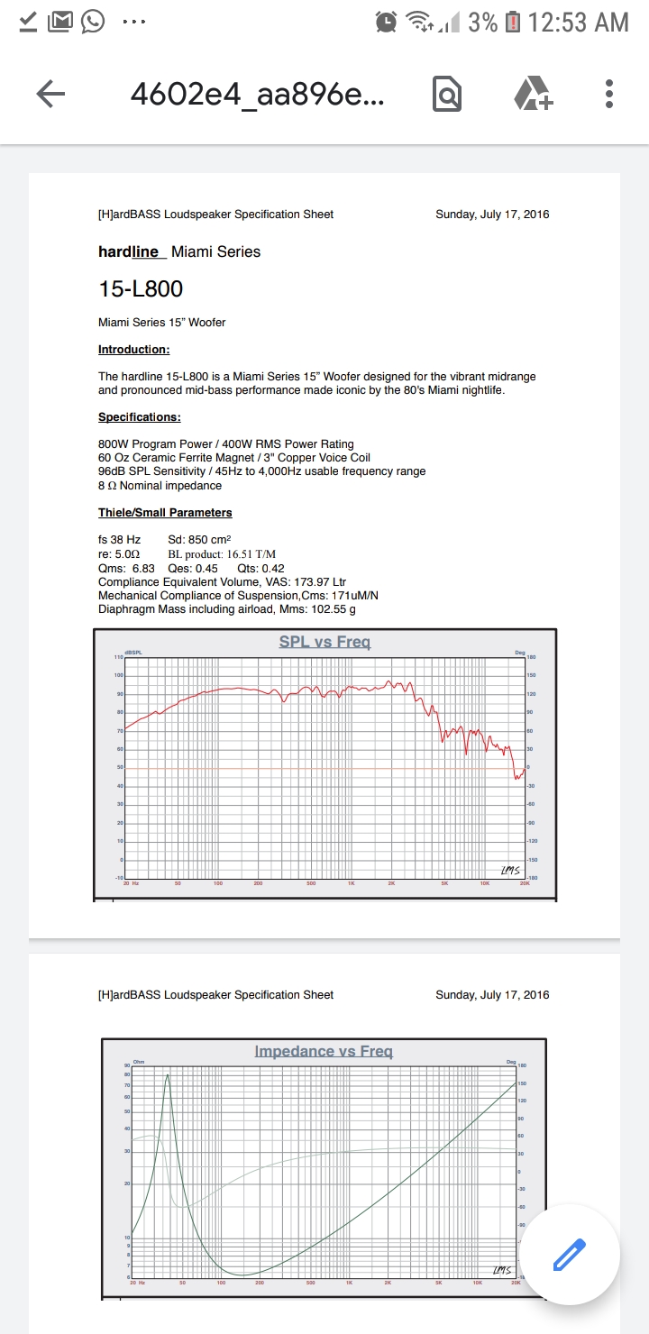

Anyone ever tried hardline 15" subs?

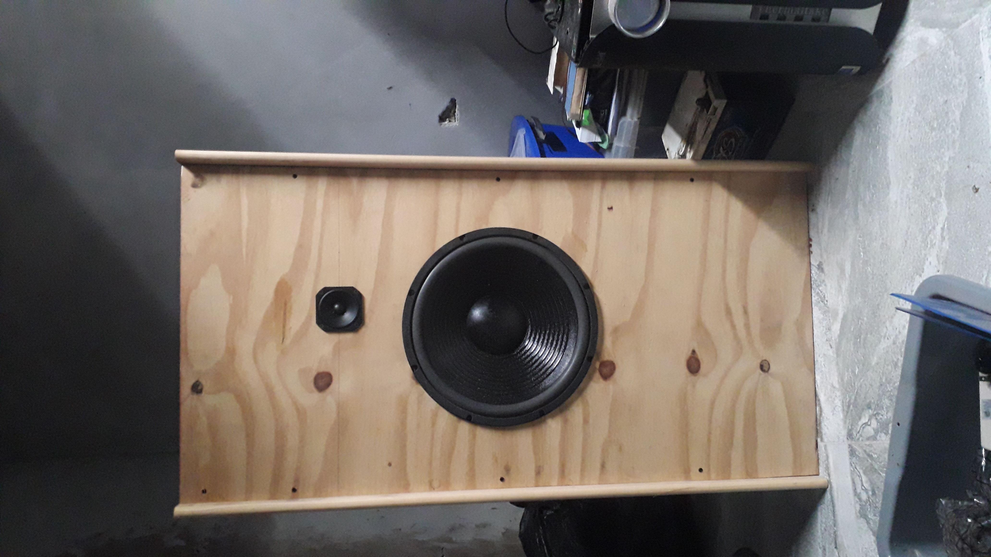

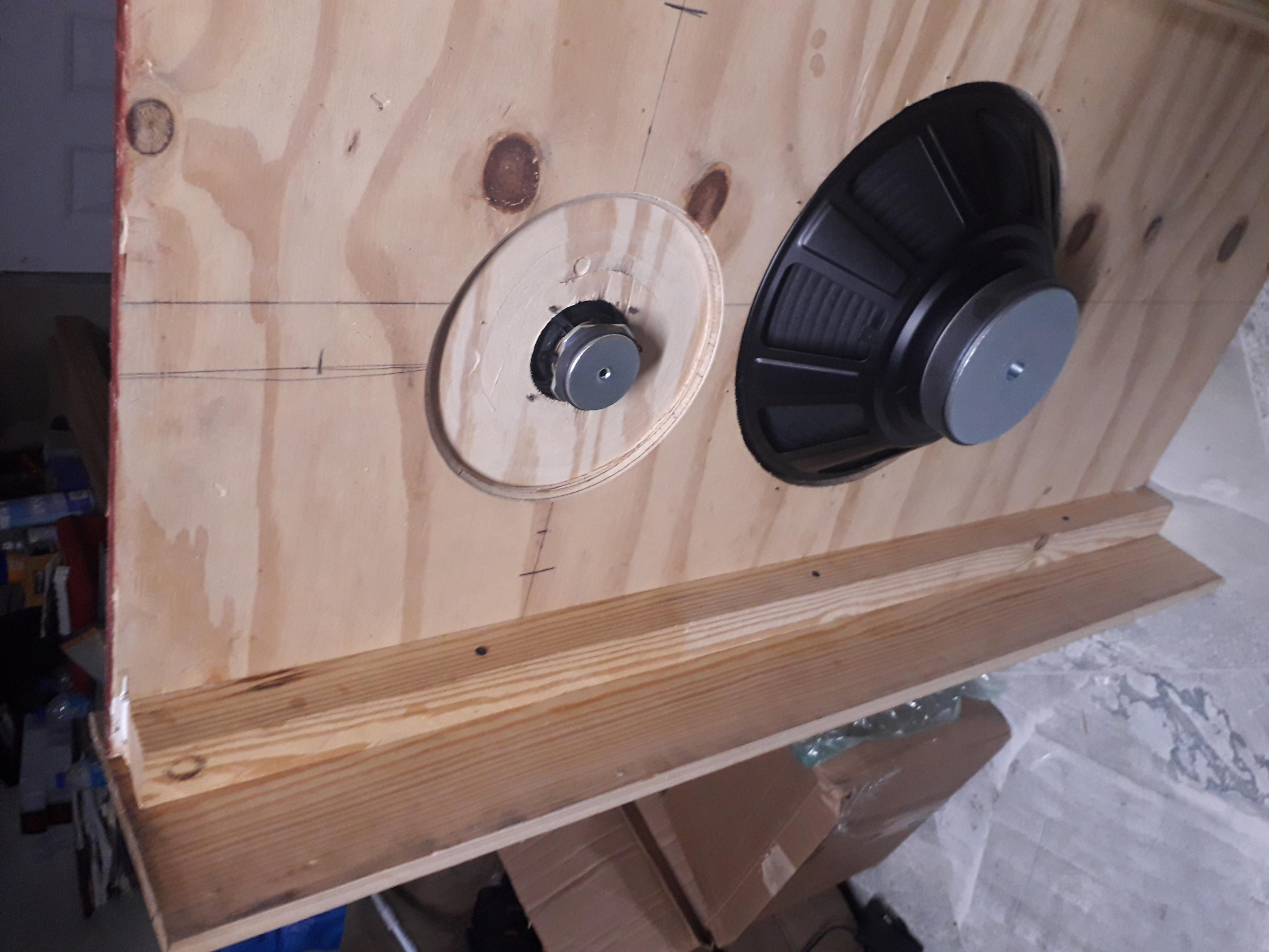

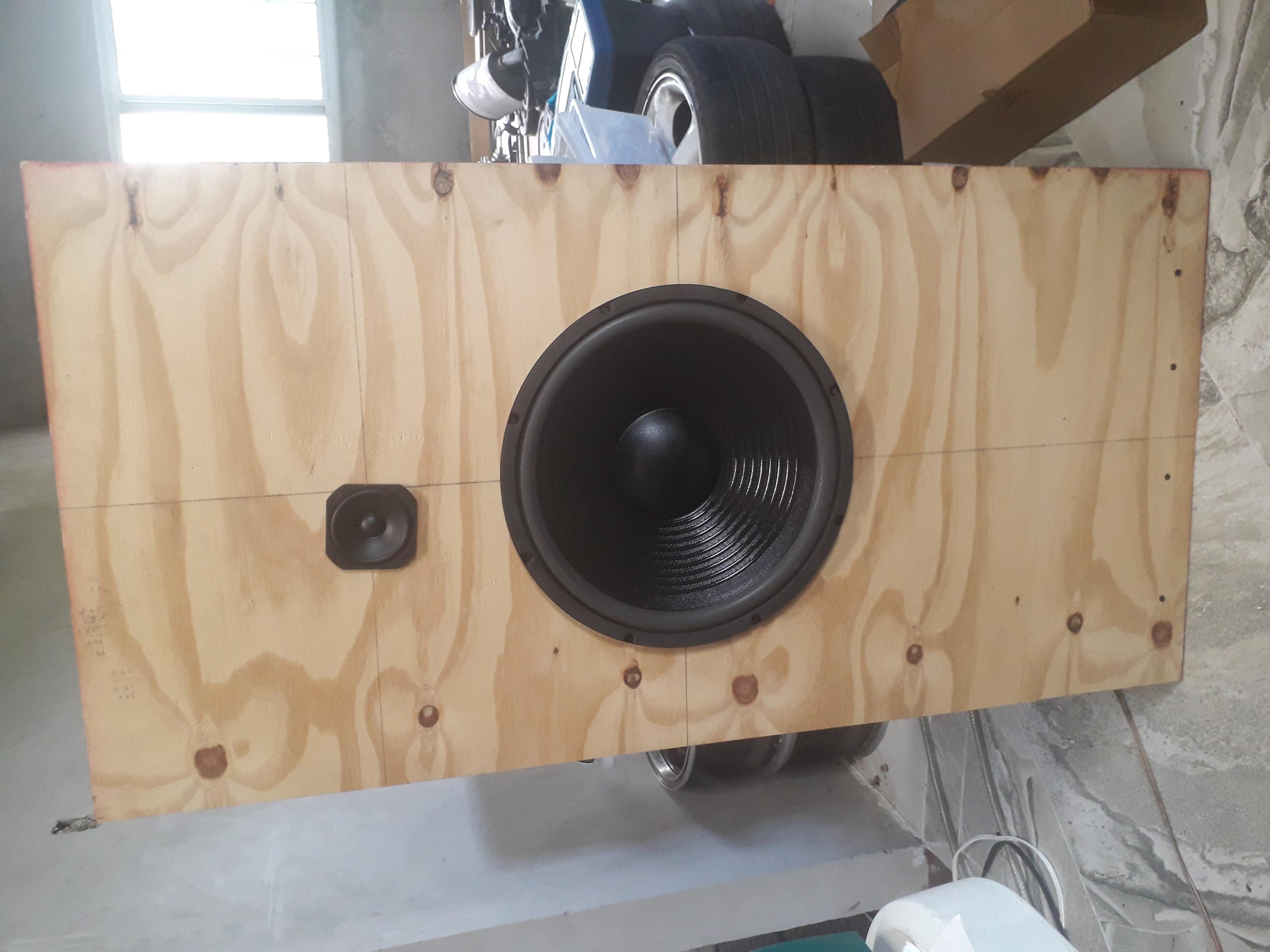

Finally got a chance to finish these baffles. Was on track to make the extended front "wings" but I forgot to account for the baffle thickness. I used it anyways with a 1.5" front wing. Still have to complete a base to prevent it from tipping over , secure the crossover and paint. I found that when I change the resistor on the vifa from 9ohm to 15ohm it sounded a bit better to me.
Listening impressions. They are presently hooked up to my pc and I thought they were sounding good until i went and sit on the couch thats behind my chair. Now Wow I found the bass I was looking for. Imagine hearing alot of bass but it's so fast you cannot keep up with it. I guess this is the addictive part. I am presently running it off an audiosource 50wpc amplifier and there is a lot of volume at 3/4. I did not include the bass trap and I could detect some breakup, i plan to add it in the future together with 14 gauge inductors. The speaker can reveal poor quality recordings which I found out when playing music on youtube.
