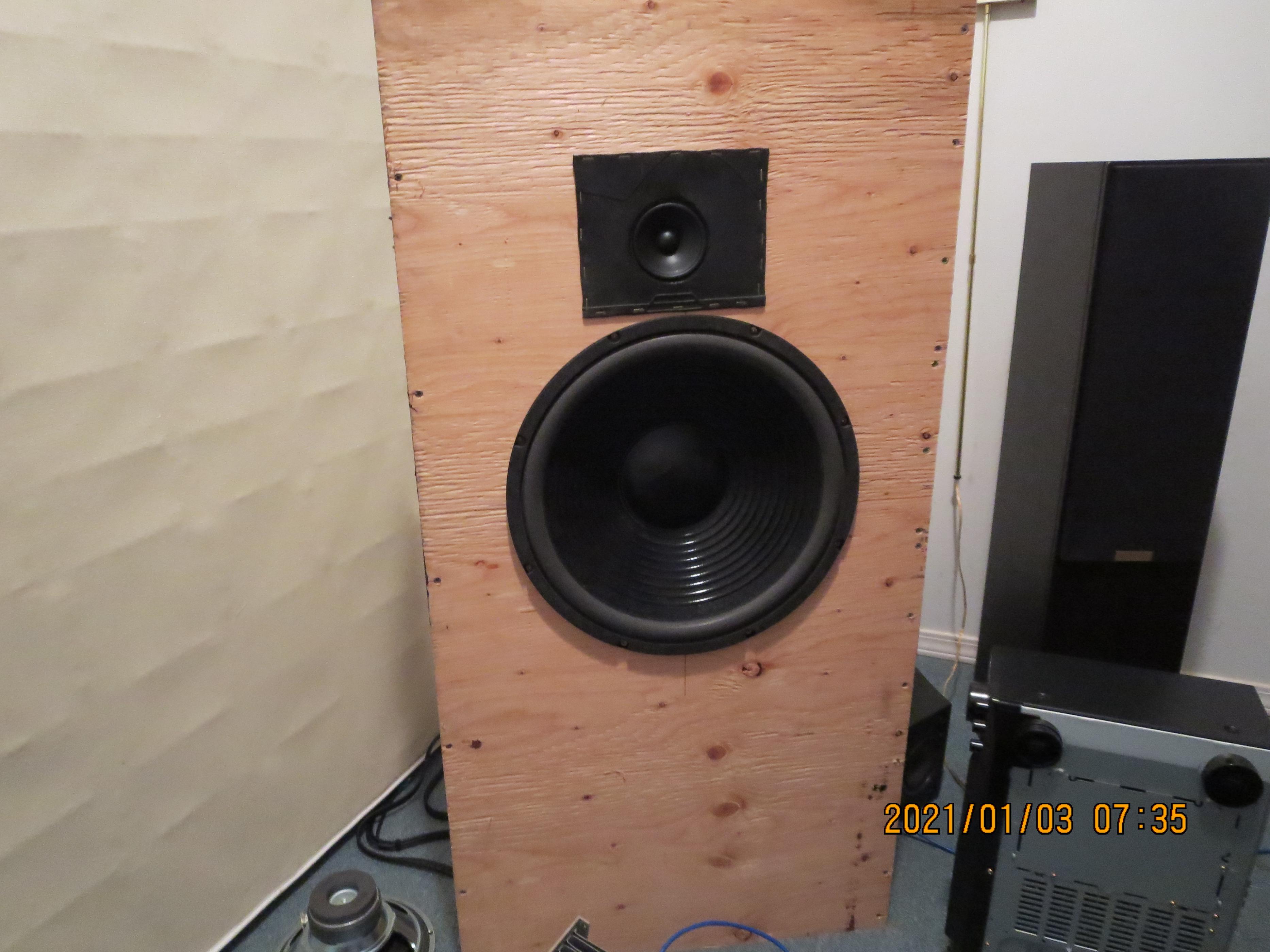

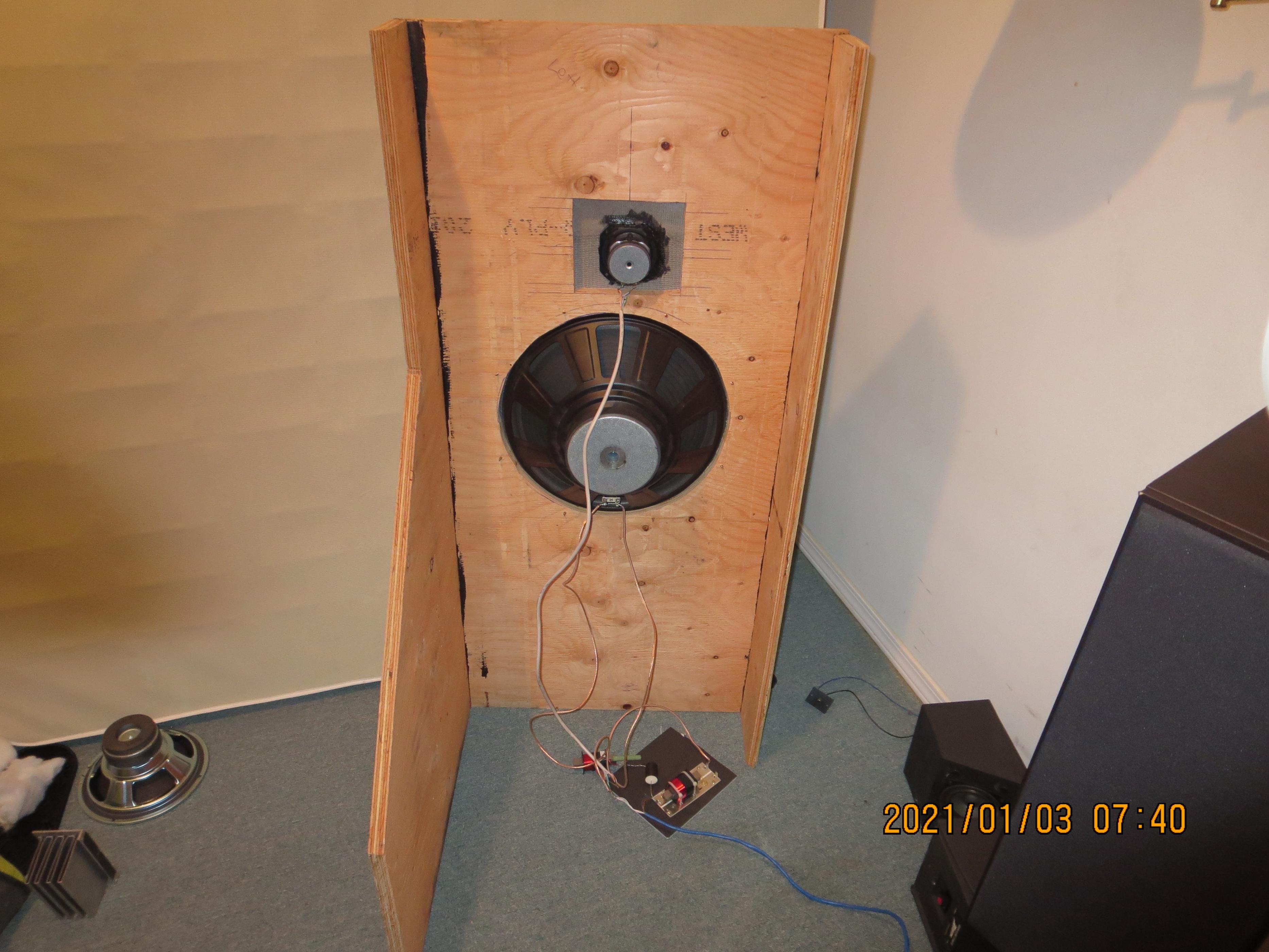

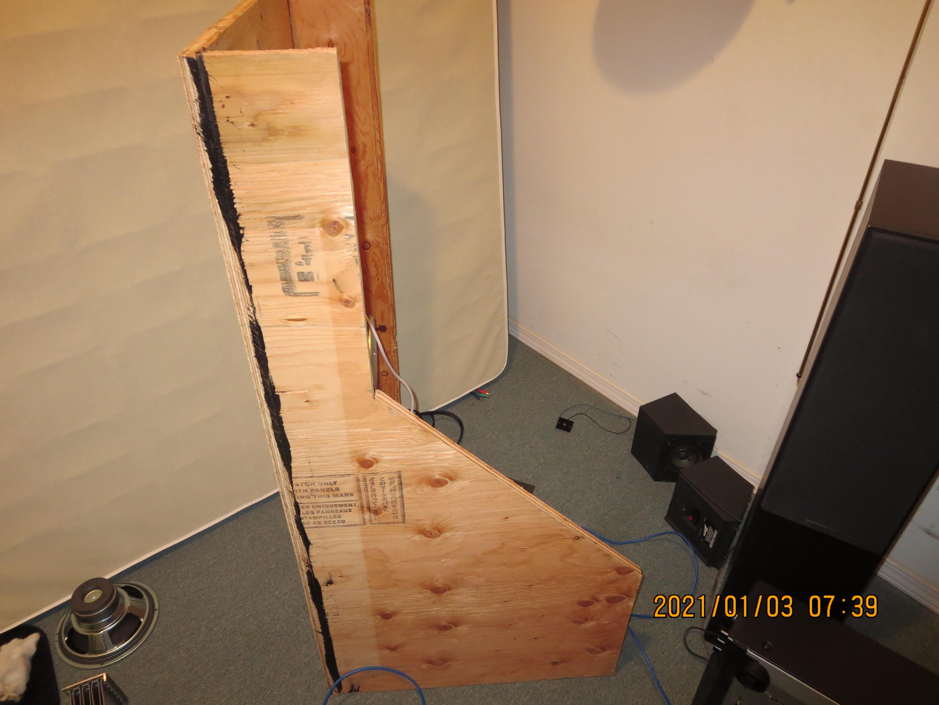

As you can see from the photos I strayed off from the recipe quite a bit. The plywood was cut on 45 degrees from a renovation at work so I left it that way on one wing of the side panels. The other side panel is more or less at 5". The baffle needs bracing and lacks a base. The good is that the exaggerated wing creates an upright support for the baffle.
The crossover is just a rats nest with no real home yet. The Vifa was mounted in rubber from old rubber boots but the driver has tons of room to breath.

Oblix - thanks for the photos and the details of your build. Yes, you can tweak the pad resistor to get the highs where they need to be for your room and speaker placement.
Have fun and maybe you'll like it enough to do a fancy build. 🙂 FWIW, I had a pair made form scrap plywood from a construction site and they worked fine. Not pretty, but sounded as they should. I used them in my lava tube cave.
