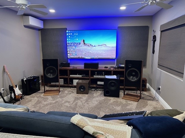

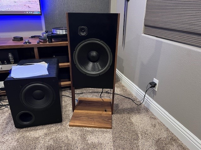

Hey All,
Been lurking on this thread for a while and finally built my own. Here are some pictures. Nothing I ever do woodworking wise goes to plan but they turned out really nice considering. I had to get a nice dowel jig to make sure everything glued together (and stayed together) so some fun learning experiences.

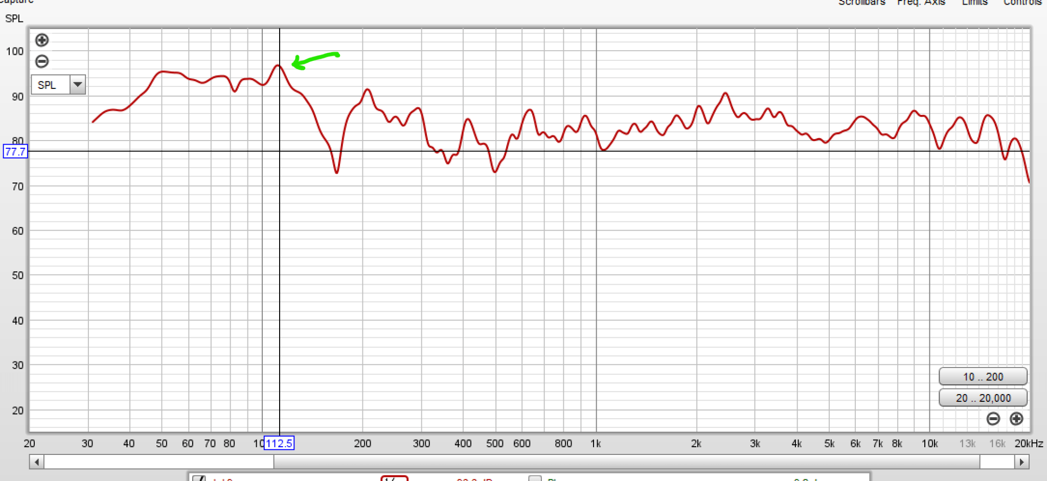

They sound awesome, except I have too much energy in some of the bass. My ears don't mind some of the lowest frequency, but the part right around 100hz, I feel like the baffle and the thin legs attaching it to the bass might be resonating or something.
The measurements confirm the most energy there. If I turn down the EQ around that area it seems to fix it.
Questions -

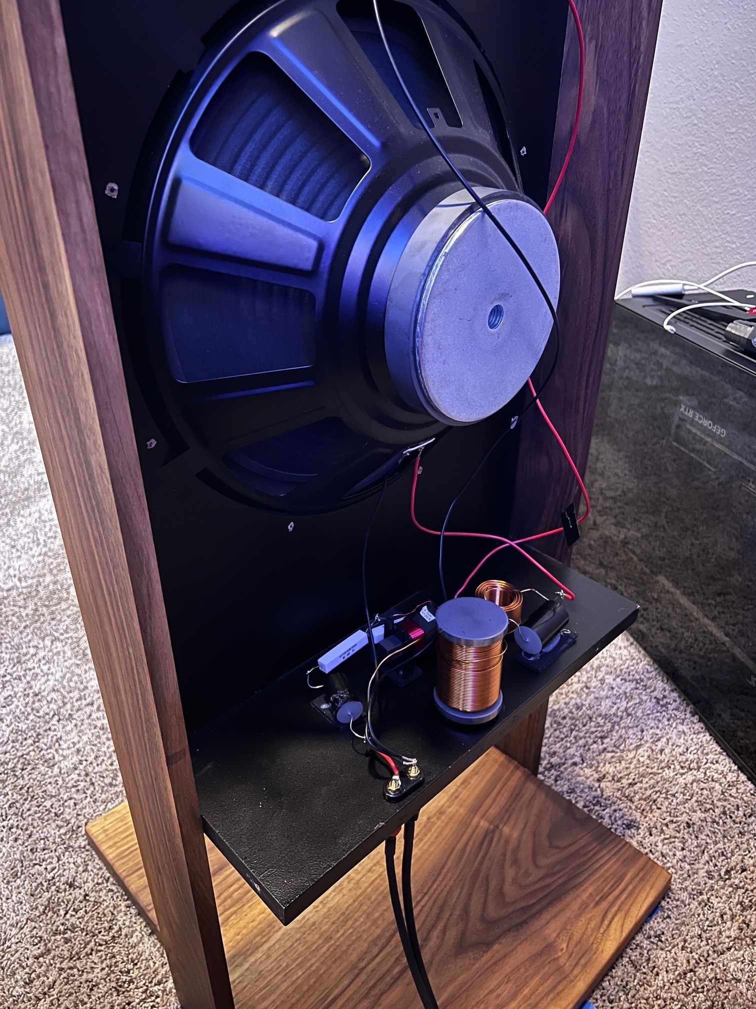

1. Bass trap - I am using it on the crossover, but I measured almost no difference with or without. Is the bass trap supposed to reduce the bass?
2. Wings - I messed up and made the wings only about 3" deep. Critical mistake?
3. Gameplan - I'm going to do proper measurements of each driver then see if I can the excess energy in the xover. Good idea?

The bass trap on this speaker doesn't really do anything in the bass region in spite of it's name. It's there to tame the rising response of the woofer. likely in the 1500 to 2300 hz range. It's been too long to remember exactly where but that's the general frequency region.
The 12" Peerless didn't need it as much but some used it anyway. The 15" GRS does need it. It seems to get a smoother sounding midrange when installed.
As Barry says, the woofer trap is for the top end of the woofer, not really bass notes. The GRS has some trouble at the top of its range and the trap cleans it up. The Peerless is better behaved and can do without it. As you are using the GRS, listen to the midrange with and without the trap.
As XRX says, play with the level of the tweeter, you should be able to achieve a correct tonal balance. Thanks for showing us your build!
They are very nicely built speakers.
You'd think more wing would increase bass but the intricacies of open baffle wing size and shaping is above my pay grade. But before doing too much crossover tweaking it'd be interesting to play with some cardboard and see what a bit more wing would do. Changes in open baffle speakers can be quite entertaining.
And please report back with your findings.
