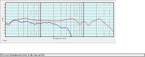

BTW ALL
I bought the Goldwood 15 inch woofer because spec showed a healthy 10db rise at FS (see attached). This to use on open baffle
I measured and it does not have the rise claimed, Its more like 4-5db max.
  • 215_8 DRIVER EVALUATION.pdf
You should be OK with the Goldwood. John Busch see the 18" version, 2 per side in one of his builds. As Barry will tell you, that double GW 18 version was prodigious. :)
With the Goldwood you will likely have to adjust the crossover to fit that woofer. You'll probably start be adjusting the series resistor on the tweeter to get it to match the level of the Goldwood. You might also need a different trap on the woofer according to where it's breakup peak is.
