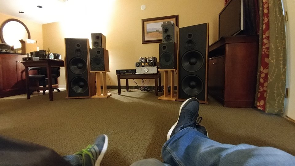

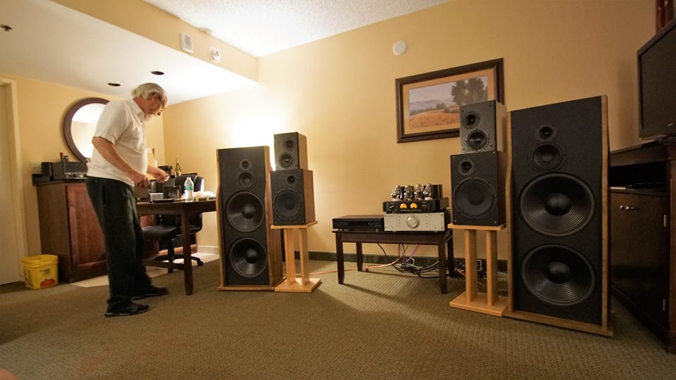

Here are a couple of photos from John's room at the Lone Star show. These pics were pilfered from Facebook.
The big OB's were fine. Probably pretty similar to the Ultra Plus's John brought about 3 or 4 years ago but in a smaller footprint. They can move some air.
The boxes were surprising as they didn't sound small or shy and had the dynamics thing down cold. Even the tiny ones could thwack.
It was a good show.
It was a good show.

Would like to discuss the new speaker, but as it is intended to be a commercial product, I don't feel right about discussing too much as this is DIY.
The basics are pretty obvious from the pictures. A 3 way with dual 15 inch subs on an asymmetrical "H" frame, 6.5" mid-bass / mid Range pretty much OB, and wave guide loaded tweet. Passive crossover. My attempt at getting full range performance with decent efficiency from the smallest foot print possible with out resorting to custom drivers. It was well received at LSAF last week and some have been ordered.
Hope that will be enough without abusing the forum.

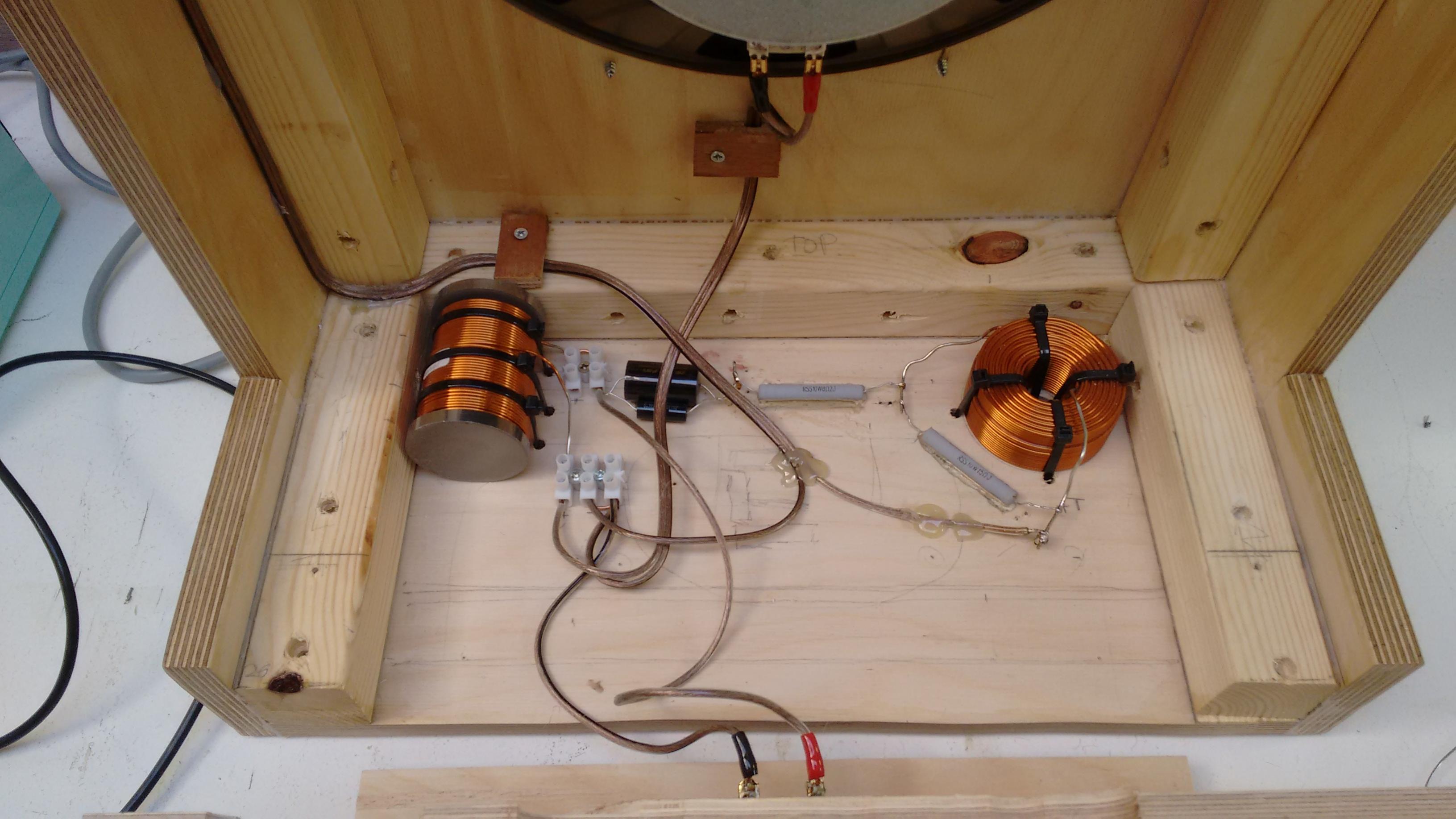

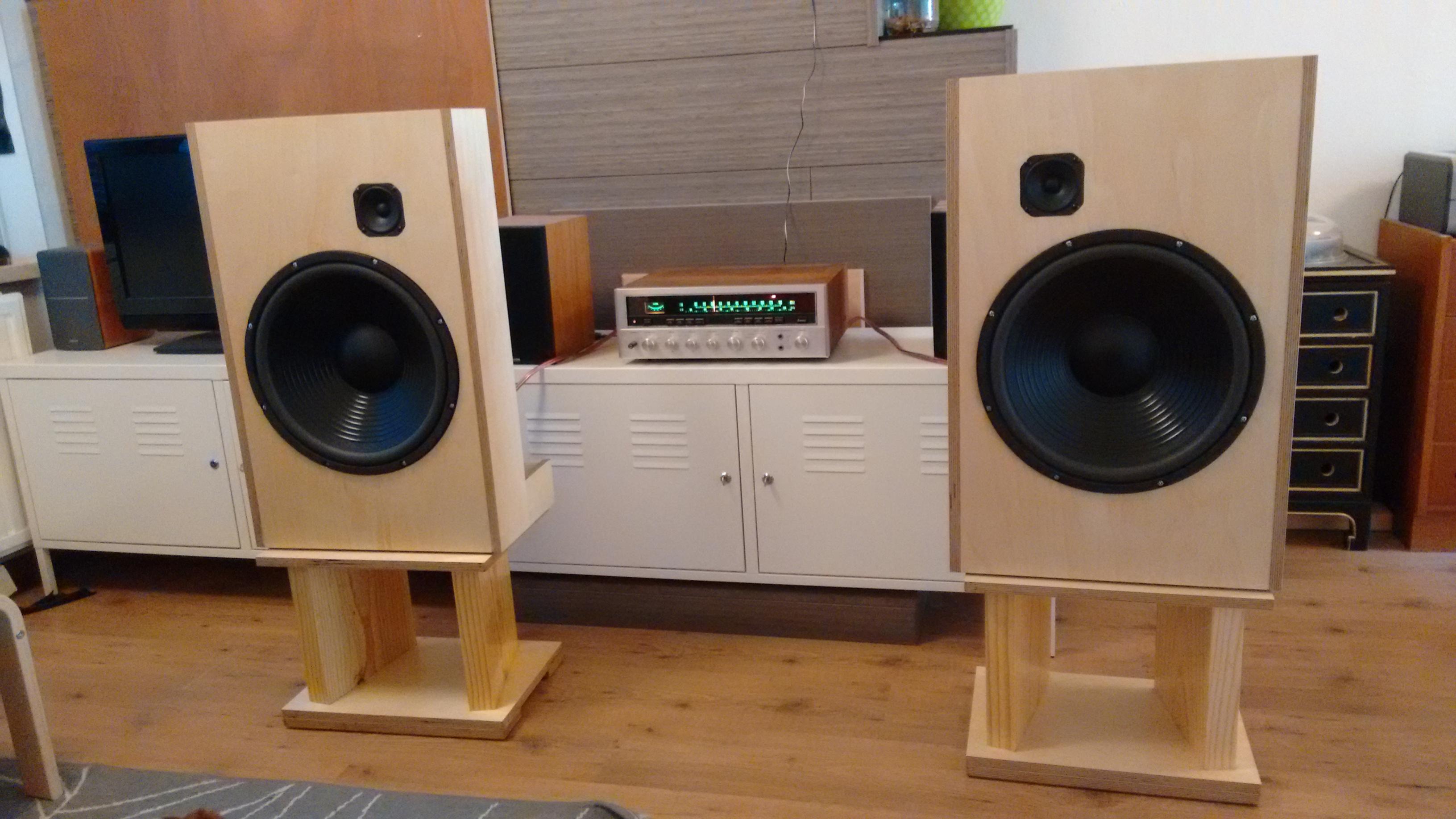

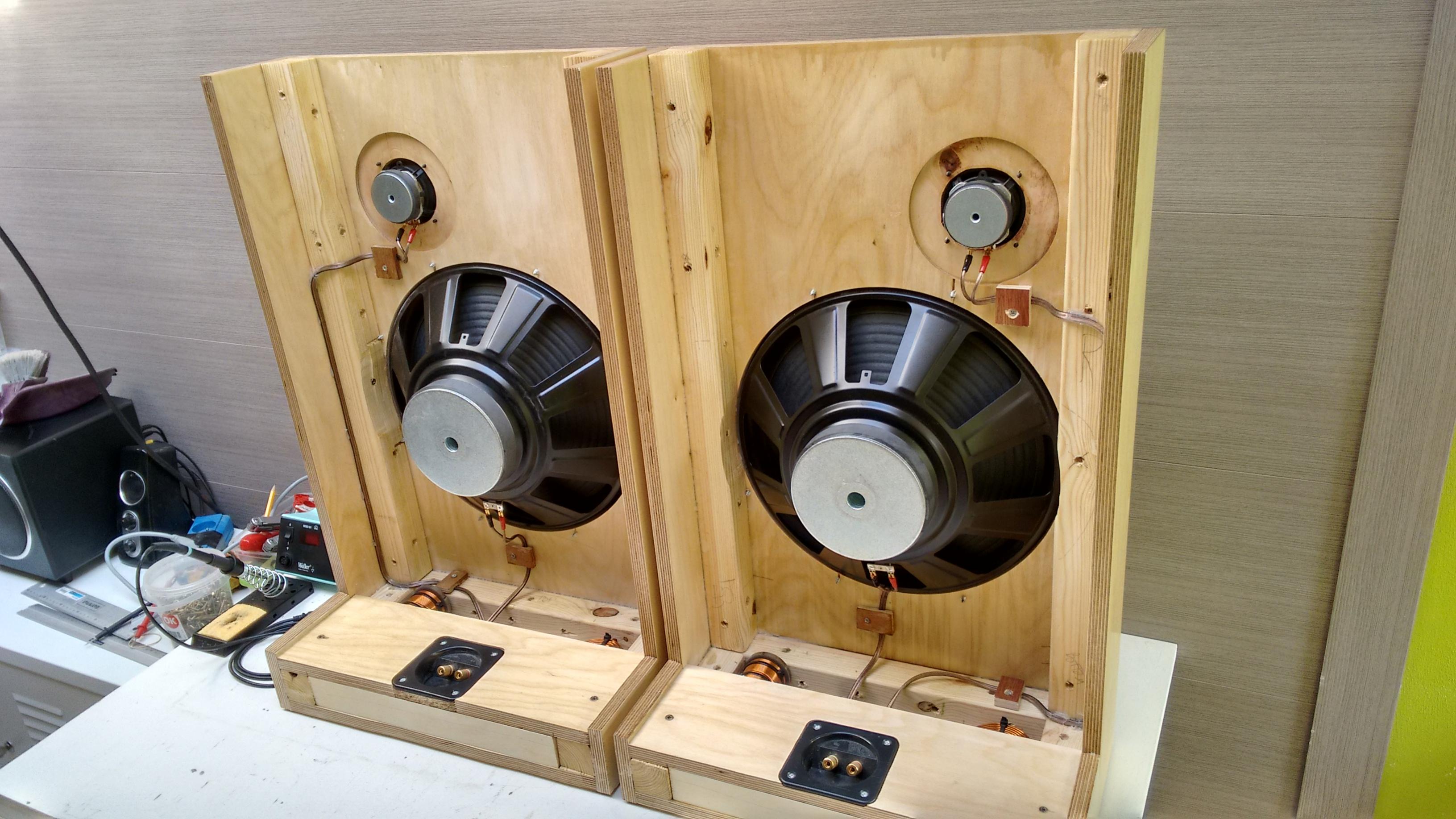

I have finished my pair of manzanitas. I made the regular manzanitas with the GRS woofer.
It ended up costing 450 euros (importing grs woofer from US to Belgium was not cheap, I did buy 2 pairs of woofers and sold one pair to a dutch guy who is making a pair of manzanitas at the moment 🙂 ).
I used birch plywood and treated them with hardwood oil. They look amazing, the most cool speakers I have ever owned.
I used 6uF capacitor (5.6+0.4 together), 8.2ohm pad, 15ohm trap

-big soundstage
-amazing bass (the best I have heard, especially with blues music and music like the white stripes, also acoustic instrumental sounds great).
Things I dont like:
-the 100 - 200 hz region sounds a little recessed
-my neighbours are not happy with the bass (I live in a small row house with neighbours at both sides), I might sell them for this reason to make something smaller
Maybe the sound will improve with breaking in.
Anyway I am happy with the build. They sound amazing with certain genres of music. Thanks for the design of the speakers.
