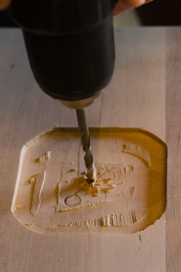

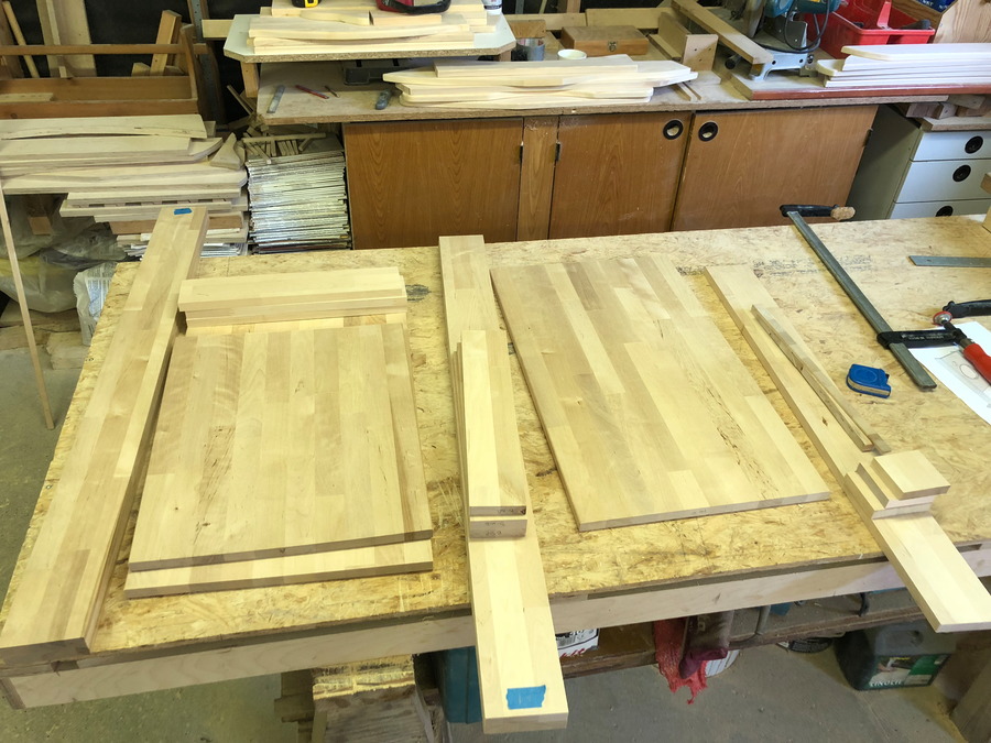

I came right back to a busy work week so i only just had time to sort through the pictures and pick out some good ones (see below):
The first challenge (after getting the wood cut by our friendly neighbour for a few bottles of wine) was to figure out the rebate to flush mount the Vifa. After some experimentation i think we managed something decent
Finished baffle. I decided for a relatively shallow rebate to fit the edge of the woofer (which curves down towards the outside). A mm more would also have worked. Note also: don't try to route 18mm beech in one go, you will break the bit 🙂

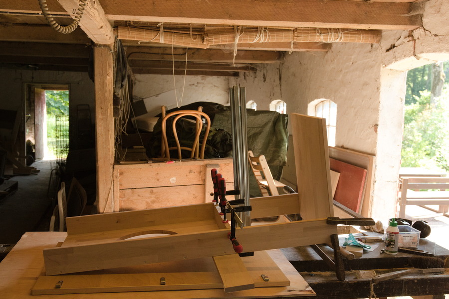

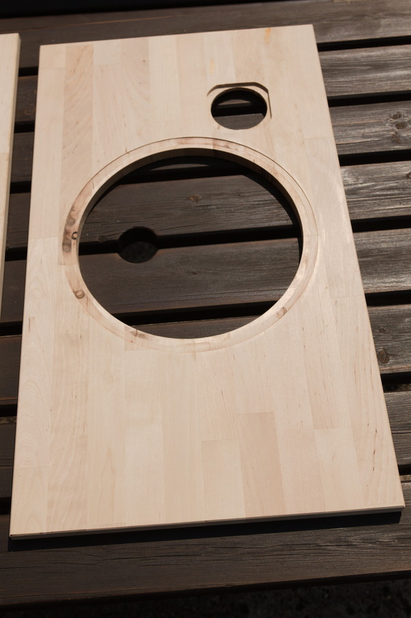

Gluing up. We decided to use both screws and glue, and i think that came out nicely and quite discreet.

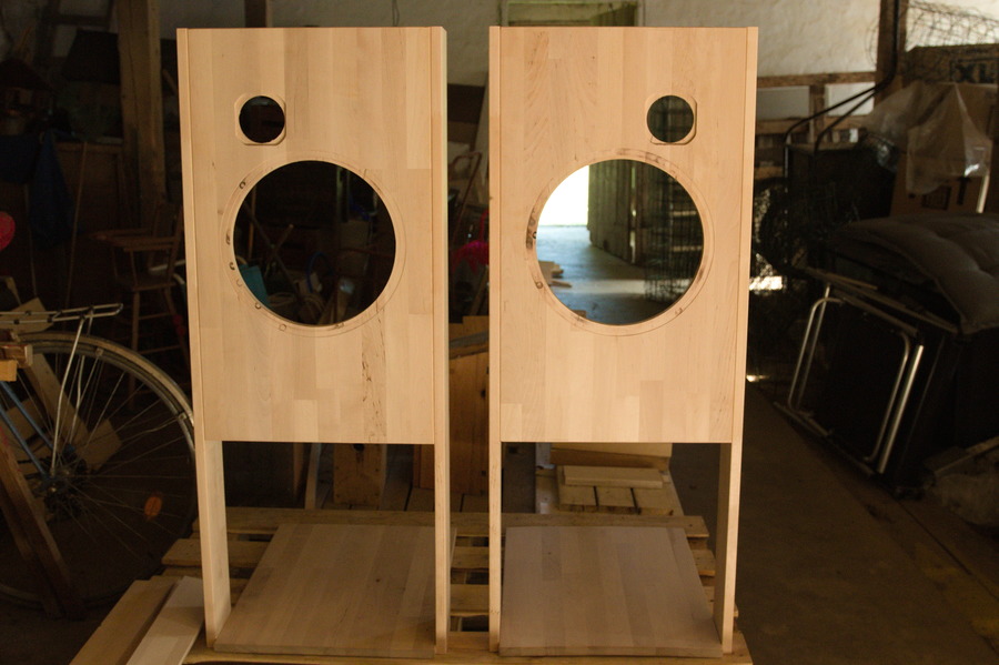

Finished the wood part. We made the base extra long as we didnt know where the centre of balance would be exactly. 20 cm could easily be removed as they are very sturdy.

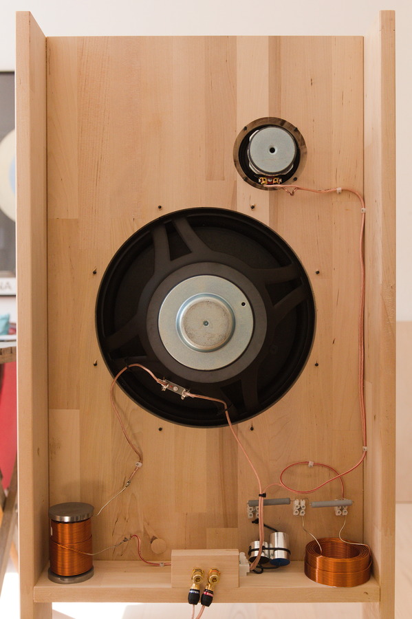

finished speaker with crossover and drivers mounted. Caps are claritycap esa. I couldnt get 6 µf so i paralleled 5.6 and 0.33. I also bought another 0.33 which can be added later if needed. The coils are Jantzen.

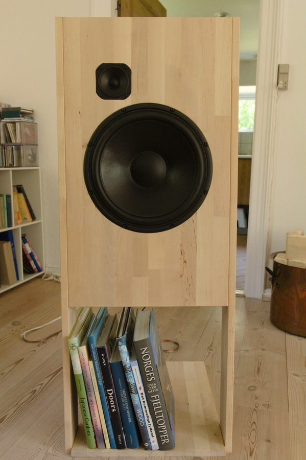

Right speaker. As an added bonus, the base also serves nicely as a shelf for various household or decorative objects for added WAF (or a monoblock, for reduced WAF).
Left speaker, WAF-modified. We did a small 1mm profile on the edges, which adds a nice line that frames the baffle.
All in all i think they have come out quite well. The wood was cheap 18mm beech intended for shelving (around $20-25 for 1 piece 40mm wide and 2m long). They were not the most square or even (some were a bit wider), but that was sorted out nicely by our neighbour in the cutting process.
