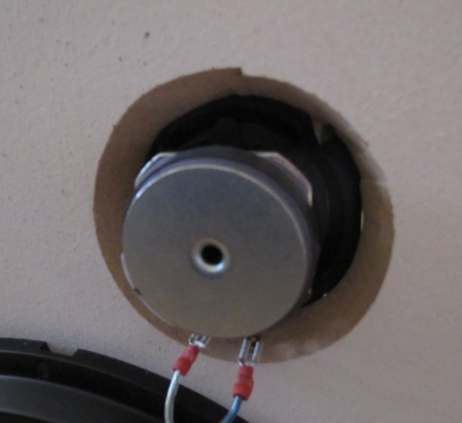

How important is it to have a perfect seal between drivers and the baffle?
Right now I'm not using any caulking under the woofer.

brixvold: Good to hear you are making progress! A perfect seal is not essential, but still a good idea. With some leakage (bypass) you will lose some efficiency and possibly generate some unwanted wind noise.

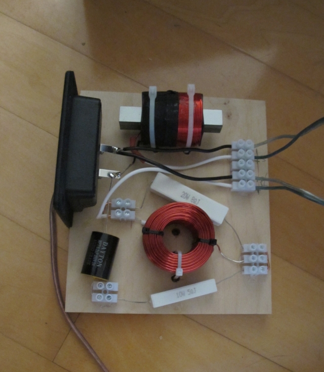

I just realized I may have ordered the wrong crossover parts. I ordered the parts for the Ultra (20mH coils, 2.5mH coils, 5.6uF caps, and 8 and 15 Ohm resistors). I would like to build the Manzanita from post #1776. I know John answered my earlier question about the crossover tweaks it would take to make the new wings work in post #1787. My question is, would those tweaks be applied to the standard Manzanita XO in post #1601 or would the tweaks start with the Ultra XO? Just want to know I'm not starting with the wrong XO as I have seen people build the standard Manzanita with the Ultra XO as well.
John should chime in soon, but those values will certainly get you started. You'll want to tweak the 8 ohm series resistor and maybe the 5.6uF high pass cap for that baffle. The 8 ohm value might need to be reduced to get the Vifa a little louder.
Having a cap value of around 4uF that you can add to a little at a time (in parallel) is an easy way to tweak. A fistful of 1uF and 0.5 that you can add and subtract to find a final value works.

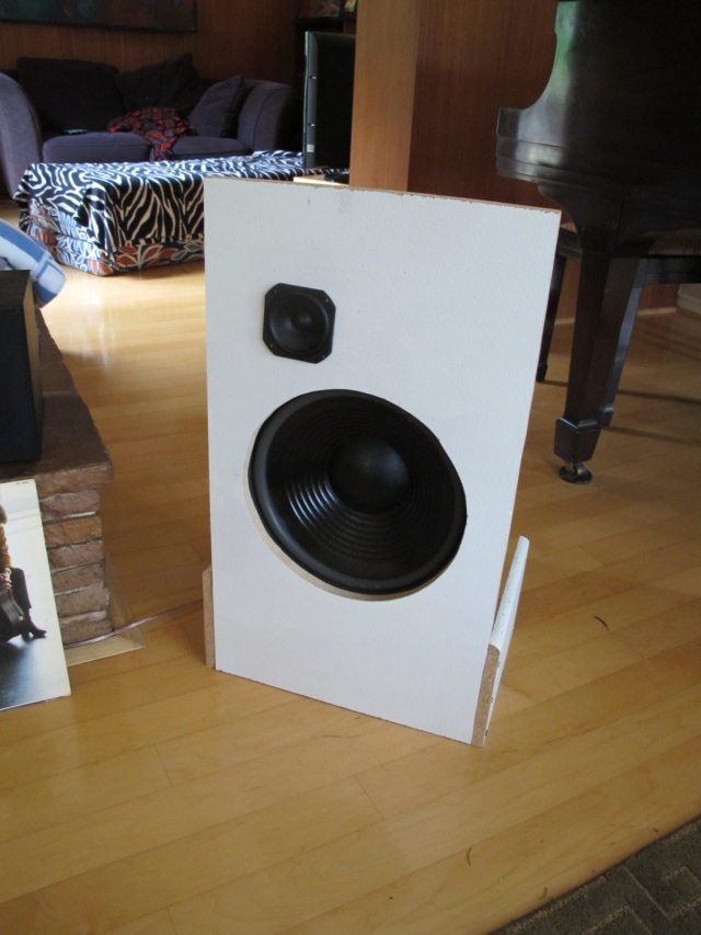

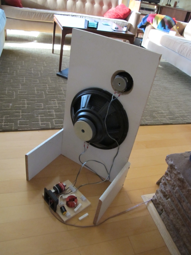

new build after many years - impressed
hi all,
I'm late to the party by a few years, but I have just completed one of these ob speakers. Im very happy, impressed and taken by open baffle!
I built these using the tc9 and a 12" GRS speaker with the xo from the 10 year post ( #160-62). everything bought from parts express and I hacked up a baffle from some 1/2 inch particle board before I go and build a nice hard wood baffle and make everything pretty. The one speaker has been playing for 3 or so hours and is getting better by the minute. Doris Day, Diana Krall and Mark Isham's Blue Sun all sound great. I love the live open sound, works in our 50;s hardwood floor living room very well. Sound thru out house sounds balanced and even. really nice to have some deeper bass than the folcal bookshelves I have listened too for years. I just love the open sound.
Big thank you to John B and Pano for all their work and support of this project over the years. Its a very rewarding project !
