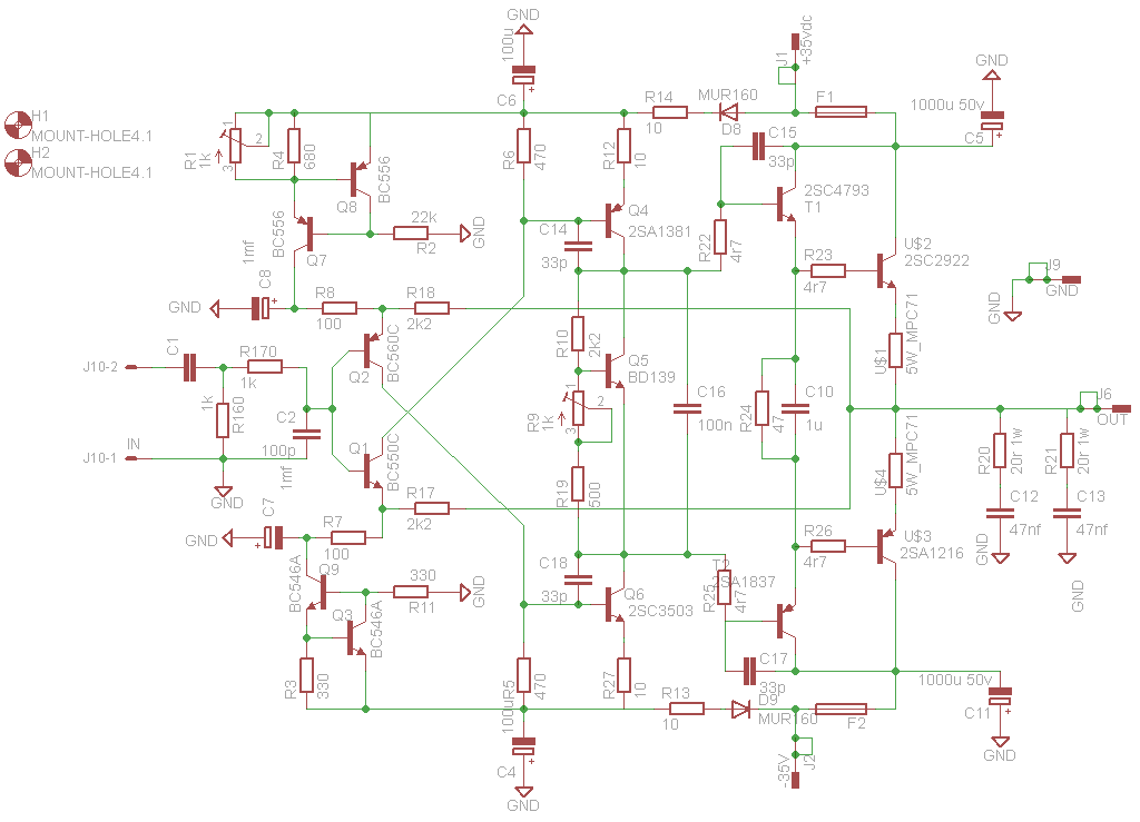

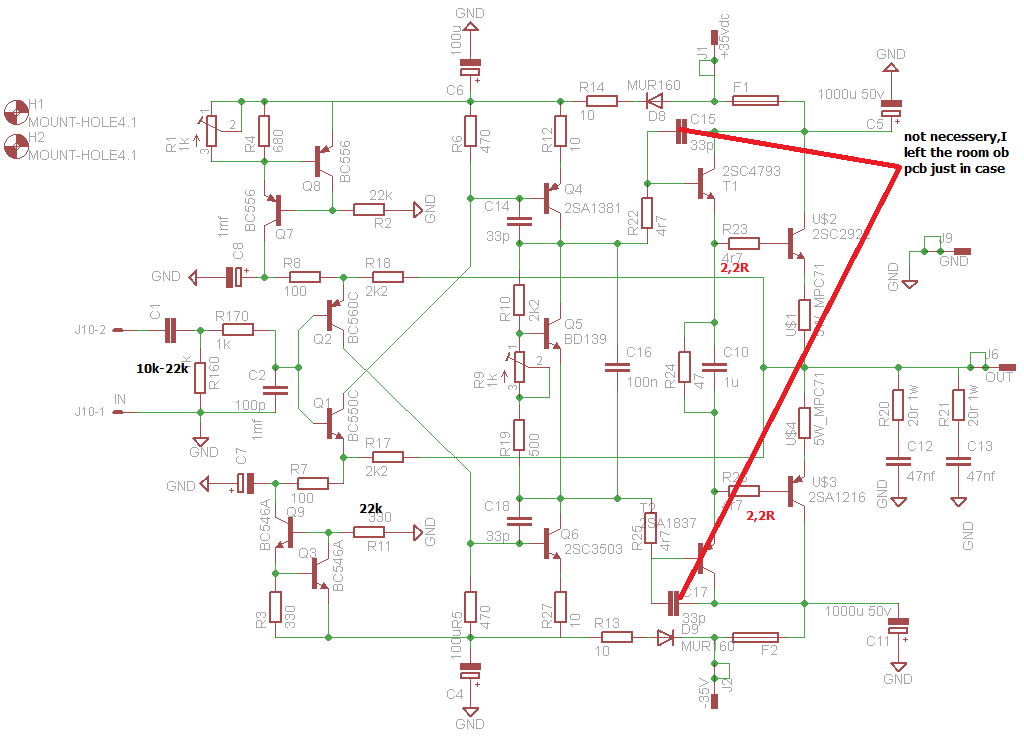

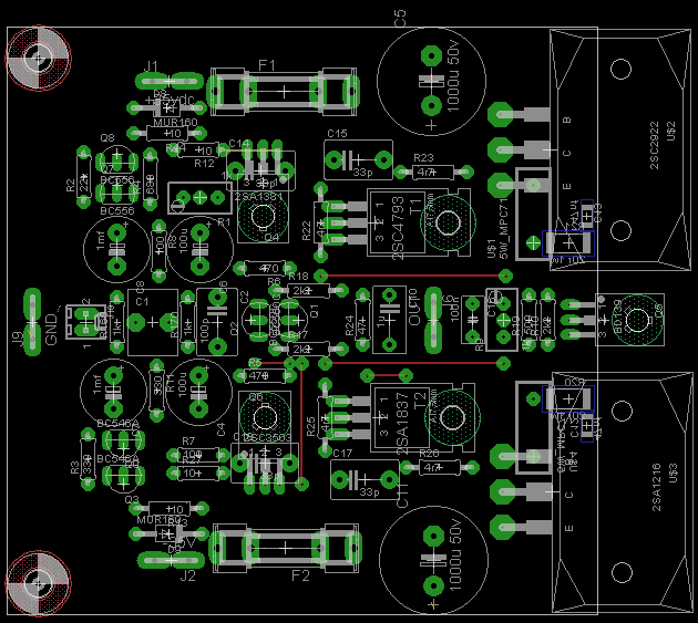

You have two options:
Option 1:
One cap + two resistors (high power rated 5W) cause You have to "feed rail voltage" back to psu - voltage drop on rail resistor. There is lots of heat generated in here. Resistors have to be 'low; in value
Option 2:
Cap + resistor + diode (like my one post 22 is schematic), resistor can be higher value an lower power rating, there is no need to ''feed the psu back with voltage'' --> diode. If we go further we can use 5v zener diode to keep bootstrapped voltage 5v over/under psu voltage.
Idefixes

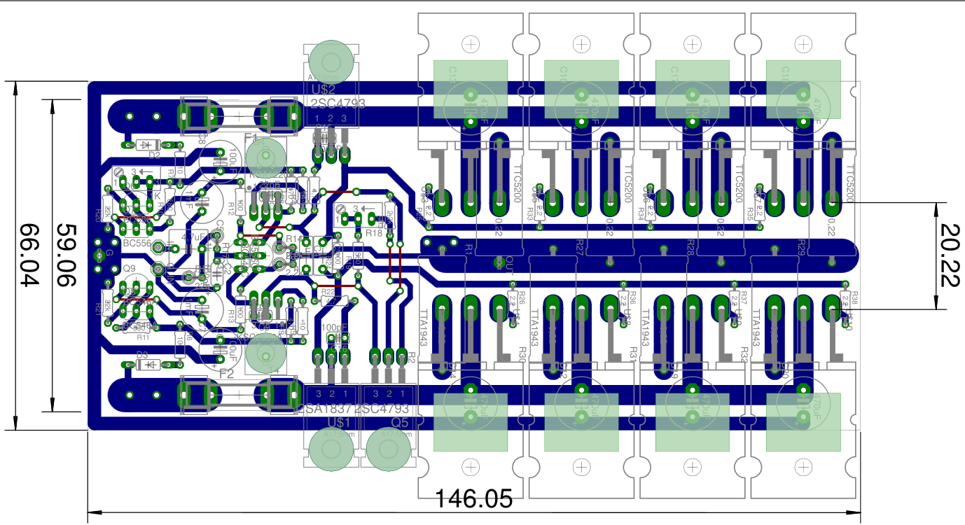

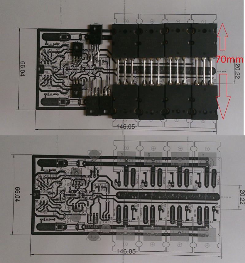

Very nice layout!!!
The small changes bellow
Idefixes
Very nice layout!!!
Thanks for advices. I will test this after LC VSSA test with same PSU +/-35Vdc
Marc
Borys
Thanks for your clarification and advice !!!
I do not know If I was precise enough. Sometimes there is too much thinks in my head at the same time - sory.
Option 1 and option 2 are per voltage rail, so whole amp needs:
2caps
4 resistors
or
2caps
2resistors
2diodes

On BJT schematic you give a grade A for BC546 but nothing for BC556 on BC550/560 any advice to this?
Marc
All off BCxxx the best would be the highest grade - so if you can get C would be perfect if not B will do the job. Get highest grade anyway.

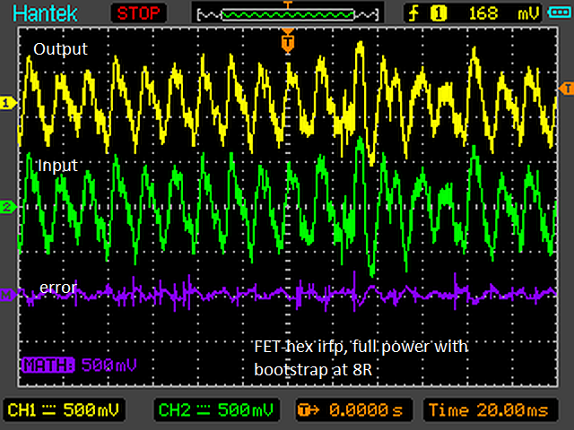

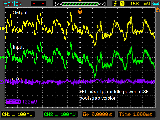

Borys, I may not be looking at these pics correctly, or not understand how the scale is set... the error "signal" looks much larger than it can possibly be, especially at the peaks in the violet trace on the display (?)Bellow fet-hex irfp. Yellow is output signal (taken from 10k potenciometer), green is input, violet is error signal.
The output signal is full amplitude scalled down to match input signal, tan I did A-B channel in scope and fiolet is result. I do not know if that kind of measurement is correct or not but I did it anyway.
I have measured thd at nearly full amplitude (40V -p-p) and they were exacly the same as for 20V p-p as I normally do the tests.
The peaks are prapobly due to bootstrap - I do not know. Monday I will test BJT version and compare.
I suspect your circuit is fine, but this particular pic/measurement/calculation, may not be. I just don't see the reason why.The output signal is full amplitude scalled down to match input signal, tan I did A-B channel in scope and fiolet is result. I do not know if that kind of measurement is correct or not but I did it anyway.
Perhaps you can expend the time base, and look at one or two waveforms at a time. Perhaps there is enough time lag in the data acquisition to make this look the way it does...
Perhaps you can expend the time base, and look at one or two waveforms at a time. Perhaps there is enough time lag in the data acquisition to make this look the way it does...![]()
