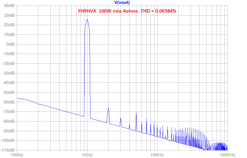

The FH9HVX has a predicted THD of 0.0038% at 100w into 4ohms. The Sony says to go no lower than 6ohms and is 1% THD or 260x higher distortion. The shape of harmonic distortion is important too. FH9HVX has dominant 2nd order lower 3rd order and mostly descending higher orders except 5th harmonic is higher than 4th. This says it should sound less fatiguing than a traditional amp with an LTP in our stage and push pull output (dominant third order usually).
The above is about at the limit of the onset of clipping. Playing it well below at 40w to 50w and the higher frequency higher order distortion will be much lower.

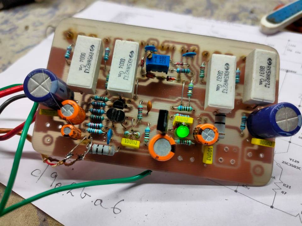

I am building the FH9HVX - boards are stuffed - just waiting for my PSU parts and chassis to arrive. It will join my "imitation" First Watt F7 Class A amp in a bi-amp setup.

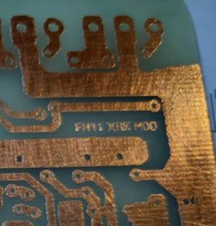

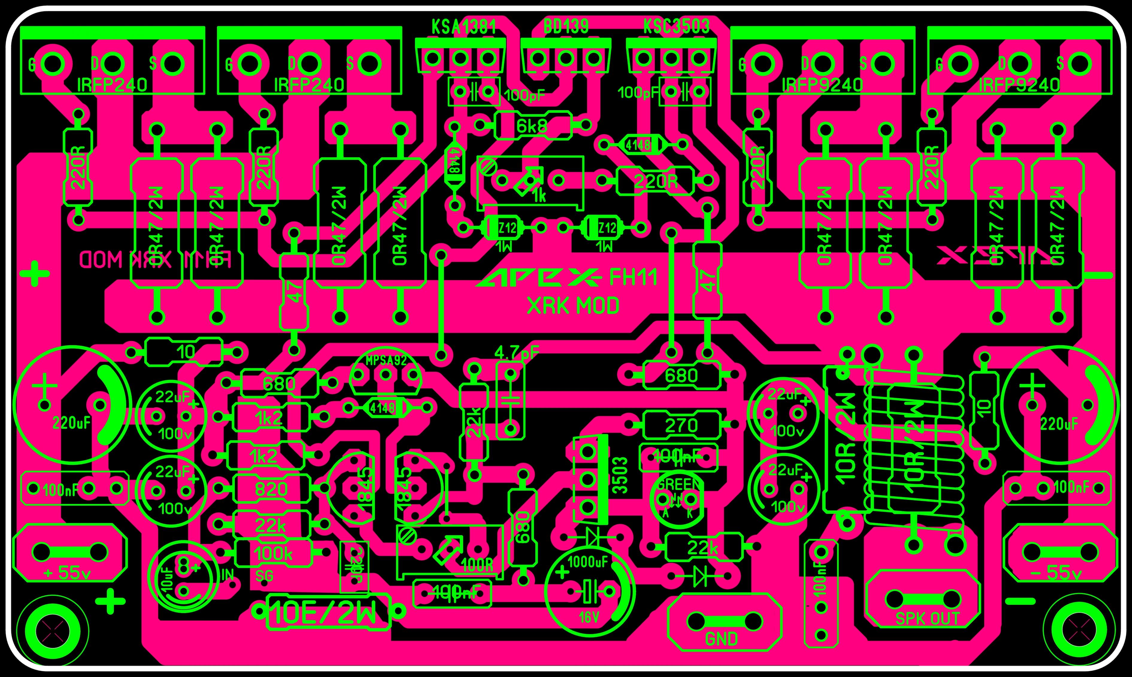

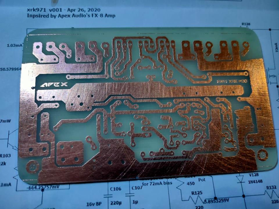

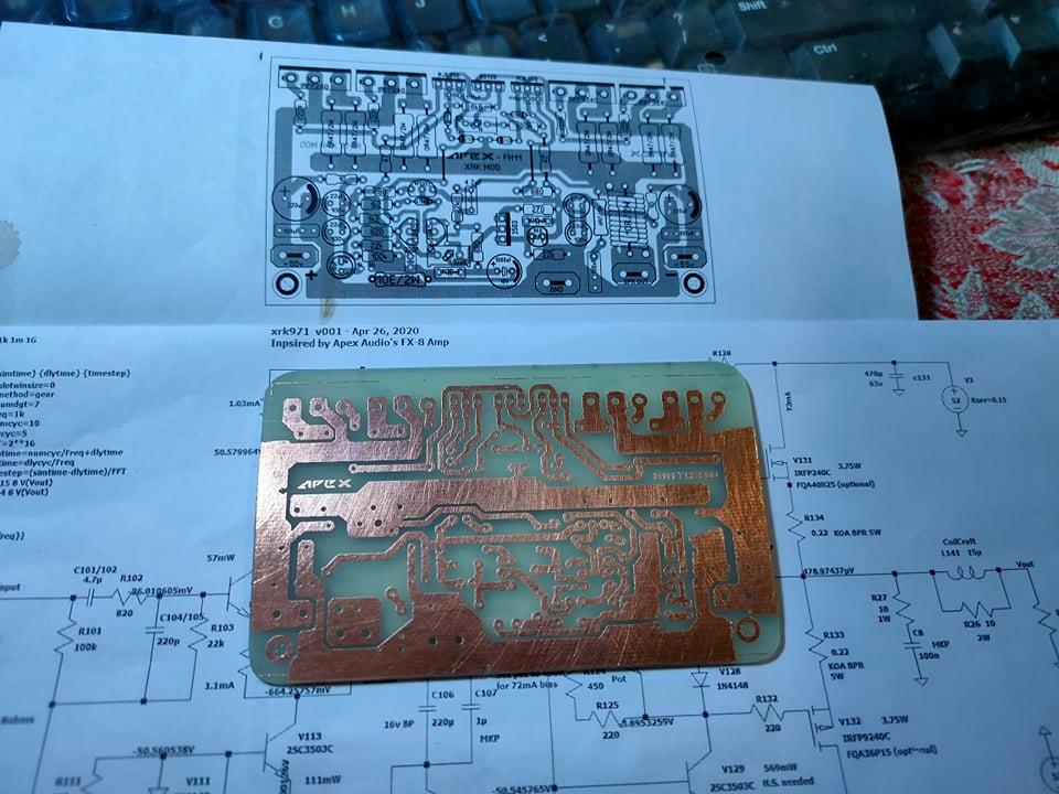

Hi Andrewlebon,
You mean FH11 XRK Mod? That’s a nice amp - just the big brother to the FH9 - although I find that a single pair of Fairchild FQA’s can handle same power as two-pairs of IRFP240/9240’s.
I like it that you still etch your own boards. There’s something to be said about going from pdf to PCB on 2hrs!
