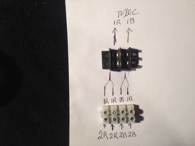

I am going dual mono and I am planning wire up 2 Xfmrs to 1 IEC power module. I am wiring like this:
I have the primary leads from the Xfrmrs in parallel to one side of a double row 4 pole terminal block. So 2 red wires per pole and 2 black wires per pole.
I would then have a wire from each pole on the other side of the terminal wired together. So 2 reds joined and 2 blacks joined. These would then attach to the IEC module or to a double row 2 pole connector, so as to have only one single wire going to the live and neutral of the IEC module.
Is this good and common practice? Thanks for the help.

I think what you have is correct Myles but your diagram showing the terminal blocks is confusing. What we need is an interconnect diagram. How you connect them (terminal blocks, wire nuts, Wago connectors, P2P solder, doesn’t matter. A diagram similar to this would be really helpful. This is not dual mono but you get the idea:

Thanks X, the diagrams are very helpful and will be more helpful as I progress with the builds. For now, I wanted to know how most builders connect their parallel primaries back to the IEC socket, since dual mono there is 2 pairs of neutral and 2 pairs of live to contend with).
On my diagram, I show 2 pairs of Red neutral wires and 2 pairs of Black live wires from the 2 transformers connected to a 4 pole terminal block. My terminal blocks are continuous from one side to the other. These wires are then reduced to 2 red neutral wires and 2 black live wires that are twisted together and attached to the next terminal block. Then finally the single red neutral wire and black live wire are fastened to the IEC module. My IEC module has the mains inlet, a fuse and rocker switch in one module. I need to wire a NTC 8D-20 if needed.
I read that coming out of the IEC module there should be only a ground wire, a neutral wire, and the live wire. The wires that are twisted together are terminated at terminal blocks, not at the IEC.
Anyways, I think I have this part correct, and I thank you for time and patience.
