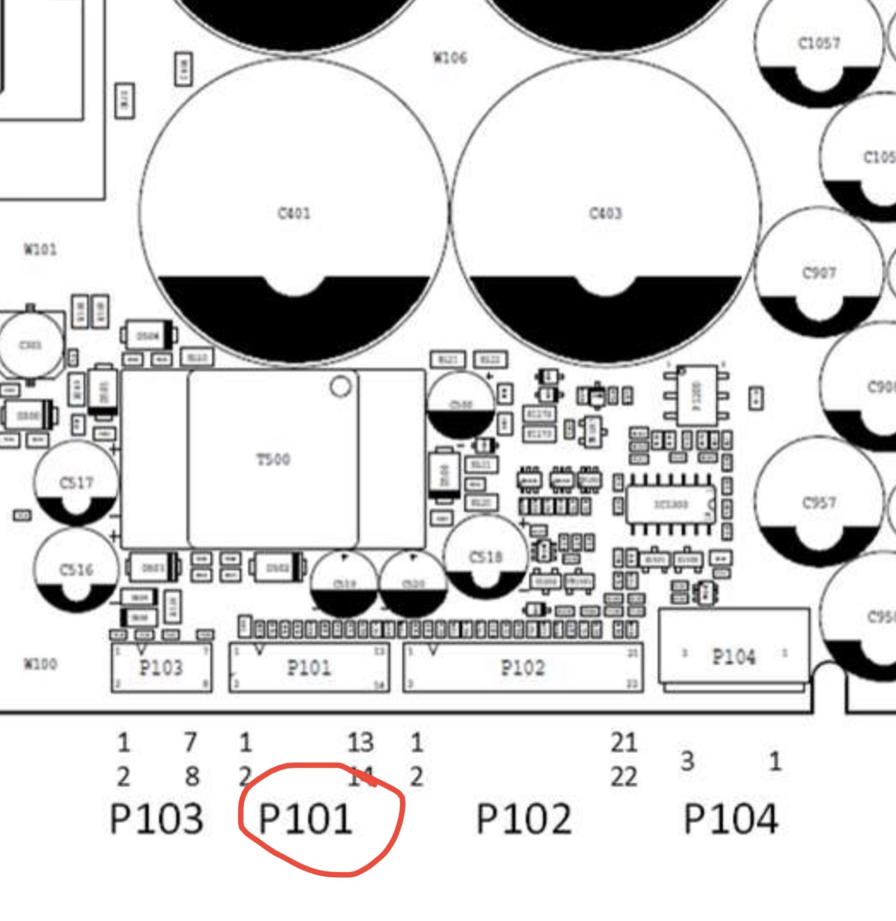

Completed my first build. Icepower AS1200as2. Still have some parts on order to improve the wiring, and add a standby power switch.
Right now I shut off the amp by disconnecting power using a mains switch. I get a very small pop in the speakers when I do that. Am I better off keeping the mains on and just put the amp in standby when not in use?

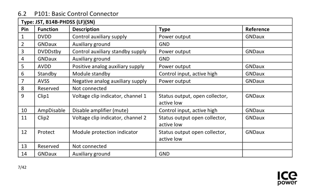

There is a proper way to switch off by triggering the standby line then turn off the mains. It’s all explained in the data sheet / users manual. There are many many options and connections. It’s like an automobile microcontroller. But you only need access to 3 wires to do this. Pin 1, 6, or 10 on plug P101.
Use a switch to provide Vdd from pin 1 to pin 6 to pull it high for standby. In standby the high voltage PSU is also shut down. It has internal pull-down resistor so when disconnected the amp is active. Pin 10 is amp mute and it keeps the PSU section on but amp output is muted.
Both standby and mute have pop and click suppression. I would use pin 10 for a front panel “enable” switch. Let the IEC mains rocker switch be the main power on and off.
All this is discussed in sections 11.4.1 and 11.4.2 of datasheet.
