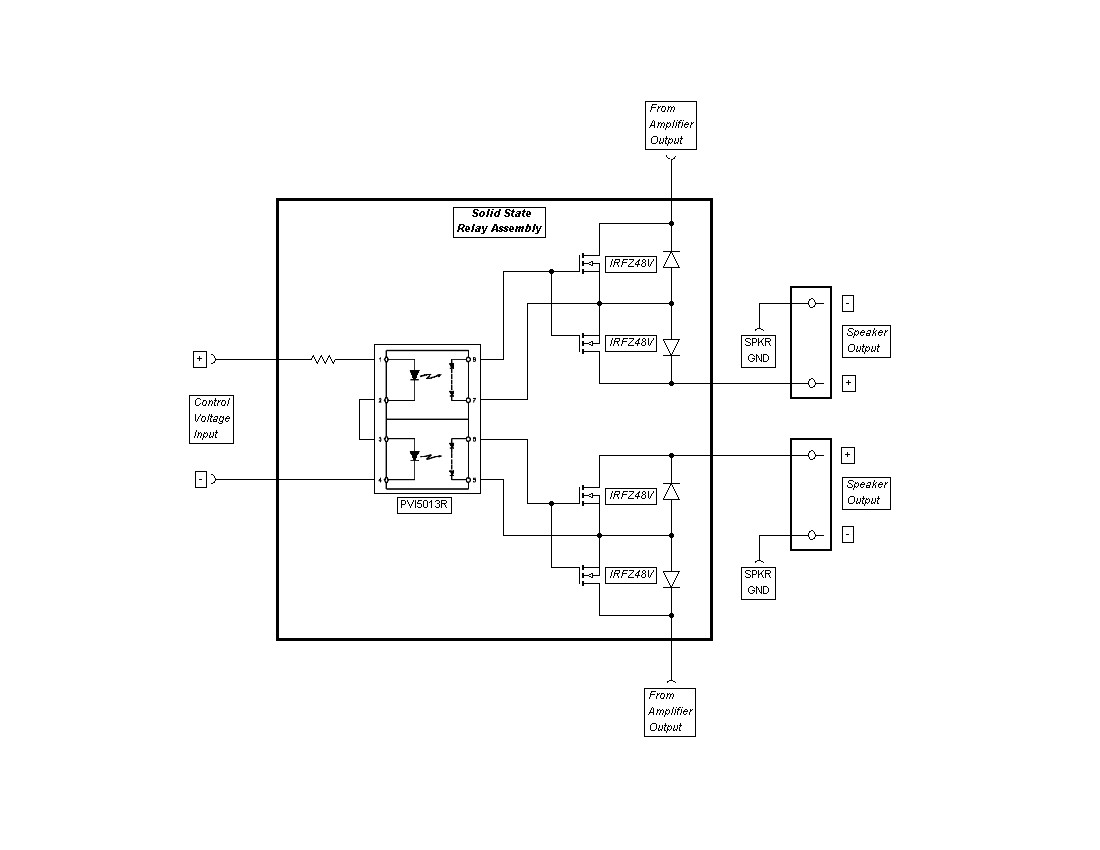

I will take note of the speaker protection though - is this something you need active circuits/relays for - or can a quick blow fuse work in the same circumstance?

No, quick blow fuse is not fast enough. They were tried in the early days on reviled amps like the SWTC tigersaurus.
Diyaudio store up top has a speaker protector kit.
There are lots of them on ebay, but the relay is usually something small enough that the contacts are likely to weld shut under the 3000 amps a 10000 uf rail cap can put out.
Best is the Michael Bean back to back nfets protector, driven by a photovoltaic fet driver to make the gate voltage higher than the rail voltage. I use a Panasonic APV1122 as driver. I put the driver input in series with a green LED that displays the amp is okay (and resistor to limit the current). I use a flip flop to remember there is a problem, a 74AHC74 driving a npn transistor. DC on speaker detector is a 47000 resistor driving a 2.2 uf ceramic cap series a 8 v bipolar diac powertec bsd08. Equivalent to the diac are two back to back 7.5 v zener diodes. The nFets are between the output transistors and the speaker jack. The sensor stack is parallel that to speaker return.

The michael bean schematic is on here already but bing can't find it.
The DC detection circuit that triggers the flip-flop is part of most Peavey amps, for example the output board of the PV-1.3k schematic on eserviceinfo.com
The 47k series 2.2 uf series the sbs (diac) that triggers the triac on the output.
inverting that signal and triggering a flip flop is up to you.
Another schematic of the same thing is the bonsai solid state relay protection thread. His circuit is surface mount, which is for people with a $20000 wave solder machine after they have made a circuit board. The APV1122 is through hole and can fit on a dip project board from newark.

indianajo - thank you for the further information on the protection circuit. I had a look at the schematic suggested for the PV-1.3k and now understand. I'm assuming that once the 74AHC74 driving the NPN transistor has flipped (or flopped), a power off/on is necessary to 'reset' the circuit? After investigating the issue obviously.

Yes that is how is reset the 74HC74. I have a resistor capacitor as a timer connected to the reset of the flip flop. A further wrinkle is a diode to power supply cap to discharge the timing capacitor once the amp is turned off.
The trouble with the triac connected to the speaker that peavey uses is that when it shorts the speaker to speaker negative, all the energy in the rail caps goes through the overheated output transistors until the mains circuit breaker blows. This can blow more output transistors than the first one, and they are $5 apiece. Michael Bean nfet circuit disconnects the speaker once a fault occurs.
I didn't print my whole schematic because PV-1.3k has "flying speaker ground" which means the two channel speaker grounds can be at different voltages. So I used a lot of optoisolators to communicate the fault to the 74AHC74 on it's own power supply. Took a separate wall transformer 5 v in the dirty AC corner of the box.
