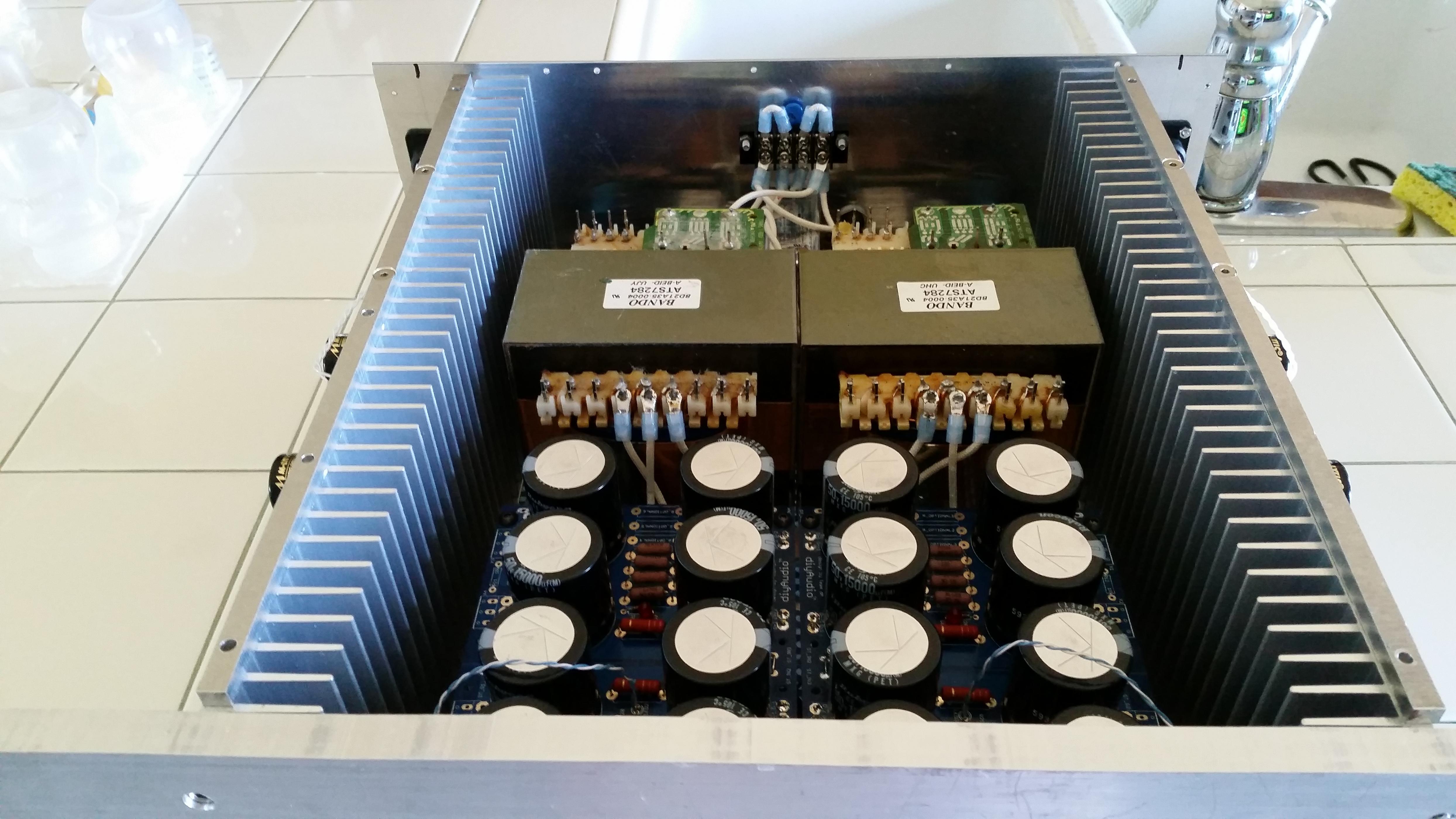

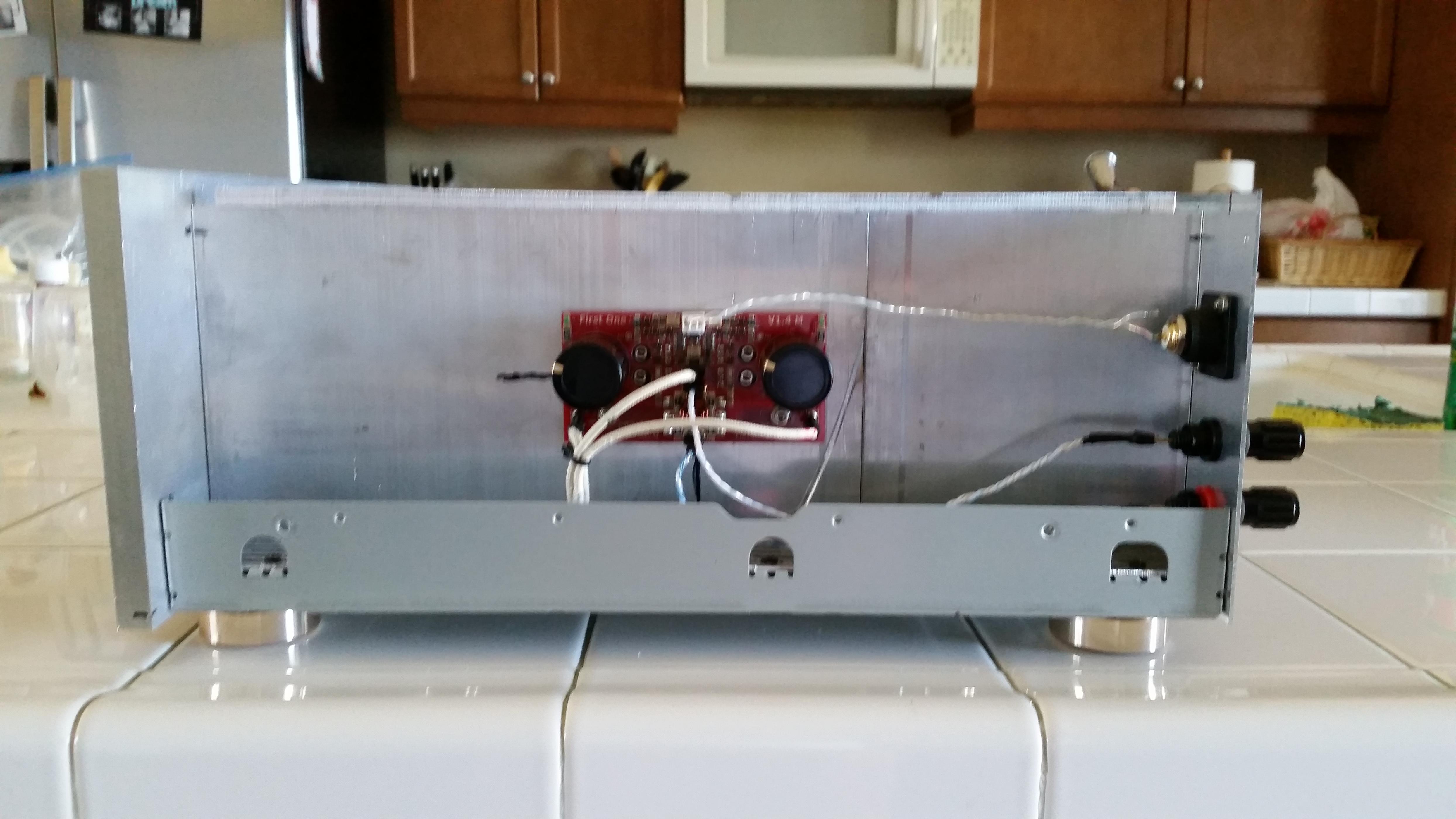

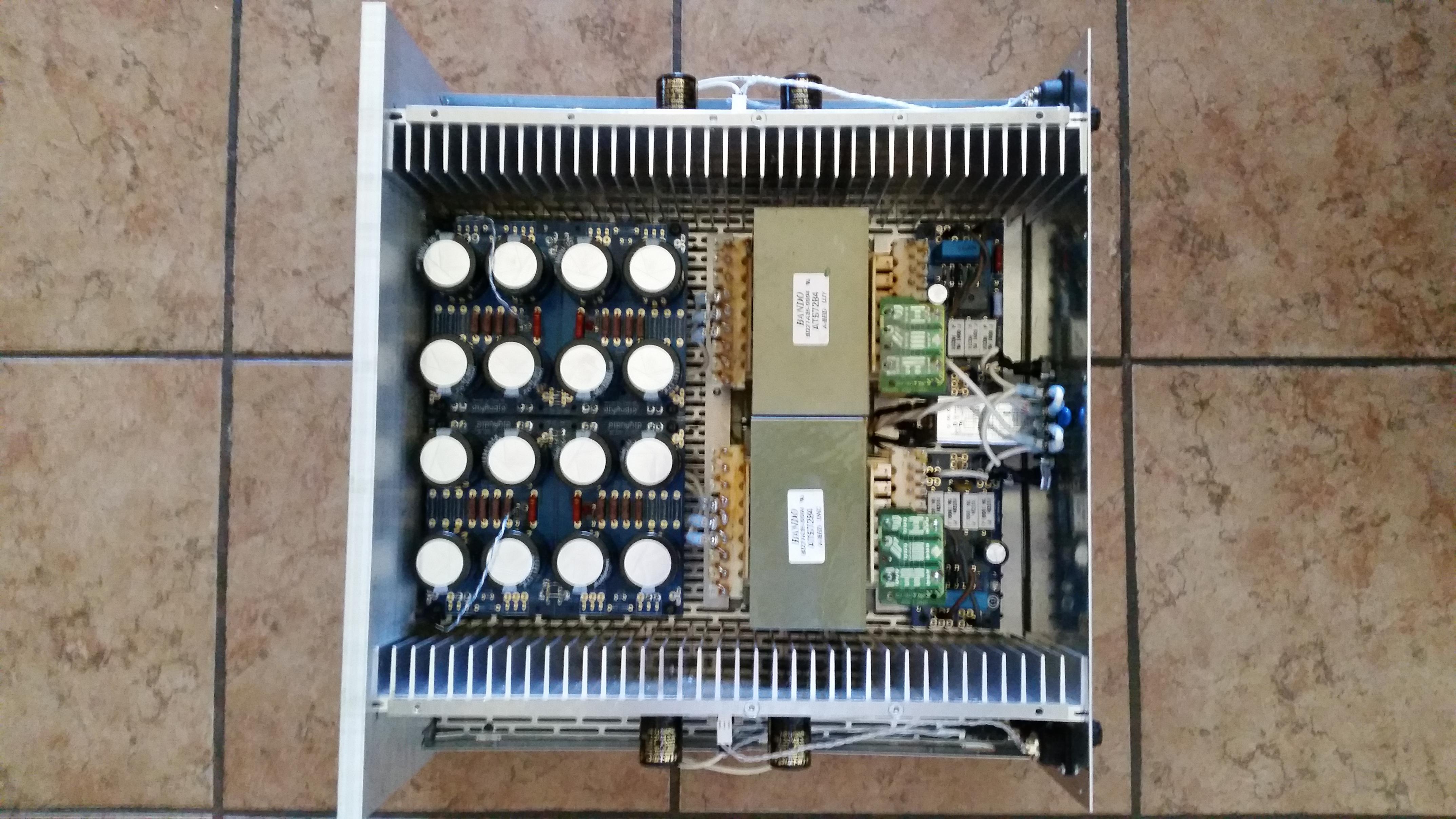

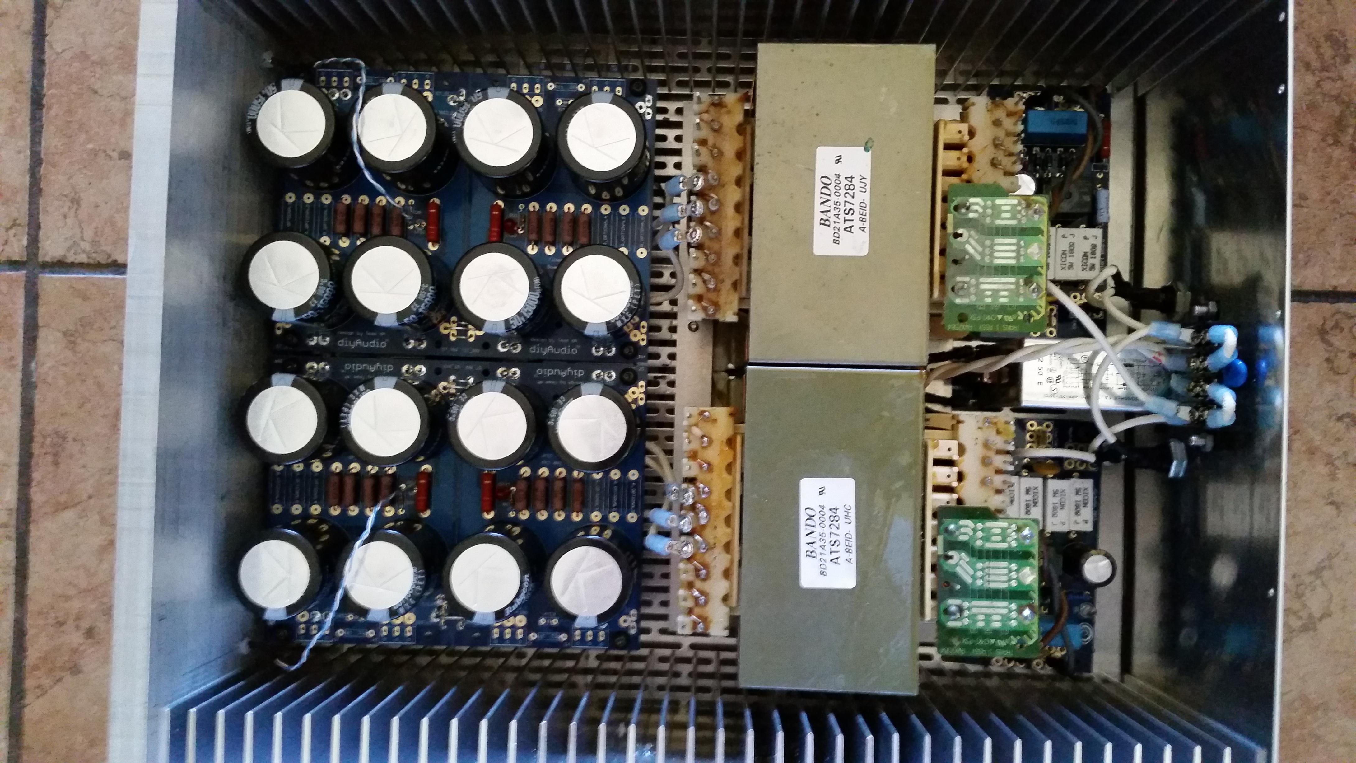

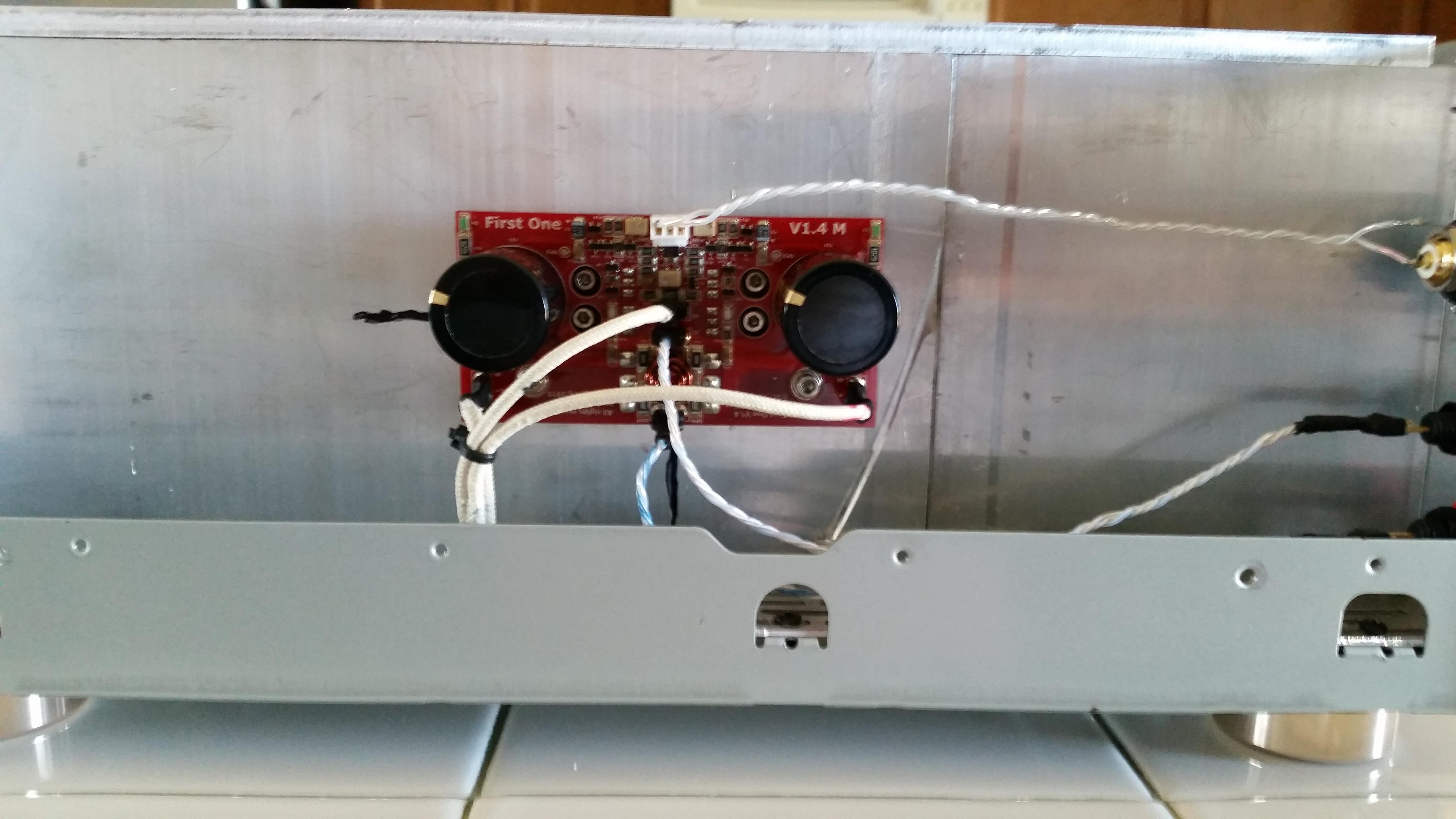

Hello, here is my iteration of the 1.4. It uses two 550va EI transformers and is dual mono. I'm a relative newbie but the highs are clear and detailed. I can hear snapping where it used to be very faint. The mids are full and smooth and the bass is tight and impactful. It's been completed for two weeks now and I just wanted to let it break in. It is a very good amplifier considering everything cost me les than 500 dollars!

How many uF per rail? 60.000?

Thank you! 60,005 uf per rail so a total of 240, 000uf.

What is your DC voltage?

The rail voltages are +-51. I increased the bias to 330mA to compensate for the lower voltage. It seems to be working rather well and I cannot imagine how dual smps would make it sound any better.

I have a trick for linear PS that I use in all my best amps...but lets hear what LC recommends as a minimum capacitance for 50VDC...

I am interested in learning about this trick of yours.

Where are the transformers teken from?

LC runs mains wiring underneath the SMPS L shaped heatsinks...
Thank you M.
I tried mains wiring underneath the SMPS L shaped heatsinks as you recommended. Then the hum is almost gone.
I will re-wire all cables more carefully when I assemble in new chassis.

Two pioneer Elite VSX-33tx receivers.
