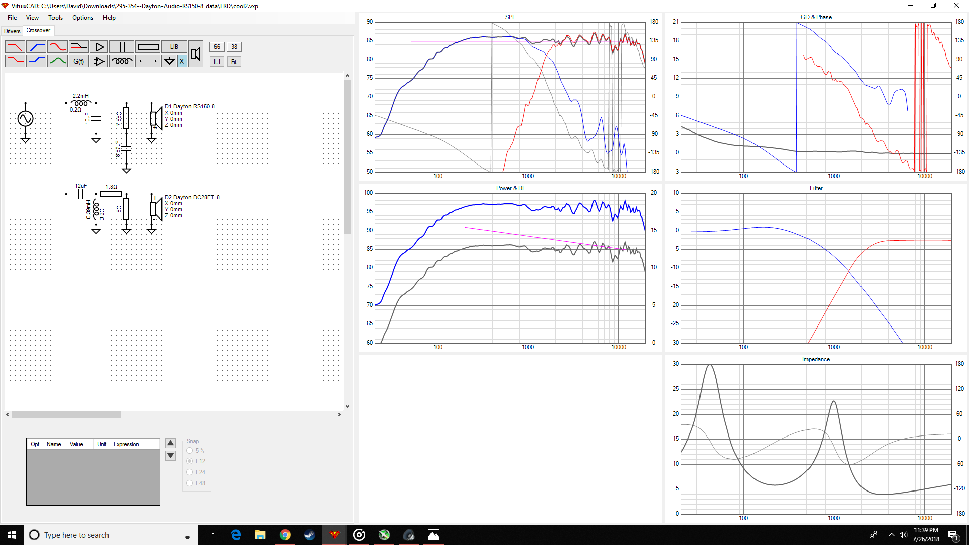

I factored in the baffle response and removed the resistor. How's it now?![]()
I am not so sure that you accounted for the baffle step. An spl of 90 dB/1m at about 1kHz radiating 2pi and with a standard input voltage of 2.83V would have dropped a couple of dB after introducing bsc. Perhaps I am missing something. I do see there is means in VituixCAD to account for it but I have not tried it yet.
That looks good. You just have to eliminate that dip, by adjusting your lowpass.
You could also add a small value cap (0.1uF to 0.5uF) parallel to low pass inductor, for a steeper rolloff of the woofer.
Now tweak your lowpass values a bit on the woofer to eliminate the dip at 1.2kHz, and you'll have a solid starting point.

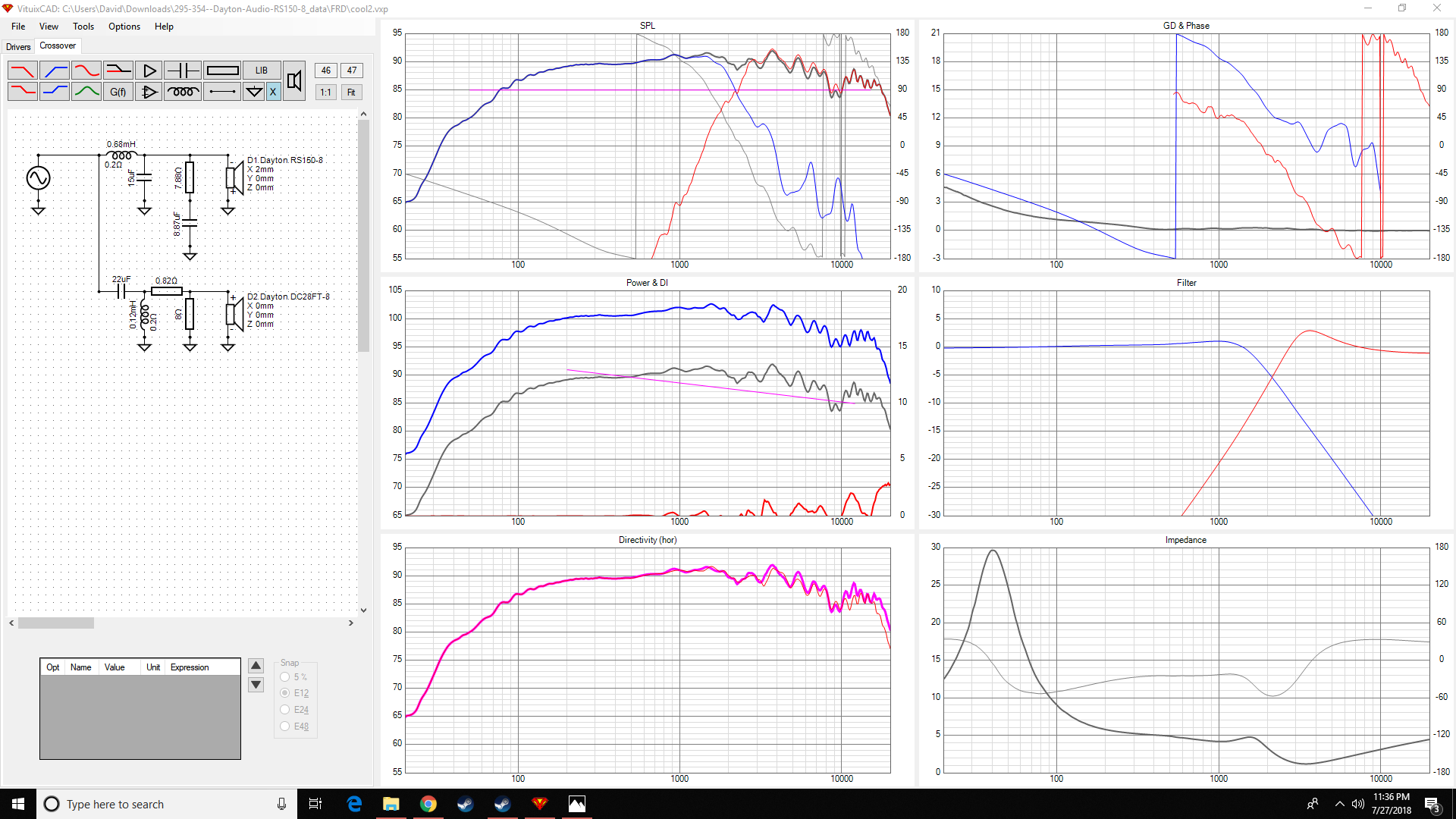

Yes you have come quite a way in a fairly quick time![]()
Should I revert to how it was in post 13? I'm not sure I understood post 16 properly because it seems the dip isn't what I want
Having a closer look I agree with lojzek that the baffle step doesn't appear to have been added in. I had a play with your drivers a week or so ago, but didn't post because you seemed to be working your way through it. with the baffle step factored in the woofer is around 85db not 90db.

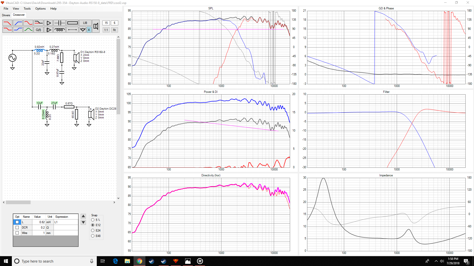

I quickly tweaked your crossover a bit . You can further adjust the values to your liking.

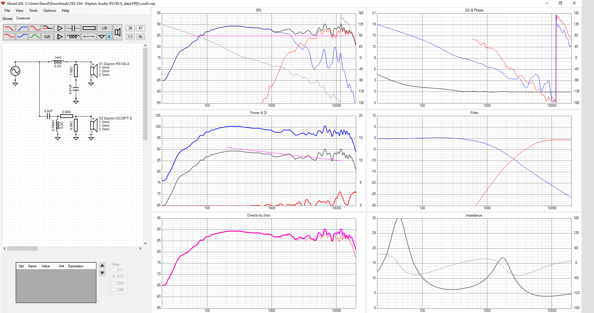

With the baffle response factored in it took a little longer to correct but I think I did it
I went a bit further and also adjusted for a vented enclosure and came up with the attached. for me the tweeter is the problem, with quite a ragged high end response. I'll put your crossover into my sim when I get home and see how it compares to what you posted, using my baffle adjusted frd.
lojzek, there is a tool in vituixcad to model the baffle response, but you have to export the frd and then use that new one in the sim. No feature to just put in the baffle effects directly.
edit: I'll also do mallikreddyk's as it looks better to me than the one I have attached![]()
I noticed yours matched the phase better than mine. Should I use that instead?
It looks good. Since both mine and yours are from traced curves I wouldn't sweat the phase tracking too much. It is a guess at best what the offset should be, so either one could be closer or further from the ideal tracking, which will only be known with proper measurements
