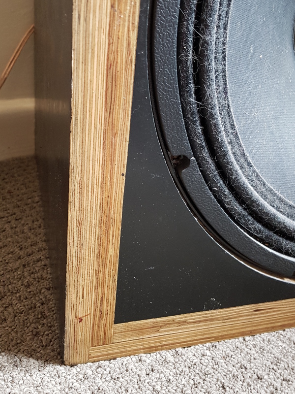

The image attached here (one of my toys) is simpler again: staggered butt joins, with sanded+waxed edge grain. I painted these, cos I maimed the veneer (tropical hardwood) during construction.

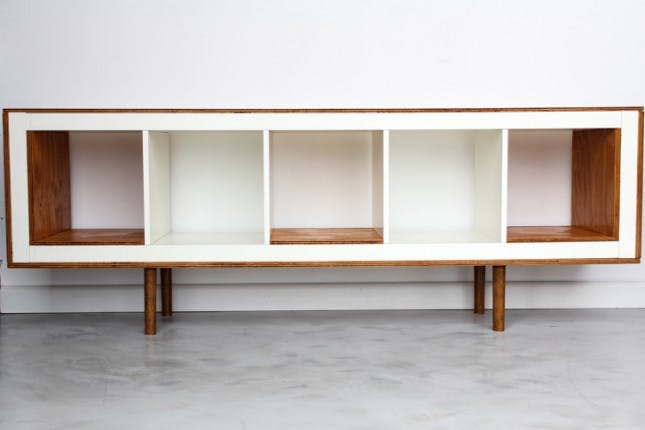

I don't mind either way - my GF really likes the look of the bamboo, so the more of it I have spare, the more I will use on pimping out bland furniture (i.e. something like the attached).
