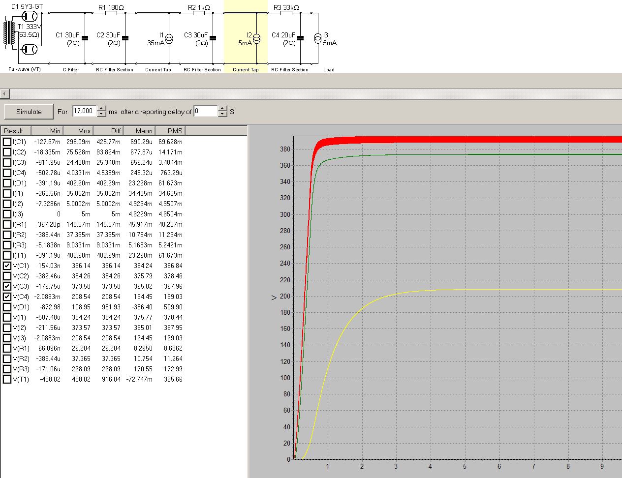

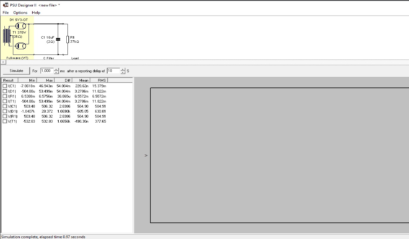

I had the chance to play around with PSUD II not sure if I'm putting in the correct resistances on the capacitors and the transformer?? Not able to find much a tutorial for the software.
If you right-click on a section or component you will get the 'Edit' window. The 'Help' button in that window will give specific hints, which might help.
To see the output, you need to check some of the boxes at the left.

Well, I was wondering about the DC resistance needed in PSU Designer but now it all makes sense to me.. crystal clear in my head, thank you 'very much' for explaining!
The resistor must be replaced with a current load on each stages you have.. you can see in VictoriaGuy's example the guesstimate load he puts for the 6V6 (35ma) and both 6AV6 (5ma).

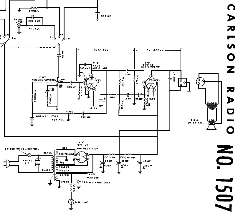

Don't burn your brain. This rig DID work for Stromberg, with 6V6 and a rectifier bottle. Fender Champ WAS good radio parts, tuner omitted preamp added. All this stuff used essentially the same parts, will work the same.
Anyway: you expect 400V no-load to sag 10%-20%, making 360V-320V. Allowing for cathode bias and preferably a little more B+ filtering, this is right on target for the nominal 315V-350V rating on classic 6V6. 99% of 6V6 will stand far higher voltage, and Fender pushed those limits in some models. But here you are NOT doing showroom comparisons between Fender Gibson Ampeg and Kay (so you like it to seem "more"), you are aiming for a garage/small-tavern amplifier and will be happy with what you get.

Unless there is some special trick to measuring the secondary impedance I measured it at 610 ohms. Which definitely settles down the B+ voltage a bit when I change to that value in PSUD II.
