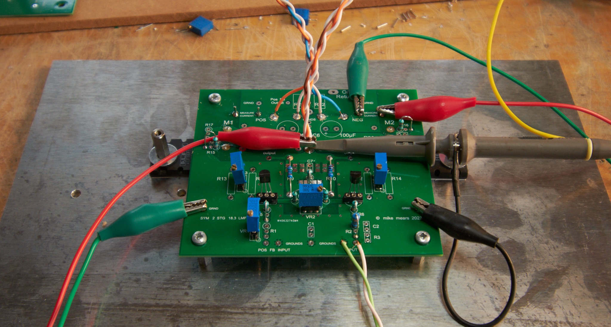

I just did a first turn-on for my F7 PCB design
At present for this quick bench prototype I use ALFET 16X16W mosfets and at present, without the Positive FB, the damping factor into 8.2R is 2.8
Nelson said his was about 5.
Any thoughts about if 2.8 is too low ?
thanks

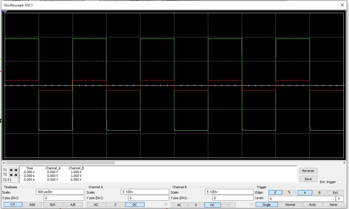

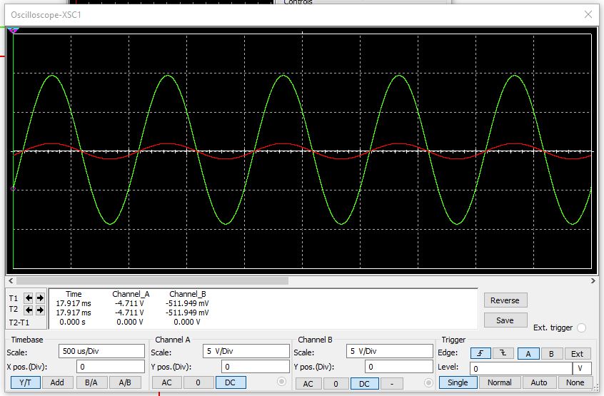

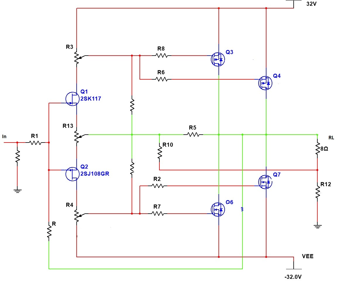

I played around to simulate the circuits posted here and came up with this circuit.
This looks good on sims but not sure if the "un-labled" resistor will pose any issues, although it improves the THD from .010% to 0.004% @1watt 1Khz sine
Attached also the output sine and square wave.
I was attracted to this F7 due to its simplicity and based on reviews i read and watched and seems really worth to build one.
I do not have the K170 and J74 on the software I use but in general those should work, atleast on sims?
output waveform below is 1Vp sine and square. @1Khz

Interesting design . . . but I would need to play around with it in spice to understand how the current through the load is translating to extra voltage i/p
I would be interested to know:
What the 10khz square wave looks like
Damping factor without Positive Feedback
Damping factor with Positive Feedback.
My understanding is that these are some the key parameters that define the F7 functionality
Alternatively the open loop gain & closed loop gain with & without positive feedback would tell a similar story

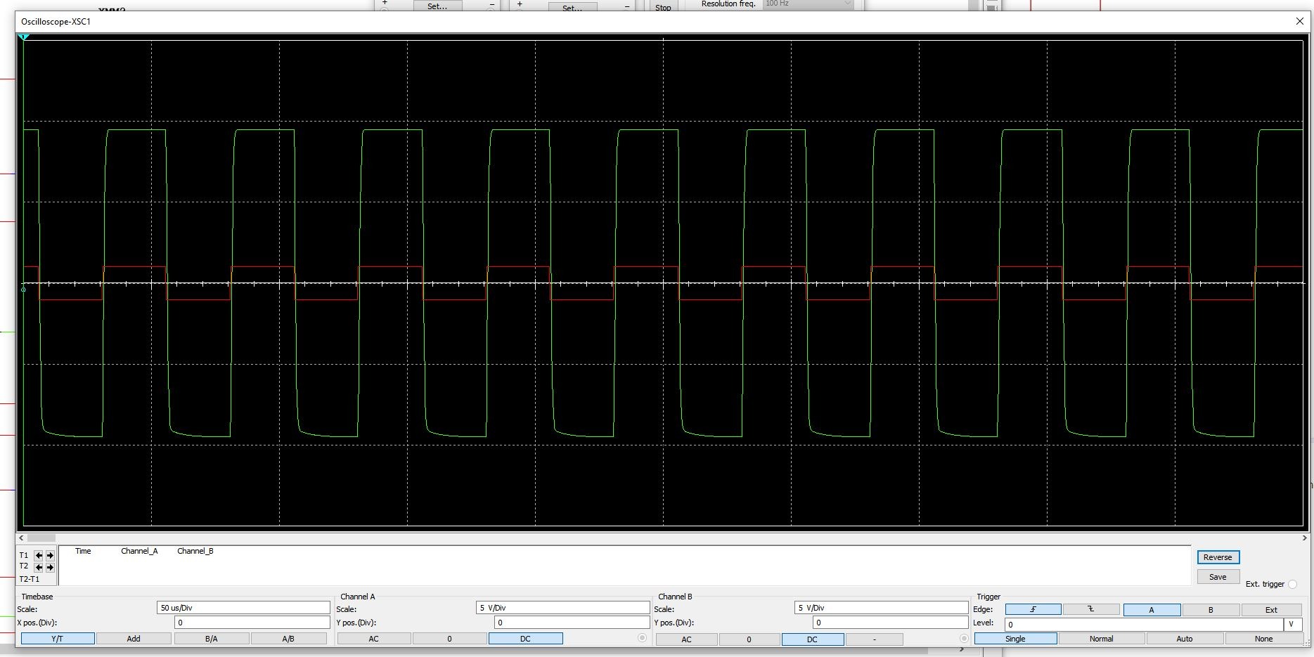

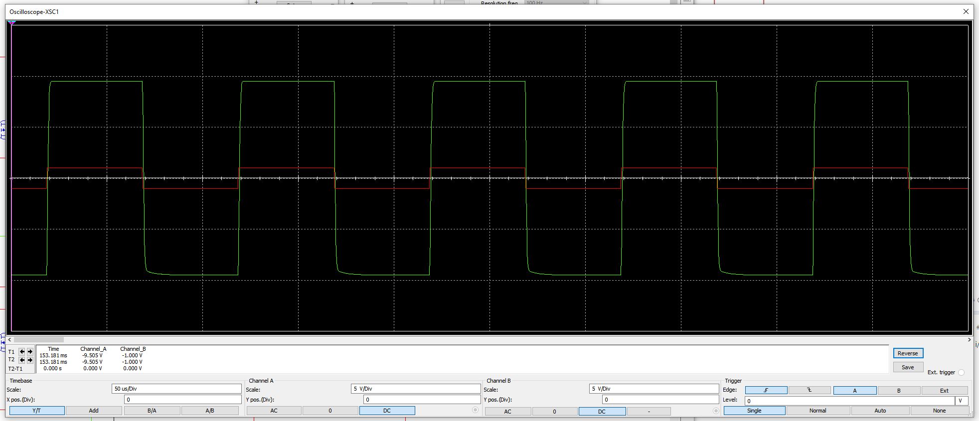

I have yet to build this circuit. This is the first amplifier I will venture to Class A amps so I cannot report all parameters yet.
Anyway here is the output waveform in sims.
Output wave @1Vp with 10Khz input
Output wave @1Vp with 20Khz input
rawbas,
If you run a sin wave in spice at 50hz then measure the peak output first with the 8R load connected then with it disconnected
Then repeat these two readings but with R12 set to 0.001 ohms
Make the peak output somewhere between 5-10V
From these readings we can work out the output impedance with and without the positive feedback.

Here is the results from my sims.rawbas,
This is 0.57Vp sine @50hz
R12 0.33
8R - connected - 5.978Vp
8R - disconnected - 9.932Vp
R12 .001
8R - connected - 9.993Vp
8R - disconnected - 10.082Vp
My calculations say:
With no Pos FB you have a damping factor into of about 1.5
With Pos FB you have a damping factor of just over 100
Nelson suggests a DF of about 5 without pos FB. With a DF of 1.5 the amp should sound exceedingly relaxed but with so little Feedback the Harmonic Distortion will almost certainly be higher than a standard F7
The damping factor of just over 100 with the Pos FB means that this part of the circuit is working very well.
I think we would have to ask Nelson how it might sound . . . .
One question I have is this:
When calculating the DF with the load connected do you have to add the resistance of the sense resistor to that of the load resistor to get a true result ?
