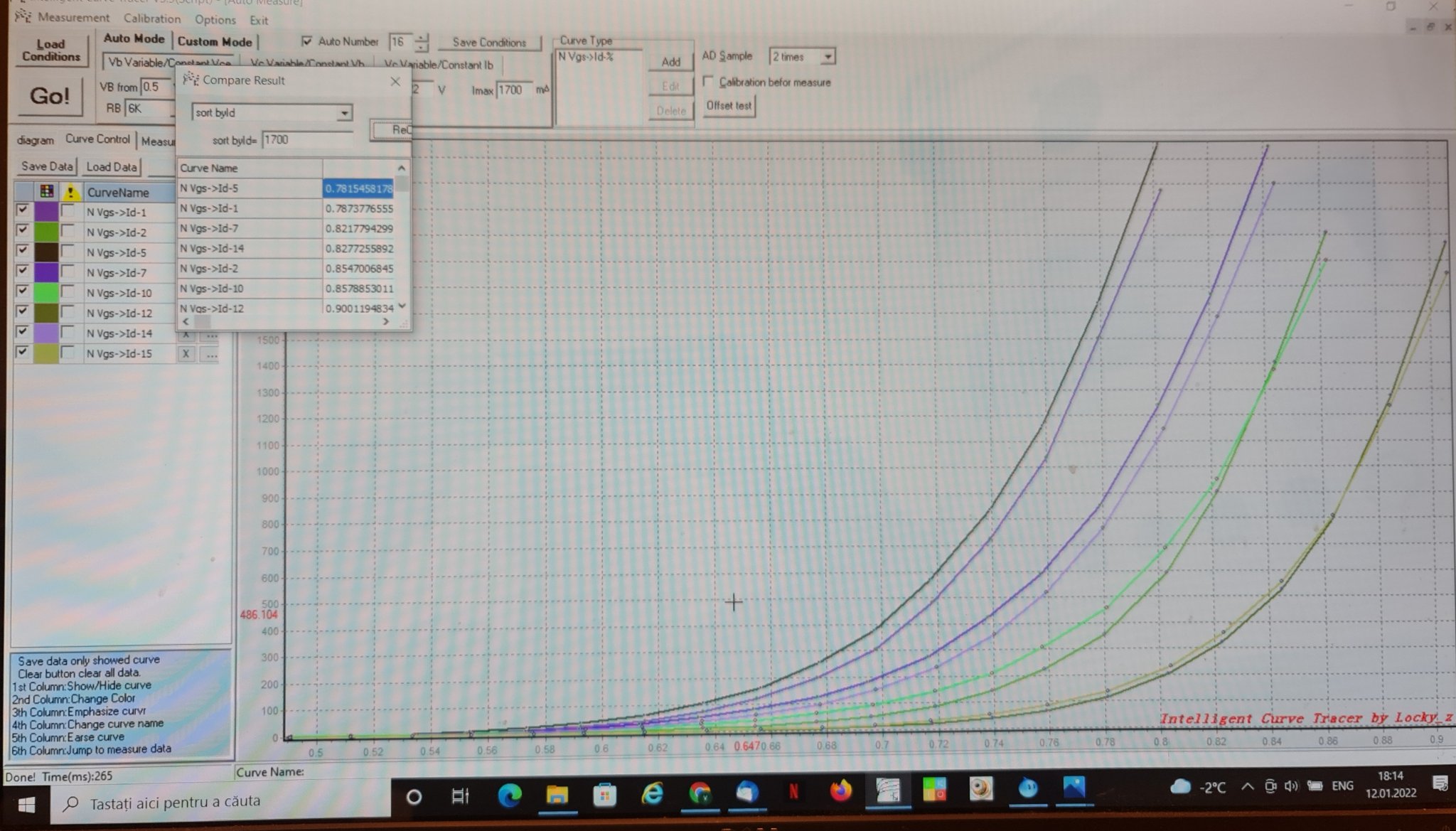

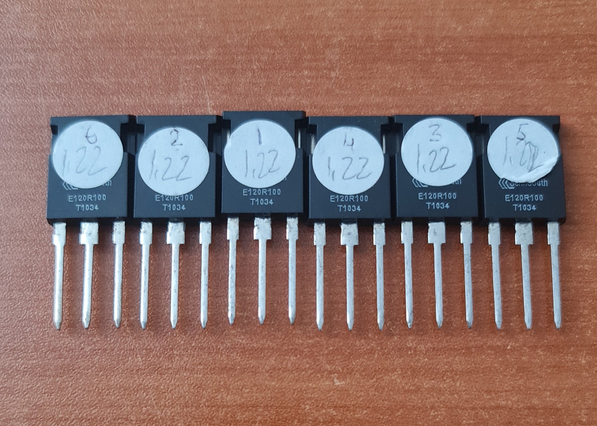

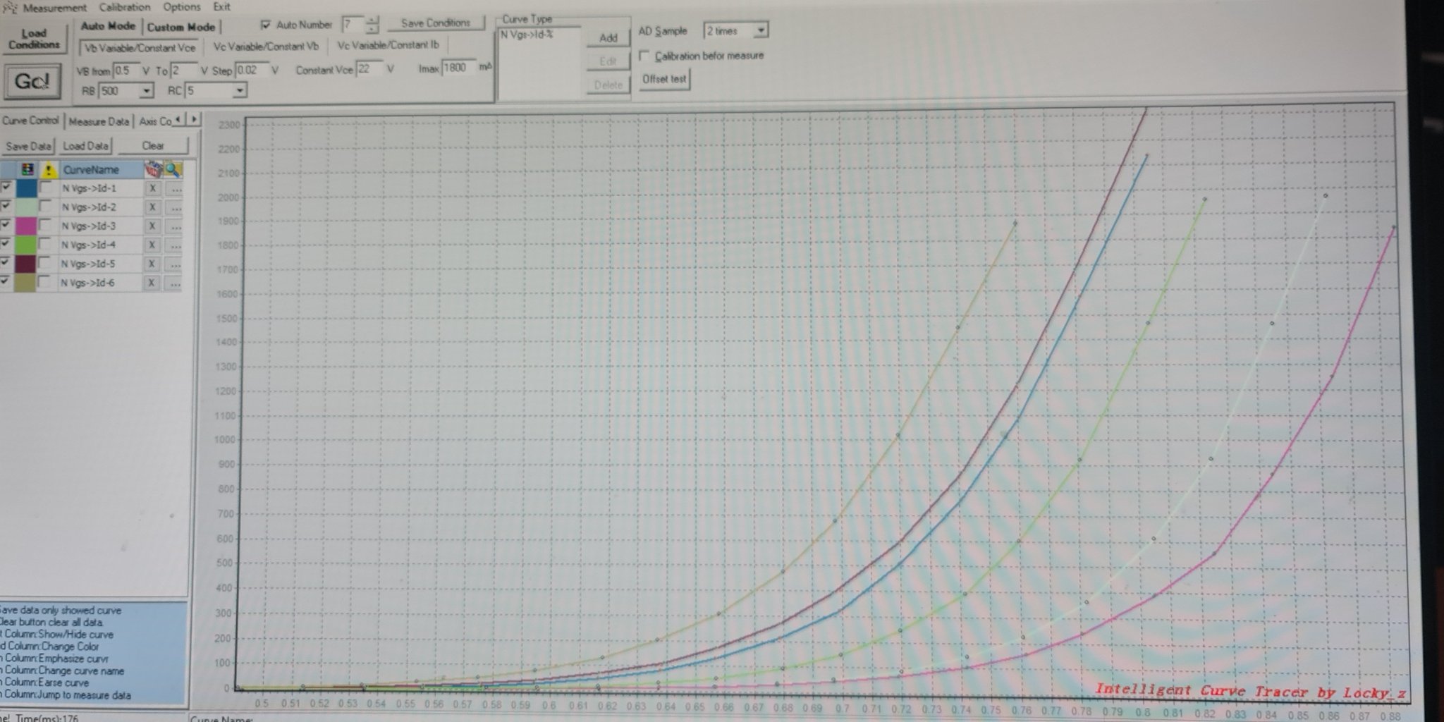

Din pacate... am o problema.
Credeam că SS120R100 de la TeaBag a venit selectat cu Vgs 1.22.
Acum am decis să măsor cu CurveTracer.
Nu prea ma potrivesc... :strigăt:

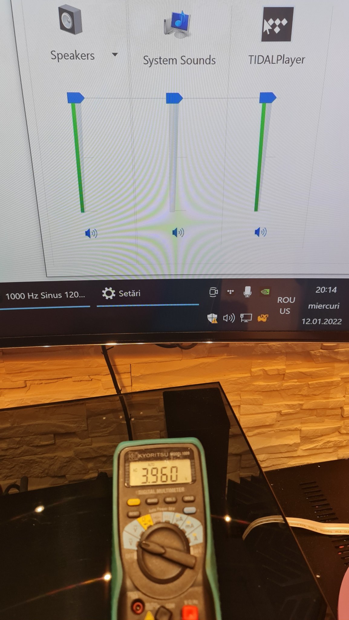

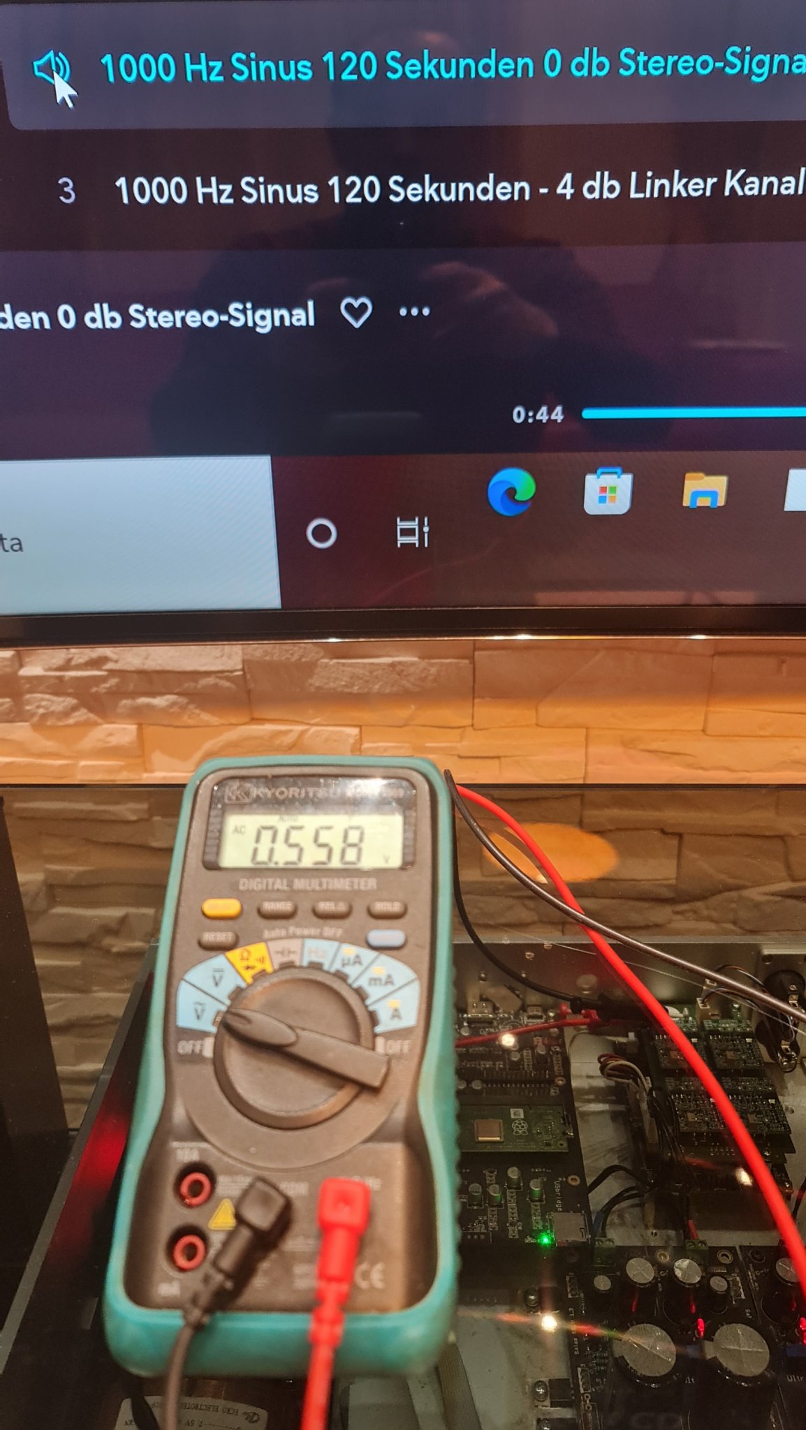

ok
3V96rms from your source
+8db from Iron Pumpkin, which is 2.51V/V
means you have 9V94rms alowable to crank your F1 to full power
original F1 is having gain of 14db, which is tad above 4V/V .......... precisely 5V/V
declared power of 10Wrms@8R is 8V94rms ............ that means - you have plenty of gain at disposal
feel free to start with Iron Pumpkin set to 0db gain ........ amp needs 8V94/(5V/V) = 1V78rms at input, for full blast
