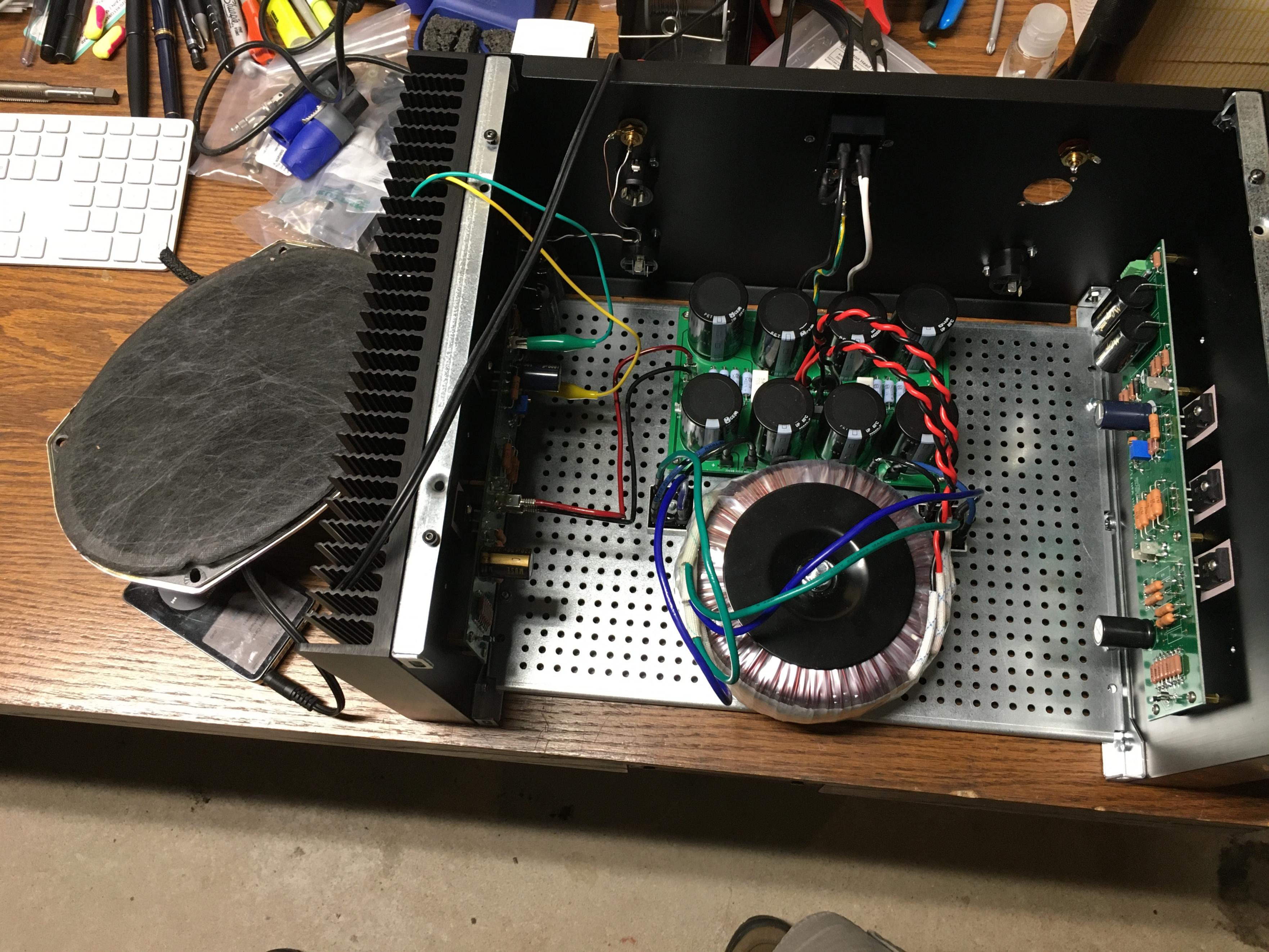

Hi Chas, thanks for the boards again. I had a little time yesterday, so I put it all together. It works from the first moment. I am using variac, test speakers with cap, and fans to cool it down in the first testing stage. Its just test layout on the carpet at this moment. Case work will have to wait. I adjusted drain voltage no problem, it draws current as expected. I have small dc (0.60 and 0.45 V) on the output which I will address once it is settled after some run time. I am using cap before test speakers right now. It sounds nice so far.
Thanks Nelson for sharing the circuit and the outputs!
I addressed the dc offset. Added 150k and 180k resistors to R105. That took dc from half the volt positive to 50mV negative. Instead of fiddling with those resistors again, I added 2M2 resistors on opposite side, R106. Offset is -11mV at start, as it heats up, it goes across zero to positive and stays ~20 to 30mV, depends how much I blow the fan on it.
If I knew, I would order another pair of ideal bridge rectifiers, to avoid some heat. This amp heats a lot. I may run it at slightly lower voltage. I do not like it hot. Some do
Otherwise it sounds great.

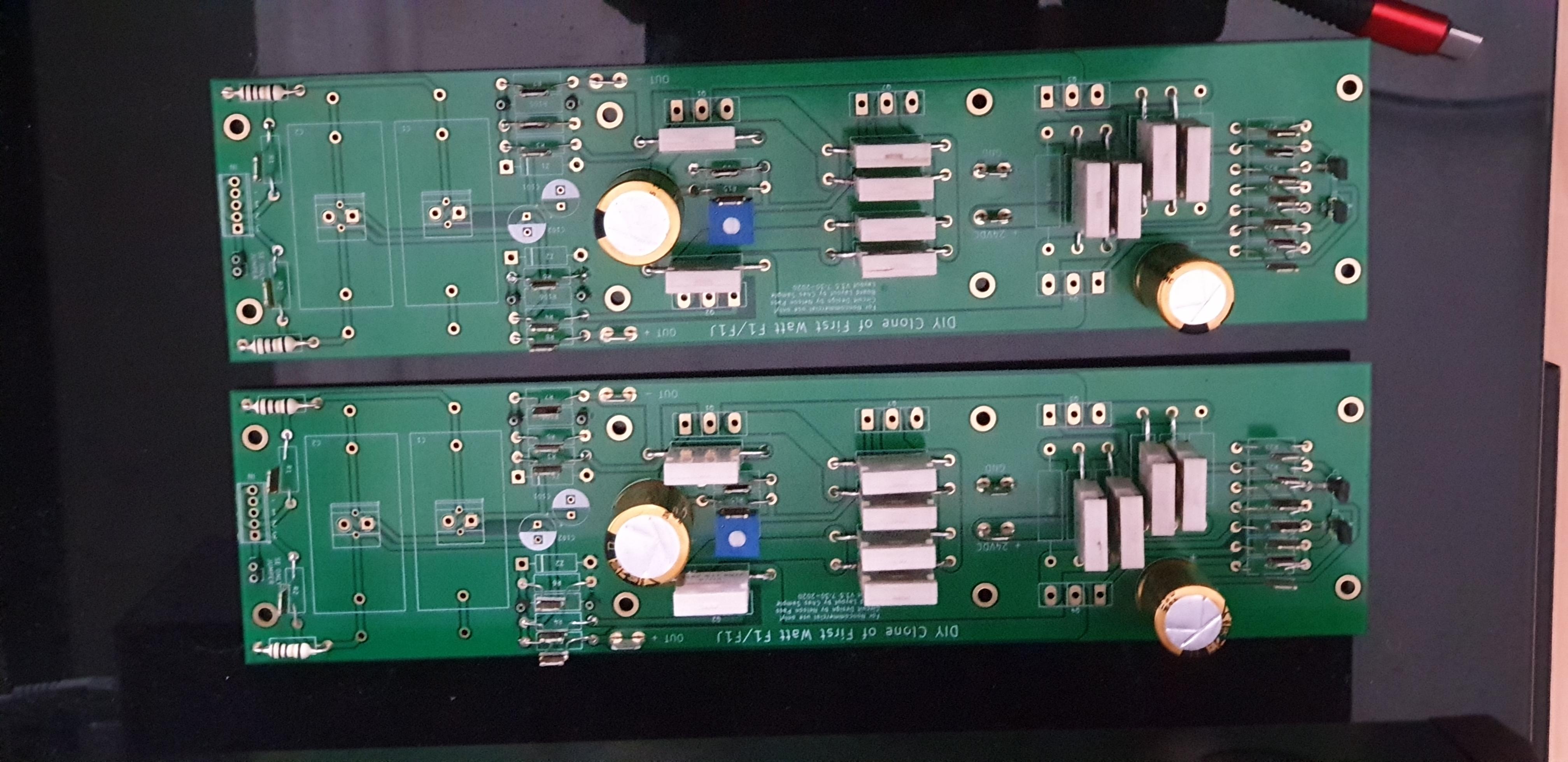

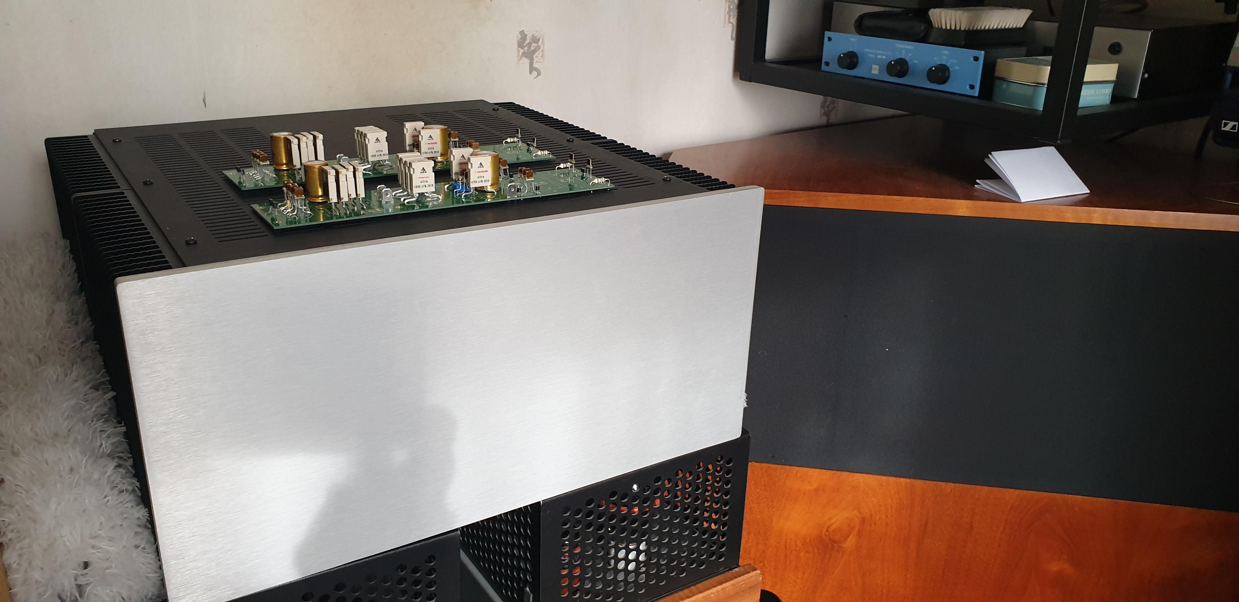

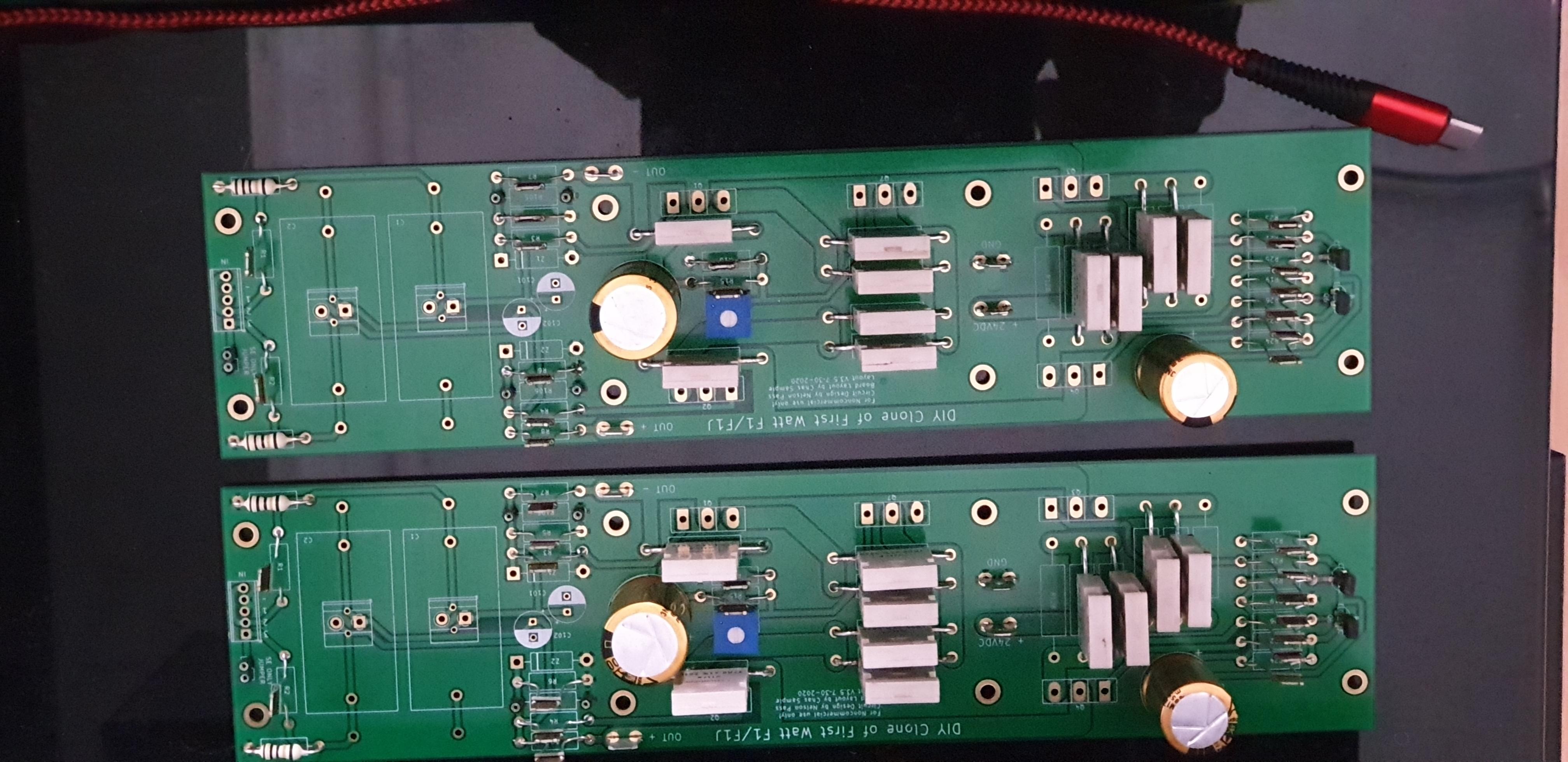

Build so far
Here are a few photos of my boards and the case i shall be using still waiting on some parts from mouser.Hopefully next week can continue the build of this f1j amplifier Again thanks to csample for releasing his version of the board .As well as thanks to Mr Pass for his designs .
