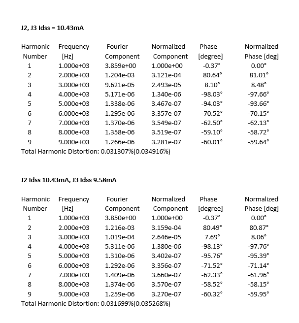

Would LT Spice offer useful insight?
Bear with my ignorance of the software - I don't know how easy/hard it is to define the key criteria - but my thought is that it may reveal this sensitivity. Maybe not. There's always going to be the immeasurable aspect of how it sounds, anyway.
I'd be interested to read Nelson's thoughts on this point.
This is what Spice says.
(The DC offset was re-trimmed with Idss offset, without saying.)
Negative feedback came to the rescue.
I do expect Yfs mismatch to cause more distortion than Idss.
But it's your turn.
Patrick

On the topic of LTP device matching:
In Patrick's analysis the ratio of 2nd to 3rd also deteriorates, but it's still only a couple of dB.
My main concern was current hogging. Let me poke on that a bit with my somewhat limited understanding.
Given that the two halves of each SJ109 are reasonably balanced (and thermally coupled), the worst that can happen is that one SJ109 gets all the CCS current divided between its two halves. That's still well within its normal operating range, so no big deal.
But that begs the question of why have two anyway? Nelson indicated it was to get more front-end bias and more transconductance.
I take this to essentially mean more gain. More LTP current delta for the given input voltage delta, meaning more current and therefore voltage drop over the potentiometer, and therefore more bias at the SemiSouth's gate?
So if one SJ109 is hogging all the current from the other (at equal voltage), then it must also be hogging all the transconductance. In other words, it's giving us the doubled-up transconductance all on its own. So again, we're good.
Is this a reasonable description?
If you believe in Spice, that I have already demonstrated that it makes little or no difference.
For the same Vgs of the Semisouth, doubling the frontend current only reduces the drain resistor value.
So what you gain in Yfs, you lose again there.
That would be my intepretation.
I am sure Nelson has a different one.
Patrick

If you believe in Spice, that I have already demonstrated that it makes little or no difference....
But I assume you ran SPICE with a default (constant) temp, no? So it won't have modelled current hogging (assuming any exists). Or do I have the wrong end of the stick?
Thanks,
Jeff.
