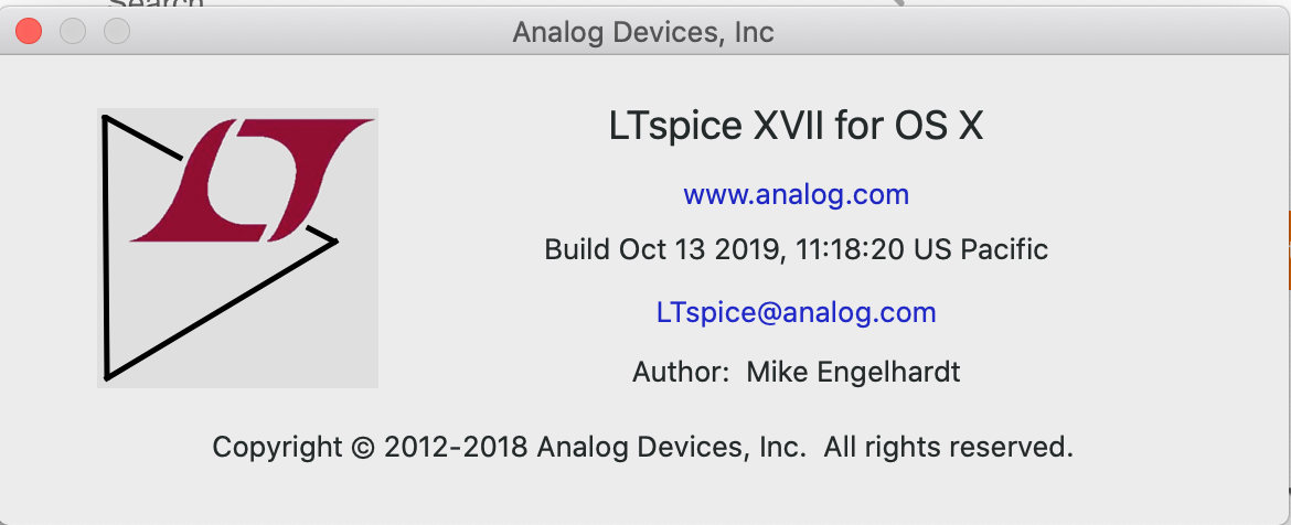

I've been following this thread for the last few weeks and have some boards in hand, but have been unable to read any of Patrick's attached .asc files. I'm using a Mac, and have tried TextEdit and another web app, but I'm not getting any apparent results, just some meaningless lines of text. Any Mac guys have a tip for me? (Aside, of course, from using Windows.)
Not only for Windows, but also for Mac. You can download the LTspice for mac here: LTspice | Design Center | Analog Devices
