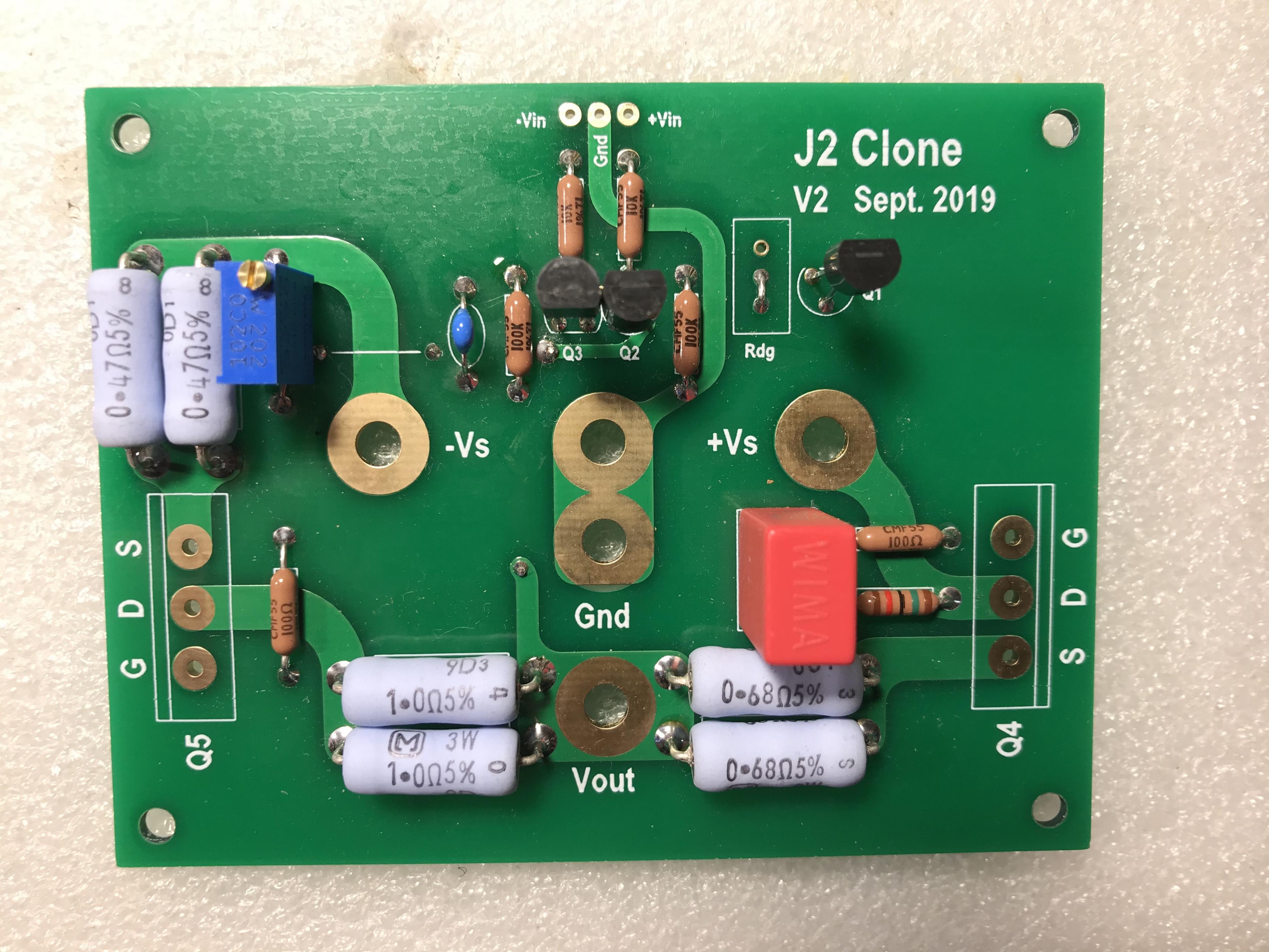

Digging up an old posting. I've got the PCB's from this post and I'm working on schematic values to use with my SemiSouth gift pair from Papa. (Thx again!)
According to ZM's notes/schematics- I should take some values from EVUL's schematic. Of course, each schematic is not identical, so there's some guessing involved for a novice fearless amp builder.
Thanks for the help!
Q-
Resistor values using IRFP240 for Q3. Q4 would be a Semis.
R8 schematic says 0. Jumper?
R10 schematic sys 0. Jumper?
R11- 10K
R15- 0R82
R16-1R2
R17- 0R22
R18- 0R82
R19- 1R
R20- 0R22
ZM notes say change trimpot to 1K. I think this means R6. Or cut trace and use 680R. The trace going to OC1?

0 (or 0R) means jumper
R6 is sole trimpot on pcb
if you have difficulties to grasp how to add 510R in series with 500R trimpot, then change trimpot to 1K
I also appreciate any insight into values used for EVUL pcb v2 09/19. Unsure whether I will use IRFP 240 or 150 and my pair of R120s. Taking my time with this and not rushing as the recent Aleph J build has me content for now.
I was scouring pages to try and find consensus value for Rdg with either fixed value or trimmer.
Have determined BL grade at 6-8 Idss for the upper 170 and lower 2x J74 at GR with Idss 4mA.

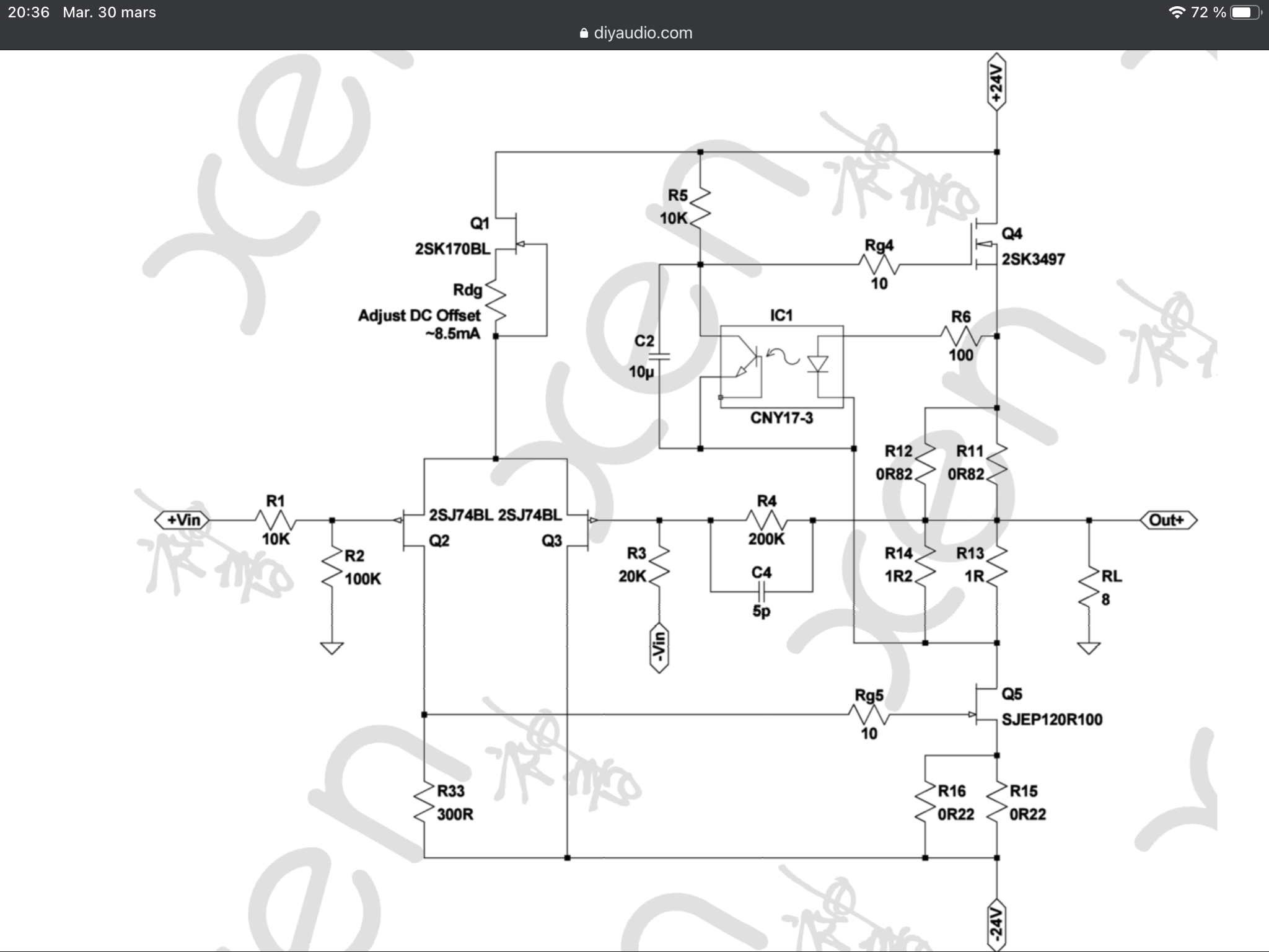

I’m at the same place as you are. I have began a J2 project with evul pcb v2 since I now have a R120 pair 😀
I’ve decided to go with the irfp150 since I want to make a version with irfp150 up and down first. Like Zenmod have done in his Babelfish J2. Just want to be sure that the circuit is behaving properly before putting my precious semisouth into it. I have chose to take the resistors values from Zenmod schematic for the output transistors.
As for the front end, my k170 are 8.5ma idss and the j74 are 9.2ma idss. Evul specify BL grade for the j74. I think rdg is not needed if your front end transistors are properly chosen and if you replace r33 with a trimpot. I’m not sure about the exact idss / idss ratio that is ideal. It would be great if someone more knowledgeable could help with that!

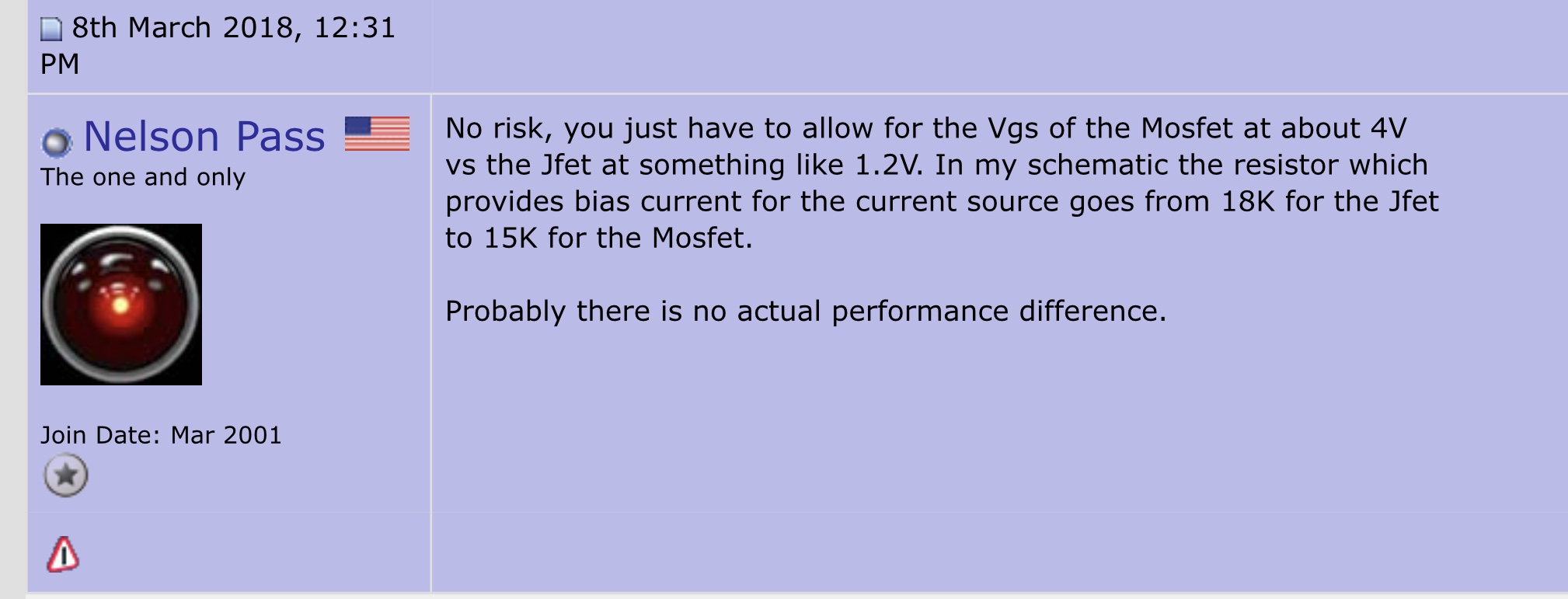

The SJEP has a Vgs of ~1V at bias. The IRFP150 ~4.5V.
Since you are following ZM schematics, I am sure he'll guide you to get round that.
Patrick

The schematics I posted says that you need a Rdg to adjust bias to ~8.5mA.
I guess 6~8mA Idss will not get you that, whatever the value of Rdg ?
Patrick
Hubert

According to Patrick schematic from post 1274 his LTP CCS is 8.5mA:
FirstWatt J2
LTP will be biased by that current.
8.5mA CCS will be split to each input JFET. That is about 4.25mA for two.
Although as I understand J2 means all JFETs are doubled and this schematic cut every part to "J1".
If we back to doubled LTP JFETs (4 pcs of SJ74), 8.5mA CCS will split to about 2.125mA for each input JFET.
Does doubling input JFET pairs help?
I took Patrick ltspice files from post 1253 and 1255 of J2 with 1 input JFET pair and 2 input JFET pairs and unpack all files in the same folder.
Rail is 24V
J2 with 1 pair of input JFETs shows THD of 0.032075% with CCS 8.84 mA
Each LTP JFET dissipates about 100mW.
Then I open a J2 file with 2 input JFET pairs.
For testing purposes to have the same input CCS I cut the second 2SK170 and change R110 to 300 Ohm.
J2 with 2 pairs of input JFETs shows THD of 0.021457% with CCS 8.84 mA
Each LTP JFET dissipates about 49.5mW.
0.010618% THD difference.. but I guess LTP is even more safe and thermally stable that way.
That's just a simulation.

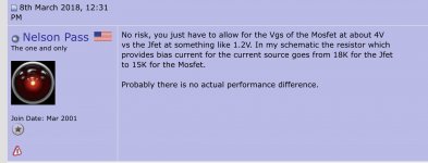

Nelson himself have already answer that question here at post 1130 : FirstWatt J2
My spice simulation seem to confirm that as well.
