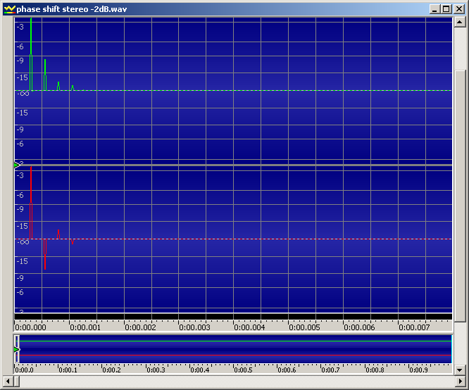

The central voice didn't follow me like before but sounded more like out of phase way off axis. Pano, could you show a picture of the left/right impulse? Importing it as raw in Audacity gave me a view of it, but I have to gamble the settings.

This is what the impulse looks like. It's not clipped, I've just expanded the scale a bit. Still hard to see the very last impulse.
It's a standard wave file. Should not need any special treatment.
Also attached is the file (zipped) with an older style wave header. That might work better for you?

It's in the paper I linked. You can also look at the impulse file.I keep wondering how you can change the center phantom image without changing the R&L channels themselves?
Briefly, it's a very short echo applied to left and right. The left echo is in phase, the right echo alternates phase.
This makes no change in frequency response, it sums to zero. But for 2 ears separated by a head, it does make an audible difference because it eliminates some comb filtering in the midrange.
There is a change to left and right (short echo) but it should be inaudible in either of those two channels. It's when they acoustically combine into the center that there is a difference.
