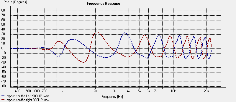

But the phase shuffler is different, apparently getting to the root of the problem. Or at least that's the hope.

I believe so, yes. That is covered to some extent in the paper. My system was fairly controlled and well in phase. Room was treated. The dip was very obvious and somewhat annoying.
I do remember hearing it on other systems, but don't remember enough about what they were like.

I've briefly experimented with using EQ on the mid signal only and it definitely makes a difference. As I am using line arrays, as said before, kings of comb filtering, my results will probably not be representative for other types of speakers.
I'm using DRC processing to EQ the lines and it works wonders on the overall sound. Yet the phantom centre is less defined or tonally different from the sides. I compensated for that by using a longer processing window in DRC for the highest frequencies. But maybe I can loosen up the settings there if I EQ the mid signal separately. My first experiment seemed to work. As said, the phase shuffle seemed to affect the sides too much in my specific case. Collapsing the sound back to the speakers while without it the sound goes way beyond the boundaries of the speaker placement.
Though it did work to make a tonal improvement on the phantom centre.
It seems the higher frequencies are lacking/falling behind (in my case) in the phantom centre. More so with DRC processing than using standard IIR EQ. I'll experiment some more and report back if there is some interest in the results.

the quality of phantom image will be mostly due to good phase response of the speaker. Time alignment of the drivers, time domain, phase alignement, ect
most speaker have some kind of phase problem imo.
I used to think phantom center problems was also due to amplifiers, but ive realized that when a speaker doesnt image perfectly, its often not caused by amps but really with the driver integration.
Also, directivity is probably very important. my amphion are the best at phantom center and is a controlled directivity speaker. pin point imaging in the phantom center is just amazing and natural when done perfectly right without any ''darkness'' of the sound.
Some speaker will also somtime image quite well with good phantom center, but have the tendency to sound thin in the phantom center. this is again due to phasing response.
Id suggest to measure the phase response of the speaker.
''It is easy to get "fooled" by a big image if the phase is off. This usually results in the phantom center being pulled to the sides and creating a "wider" image for the listener. These small delays in phase is causing the insight of the material to be blurry and undefined but "bigger" to the untrained ear. The phase anomalies is usually only measured in a few parts of the spectrum and is therefore only affecting these frequencies. If the phase response shows anomalies in the 200-500hz region you will probably have trouble separating piano , guitars, vocals , snares etc in that area . If one area is affected you can be sure another is affected when moving your head around making it even harder to take decisions when leaning over to your favourite compressor.
To be clear.. The Amphions shows excellent phase response in the entire spectrum and this contributes to the fantastic imaging , the big sweetspot and the stable audio response when moving around my desk. The 3D insight is very clear and separated. It is still very natural because the phantom center is not pushed in the middle like I have heard on many other speakers that has a deep 3d image. Normally a very deep image results in mixing phantom center sources like vocals, kick, snare and bass to loud because this area of the image is pushed back by the speakers and then compensated by the mixer. This is not the case with the Amphions. Despite the very high level of separation and depth the phantom center stays very true to the source. This again reflects back to the accurate phase response. I can not emphasise the importance of this feature strong enough''

the quality of phantom image will be mostly due to good phase behavior of the speaker.
play with phasing. most speaker have some kind of phase problem.
Here's an example of my speaker FR and Phase (grey is generated minimum phase)
![linpas.jpg](https://www.rsr-concepts.com/diyma/linpas.jpg)
(at the listening position, 3m from the speaker)
