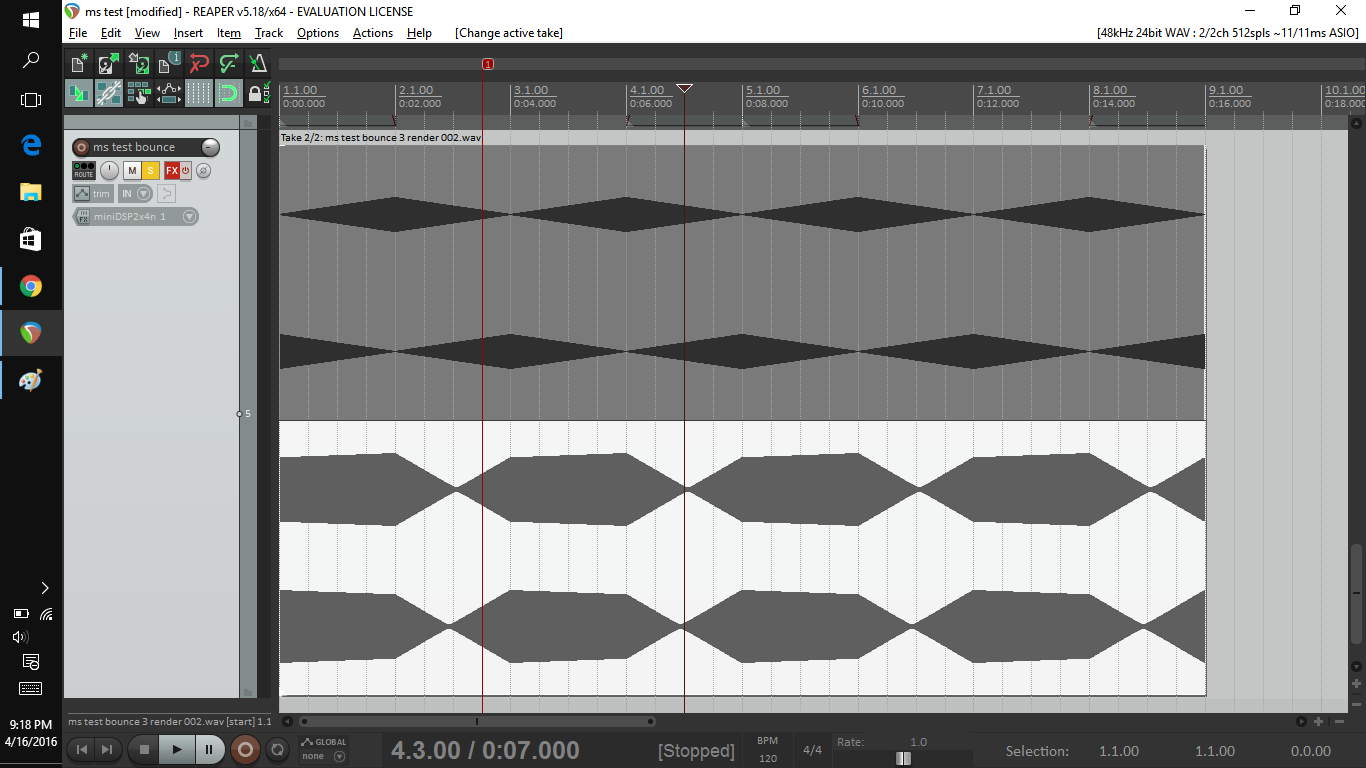

I have been messing around with the Voxengo MSED plugin and some test tones.
The test tone (top track) pans from:
- R(-) to L(+) through side
- L(+) to R(+) through mid
- R(+) to L(-) through side
- L(-) to R(-) through mid
The bottom track is processed through the MS plugin which boosts the side channel by 12dB and attenuates the mid channel by 12dB. A dramatic example.
By looking at the change in slope, you can see how the imaging has become "compressed" or rather, pulled out towards the sides. There are no longer discrete L and R sound sources, but fairly homogeneous variations on the out-of-phase Side channel.
(I'm sure there is a better way to present this information than the dual mono waveforms ... perhaps I will have to get clever with a graphing program.)

Thanks for clarifying with those graphics, wesayso.
That's exactly what I meant by "lossy" - MS processing cannot yield a "pure improvement" since any adjustment involves crossfeed, either normal polarity (add mid) or inverted polarity (add side). Because of this, it will never be a best practice for the stereo record/reproduction system - more of an aesthetic tool, or in terms of correction: a last resort!
Independently EQ'ing the mid or side channel can do strange things to the stereo image too. Stereo is *capable* of reproducing a smooth panorama through:
not-center (L/R inverted polarity) - hard left (L only) - center (L/R same polarity) - hard right (R only) - not-center (L/R inverted polarity)
By independently EQ'ing / processing either mid/side, you "pull apart" the image which creates a hole in between center and L/R. At extreme settings you will end up image that has only two areas - center, and not-center.
As for 5.1 mixes, I wouldn't worry too much about the areas between center and L or center and R. Center is usually quite independent from the L/R mix. But, a good point nonetheless. Depends on how the mix was produced.
Of course it's cool that this technique is yielding a subjective improvement for you, and I've also used it myself to compensate for when my speakers are placed too close together. (but mostly in mixing/mastering) I'd like to read up on that Blumlein and S-curve stuff, but first I'm also going to run some tests along the lines of what you've been doing. Easier for me to understand than theorizing!
For the 5.1 mixes, in the case I described, the left and center will contain an equal amount to present a queue of something in between those two channels. Eq-ing either one separately, left or center will mess up that balance.
If the content is not the same anymore in the left and center, that panned sound between left and right will exhibit the same hole as a mid/side processed stereo file gone wrong.
The biggest difference between my mid and side EQ is less than 3 dB, I'm not worried
